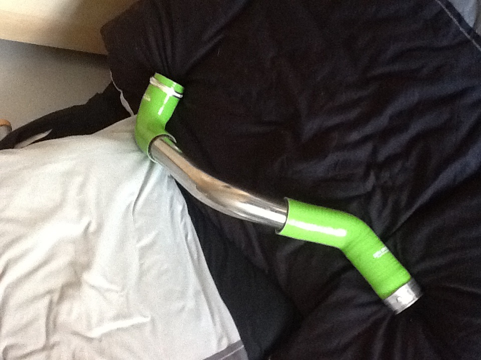

I'm in the middle of trying to make my own up to now it's cost £70 just waiting for 1 last coupler and hopefully it fits okay had my boost pipe off the other day to compare and it's not to far away :)
that looks spot on mate, where did you get all the bits from ?
you just needing a coupler to go on the standard EGR ?, i can do with out this if fitting a delete pipe ?

All the pipe work is from ebay mate the couplers are from forge Motorsport got it all fitted this weekend will get a pic up tomorrow
ASZ
You won't need a coupler then if you have an EGR delete :)
spot on, don't suppose you could pm me links to each could you if you get 5 minutes please ???, (the exact ones you bought then i know its right )
thanks alot :)
Yeah mate will get it all sorted for you tomorrow, it's not as simple as it actually looks as I found out yesterday with having to cut each bend about an inch off each pipe to get it all to actually fit, but as for the stainless steel it fits sweet and sits about an inch and a half off the aux belt which I thought was going to be a bit of nightmare thinking it would be close but it's actually not bad
