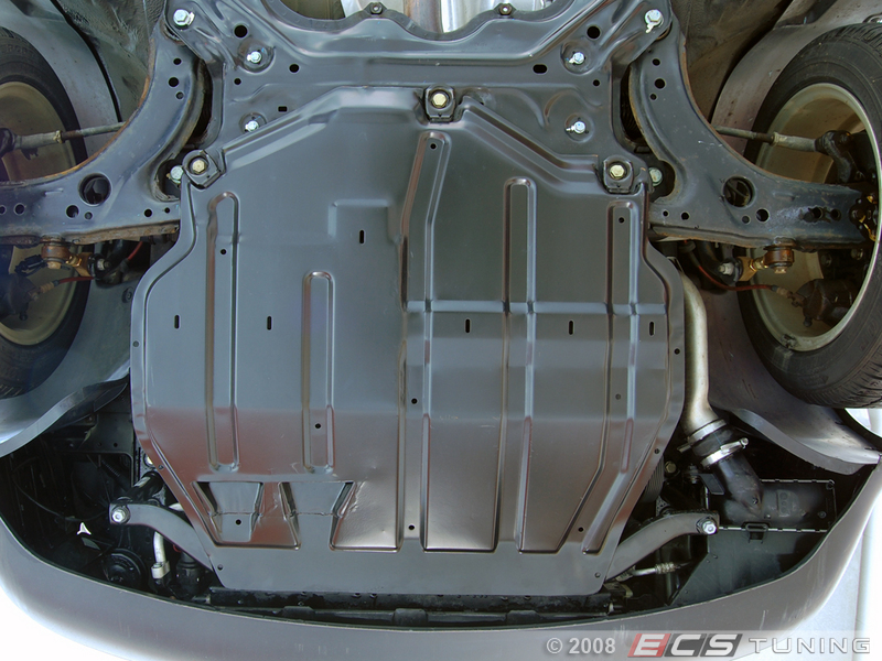

I know your pain! Similar thing happened to my daugther VW Jetta Mk4 and she crack the automatic transmision belly pan and was leaking oil.
My 2002 Octavia comes with a heavy duty package that include a metal undertray intead of plastic. That metal undertray have save me several times from destroying my engine sump :whew:
Since the VW Jetta MK4 is the same as the Skoda Octavia, I order this metal undertray and instaled it on the Jetta to prevent future problems. I have check under the Jetta and already has seen some scrapes meaning that thing has save me a lot of problems.
Is a piece of cake to install it. If you are interested in order one, make a search on the net for: Jetta Steel Skid Plate or MK4 golf skid plate. I know Skoda dealers sell it. I pay for mine around U$ 400.oo and belive me, this thing worth every penny!
Good Luck,
Isaac
Edited by Turbo_Boss
That certainly looks like decent bit of kit. These cars are so low to the ground they are very vulnerable.
