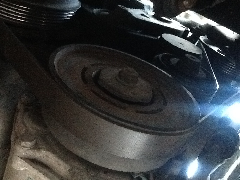

Hi I've been trying to fault find all day with my ac I've regassed the system and it didn't work now after reading other threads I have come to realise that something is not engaging on the compressor and I believe it to be the clutch , now there is a small disk in the middle of the compressor and that spins freely , but I'm not sure if there is something missing , also even if there is something missing surly the electromagnet should still engage ?? And I've connected 12v straight up to the 2 pin connector at the bottom of the compressor and still no movement , could someone take a look at the picture and tell me if there is more missing , because there appears to be a circular ring where something looks like it used to rub and I can't see what is supposed to be rubbing it ??? Please help

Your clutch has gone awol
It looks like the nut is intact but the clutch plate itself has removed itself from your vehicle if i am correct.
Yep. Can get a new clutch for it and shim it up.

Undo the centre nut from the remains of the clutch and prise it off the splines, inspect the condition of the splines, mine disintegrated and I replaced the whole unit.
