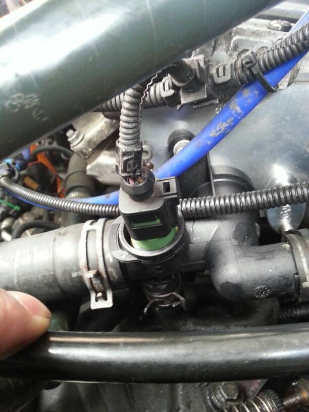

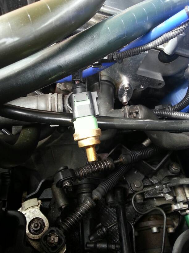

Righto, over the weekend I replaced the Coolant Temp Sensor - this has solved the coolant gauge strangeness.
