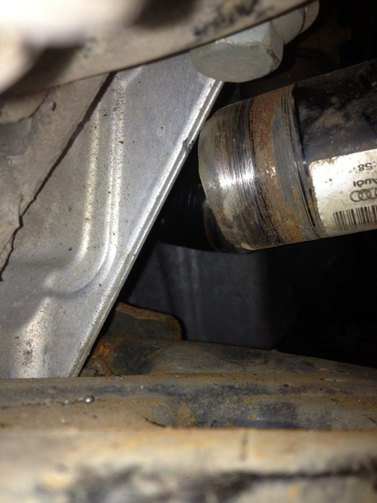

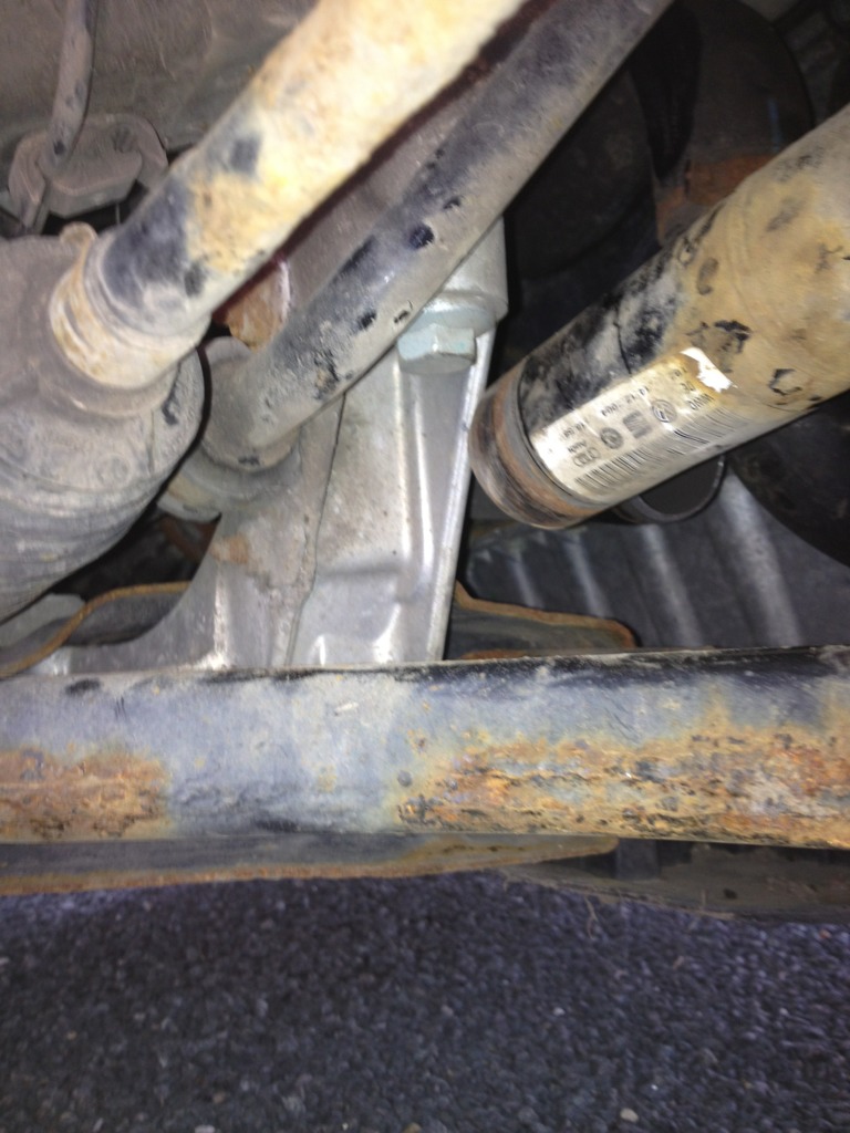

Hi, I have a skoda fabia 1.9 tdi 05 plate. I was pulling out of a t junction when my driver side drive shaft snapped on me, coming from the right wheel it has snapped clean, but it looks as though it has been weakening over a long period of time, like rounded at both edges of the snap. Could this be to do with bad tracking ( going to the left)?
Also, does anywhere sell a solid drive shaft or a stronger one than what comes with the fabia?
I will upload pictures later if it helps but on my phone at the moment.

Went to the garage at the end of my road, he's been a mechanic for 30-40years and said he hasn't seen anything like that before, said they usually snap at the cv joints. Has any body seen this happen or had it happen to them before?

It has failed at the friction weld, maybe due to age/poor materials etc. just fit another and forget about it that shaft handles more torque in more powerful cars than just the 105bhp fabia.
