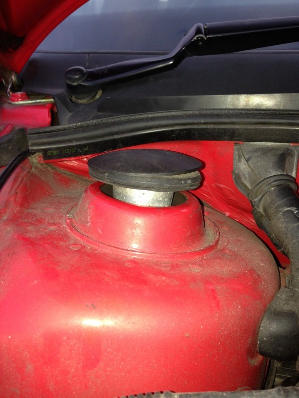

As described in my post? Does this look the problem of my loud clunking when braking hard on bumps and accelerating???
does this look right? because the loud clunking is getting even worst?
That doesn't look too healthy. New top mount I reckon.
