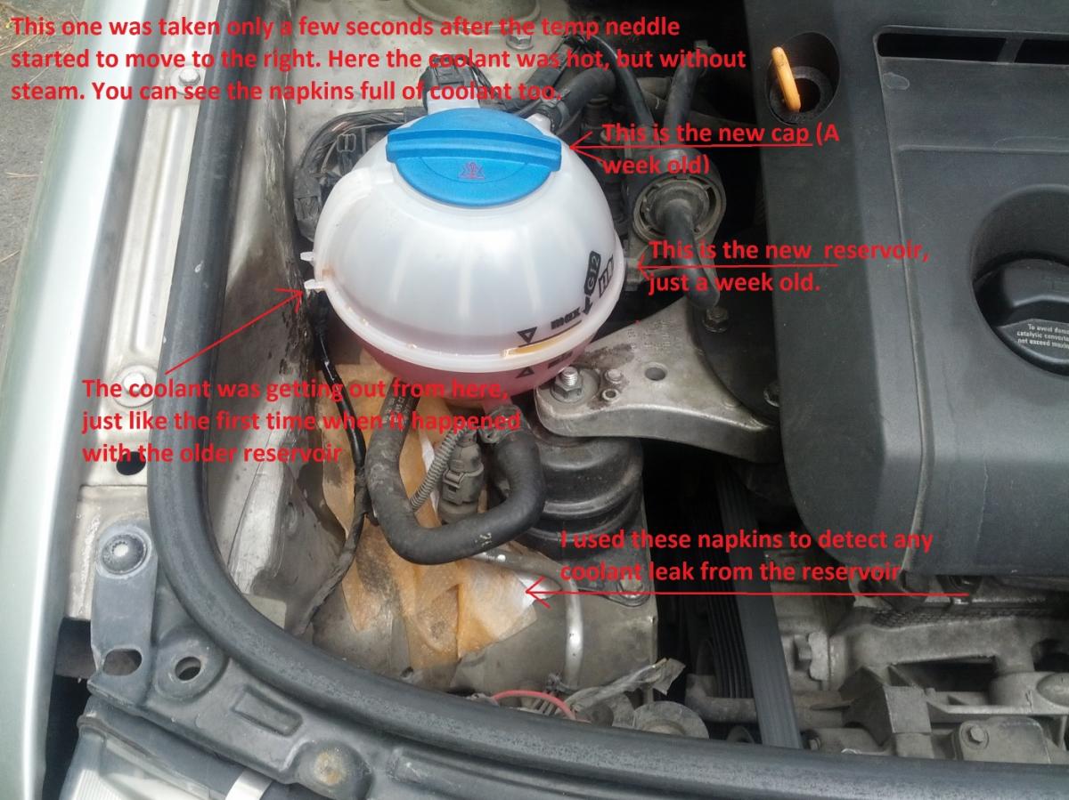

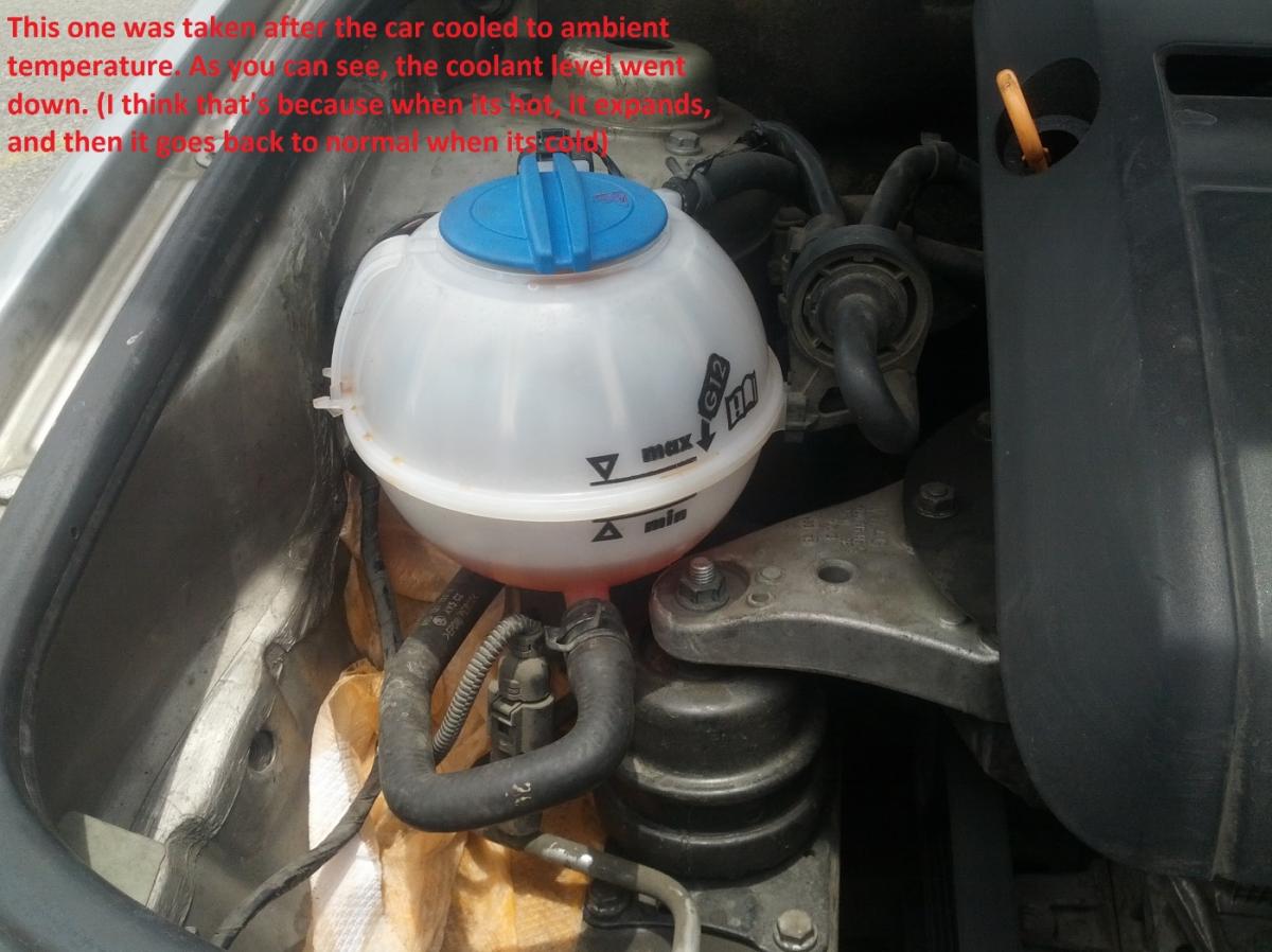

After those parts where changed i made a test drive into that hill again. (I need to drive 100km to get to the begining of the uphill). When i arrived at the beginning of the uphill, i pulled over and checked the coolant level. It was in the middle. The oil was ok too. i put a few napkins under the coolant reservoir, to detect any single drop of coolant. Then, i started to go into the uphill again. This time, i was able to go a loooot farther than before. 13km instead of 7. but, it happened again. As soon as the neddle started to move to the right, i turned the engine off and waited. I took a picture of the reservoir at that time. The napkins where full of coolant. and the coolant was above the "Max" mark. But, when the coolant and the engine cooled down to ambient temperature, it descended below the "Min" mark. I added more coolant, and went downhill normally.

The system is over-pressurising so the coolant is passing through the cap and down the side.
I would get a block test done to see if there are exhaust gases in the coolant. My guess is that a crack in the head gasket (or block/head) is opening up at sustained high load.

Yes. I've seen cars that will do hundreds of miles whilst loosing almost none. Give the engine some real work to do and it can lose all the coolant in minutes.
I would...
Check the water pump - raise the engine rpm to about 2500rpm and check the coolant return flow to the reservoir - you should see a steady stream into the reservoir from the small pipe on the side.
Check that the radiator gets hot and the cooling fans work.
Do a pressure test
Do a block test
