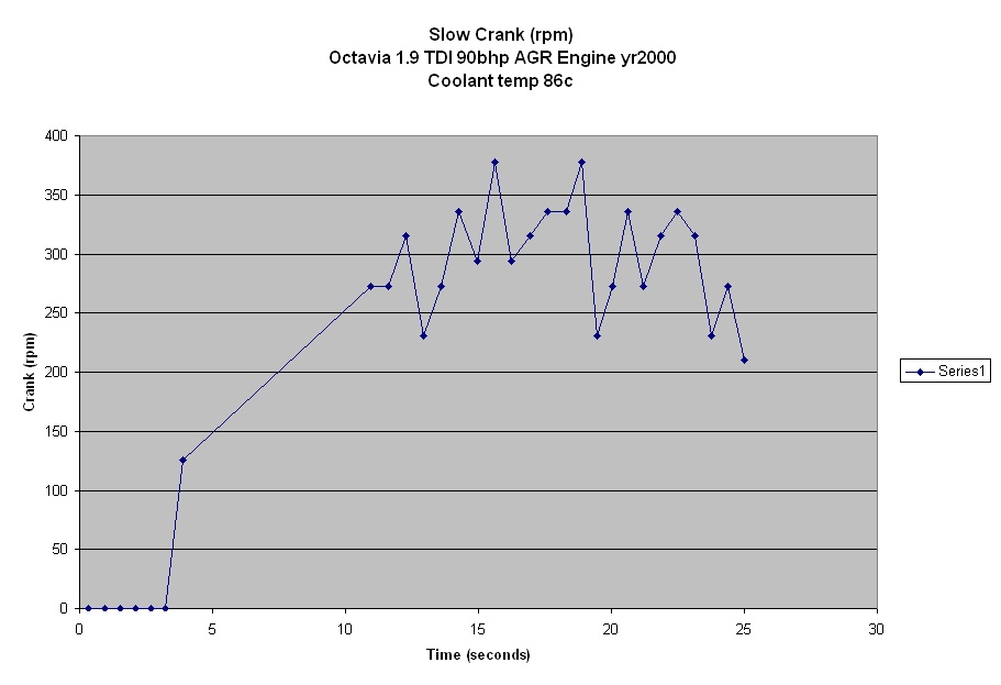

I have now measured the crank speed using VCDS.
It sits above 250 rpm.As you can see the engine does start. The engine wasnt fully warmed but not cold. The measured temperature was 63c.
I am going to try it again with the car fully warmed. It does tend to be more difficult to start when been on a longer journey.
It takes almost 6 seconds to start.
The smell of unburnt fuel is overpowering.
What else can I look at with VCDS to help me.
Cranking looks fine then. You really need to get the engine up to normal operating temperature(88C ish) & then look at the temp the ECU is getting from the CTS.

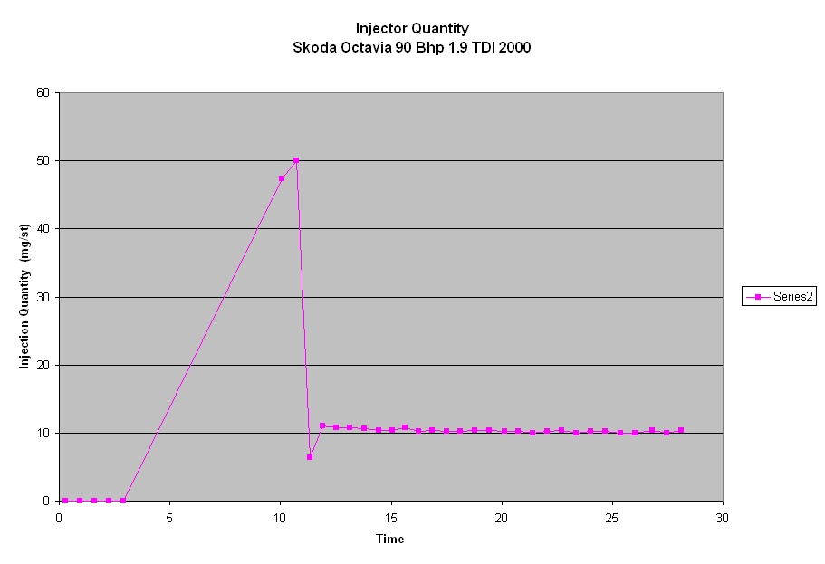

Have also looked at the Injection Quatities. There is a massive spike before it starts is this normal.
After a bit of research The IQ value should be anywhere between 1 and 3. I have 10.1. The higher this value the lower the amount of fuel. I should therefore have very little fuel being injected.
I am not sure if I trust this ready. Some sort of sensor must be broken.

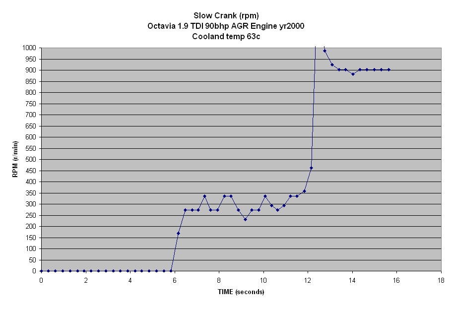

Have checked the crank speed with the engine warm.Crank speed is better.So I can rule out the starter motor.
