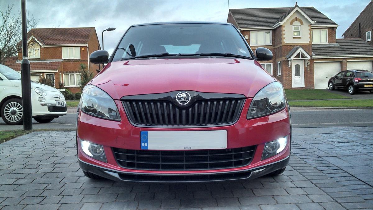

Here's a picture of mine this morning.
They're multi SMD type LEDs, they're barrel shaped with about 50 SMDs attached and look so much like OEM LED DRLs when on and give off a slightly blue white light.
Looks like they use the reflector nicely too!! unlike some of the Cree ones, though there are now some Cree ones that have LED's on the side too, but they are 3 times the price of these!!
