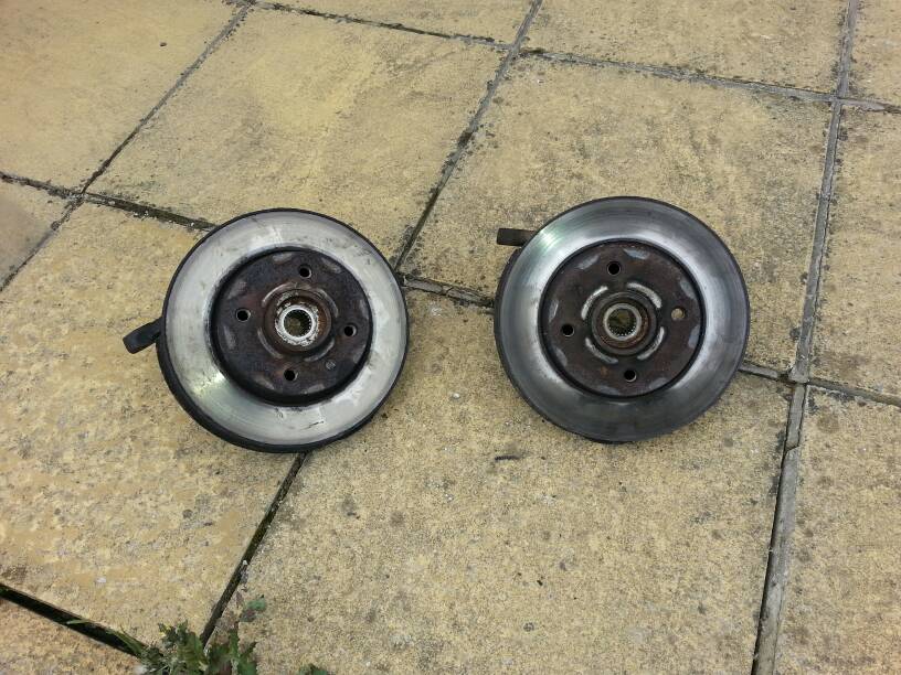

Funnily enough I had exactly the same problem the other week. Thankfully I had a donor Felicia on the drive so was able to swap parts over. I decided to change the lower swivel hub, so I would advise getting a Haynes manual to begin with. Its section 10-2. You need to remove the brake calipers and then undo the bolt that holds the assembly on to the lower strut, then the lower bolt and also remove the ball joint. You will need a ball joint removal tool. It took me a good couple of hours as the bolts are seized and rusted in to place.
I am by no means a mechanical expert, but a good level of competence and knowledge is required. Haynes manual is invaluable. I'll add a picture of the bit you need to remove in a bit.
This is what I swapped over

Thanks for the repsonse, but that looks like the complete upright unbolted from the strut? I was hoping just to replace the actual hub...ie the bit just behind the brake disc that the wheel bolts to.
