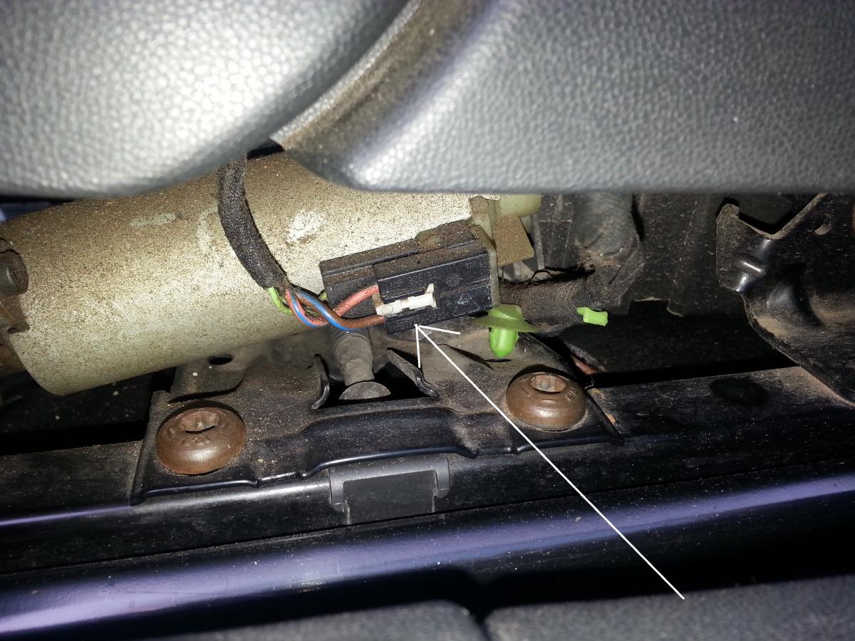

Hi Adamal,
I just took picture from the right side of my car seat, and tried to capture the picture of the switch, is it the same switch which we are talking about...
Pls. note the arrow where I am trying to point.
Regards,
Kamal
No. I am talking about the switch on top of the plastic frame that supports the seat... Its the one you use to store the position to one of three settings etc
