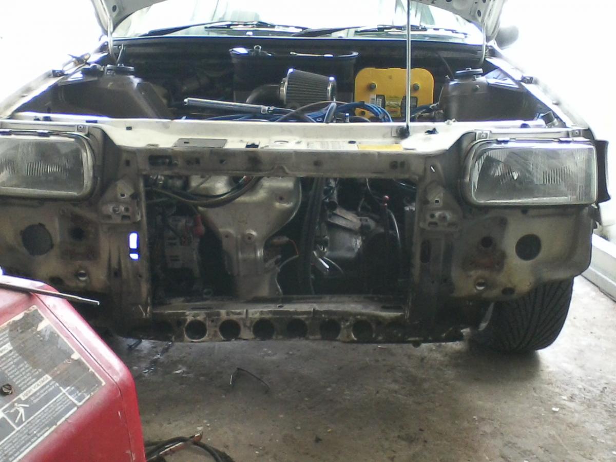

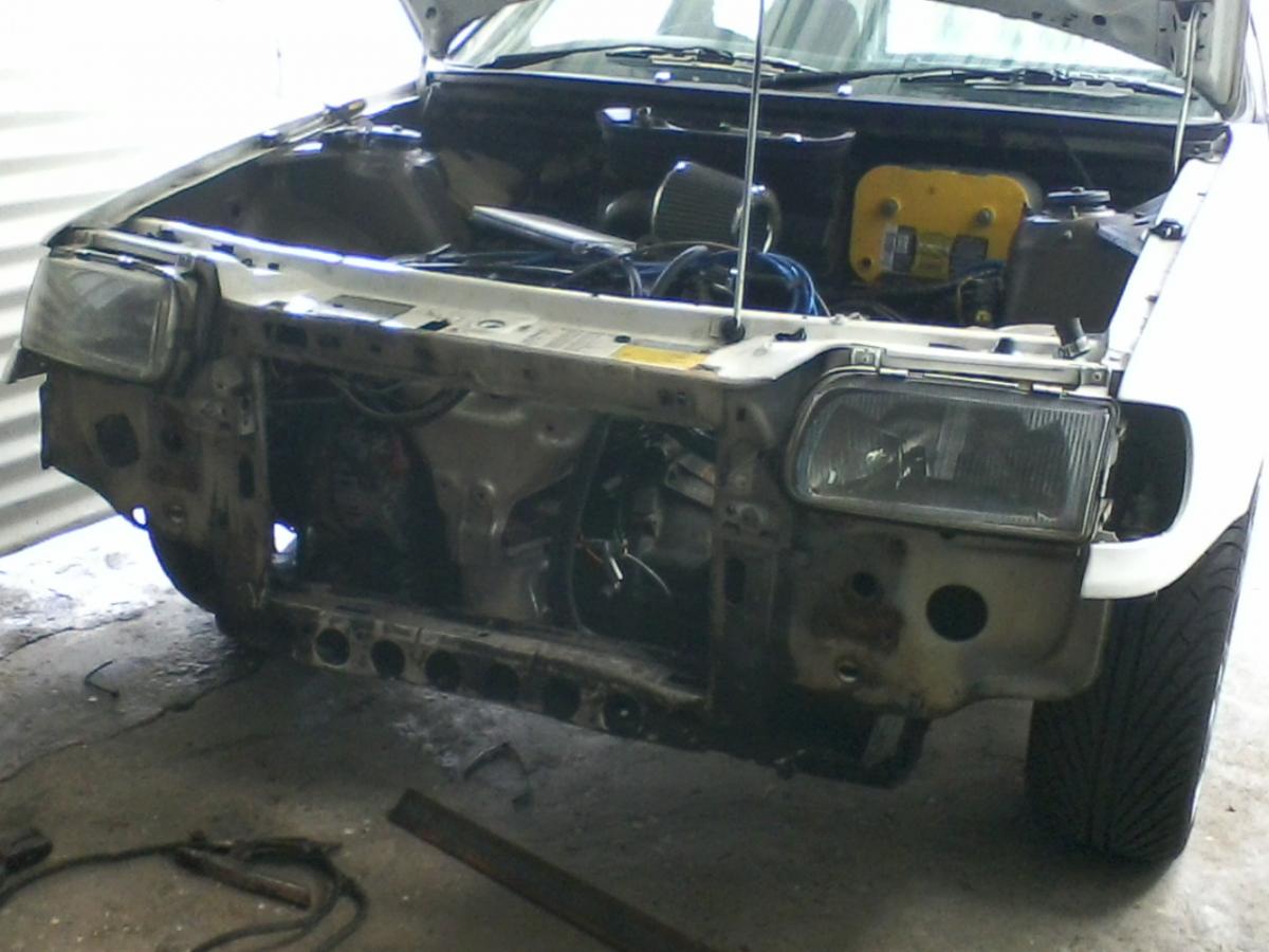

These pics were taken from a phone..sorry about that. This is what the front of the engine bay looked like before the cross-bar was removed and replaced with a stronger length of steel which was also fabricated take the custom aluminium radiator.

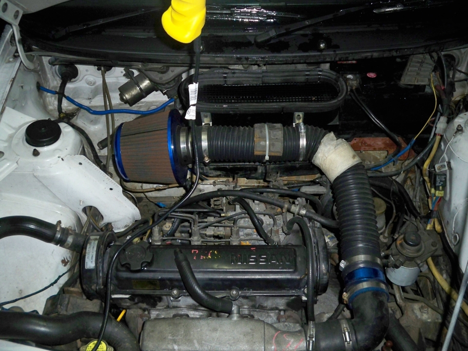

So with the engine bay in a much better condition, my brother, my dad and I dropped this engine in. Its a nissan GA15DE petrol engine. We didn't have to do much modifications to the engine mounts cause the CD17 and the GA15 mounts line up almost the same way. The rear engine mount needed to shift just a tiny bit though.
New engine in
Side view of the new engine

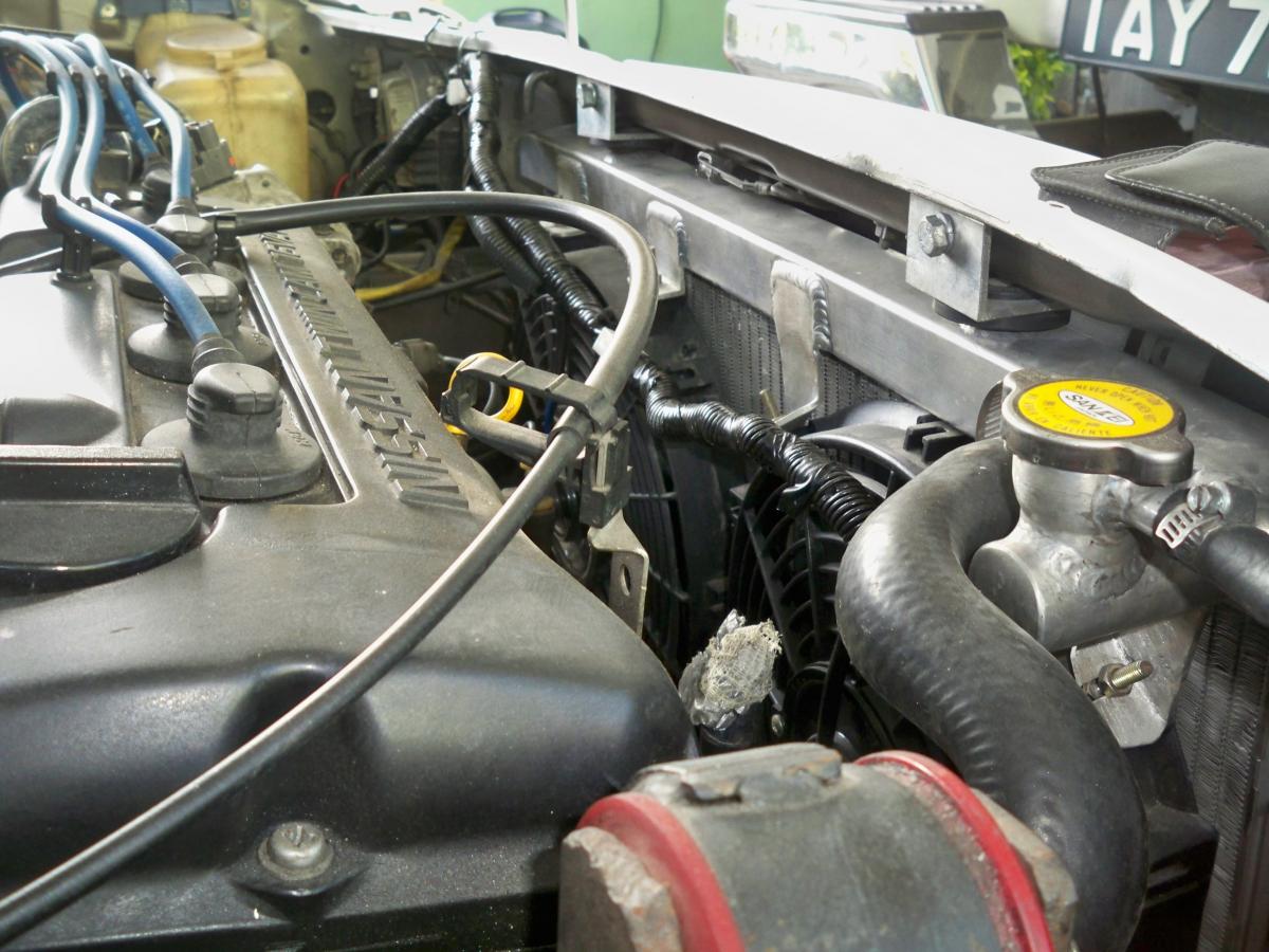

Bought a used B13 radiator and decided to take out the plastic tanks from the core and had them rebuilt out of aluminium. Cause those plastic tanks crack after a while and usually you either find yourself purchasing a new one or replacing the tanks out of metal. In order to accommodate the radiator, I had to cut out the crossbar in the front and replace it with a 90 degree angle iron, and welded 2 rings (and placed circular rubbers with holes in them) so the studs of the radiator can fit snug at the base, and welded 2 nuts at the top so that 2 10mm bolts with aluminium L brackets and grummets in them, can hold the radiator in place at the top. Will take a pic of the rad soon to show what I was typing about.

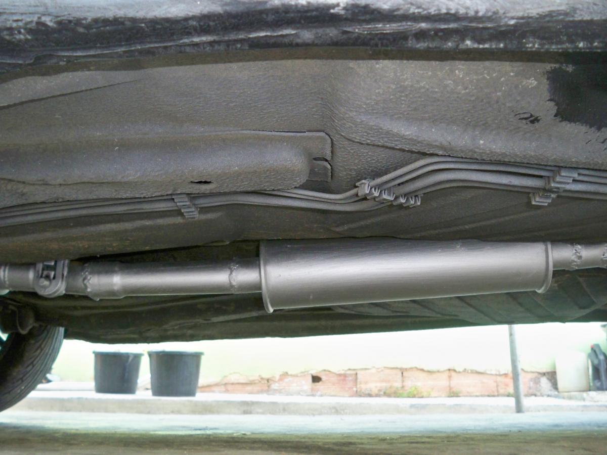

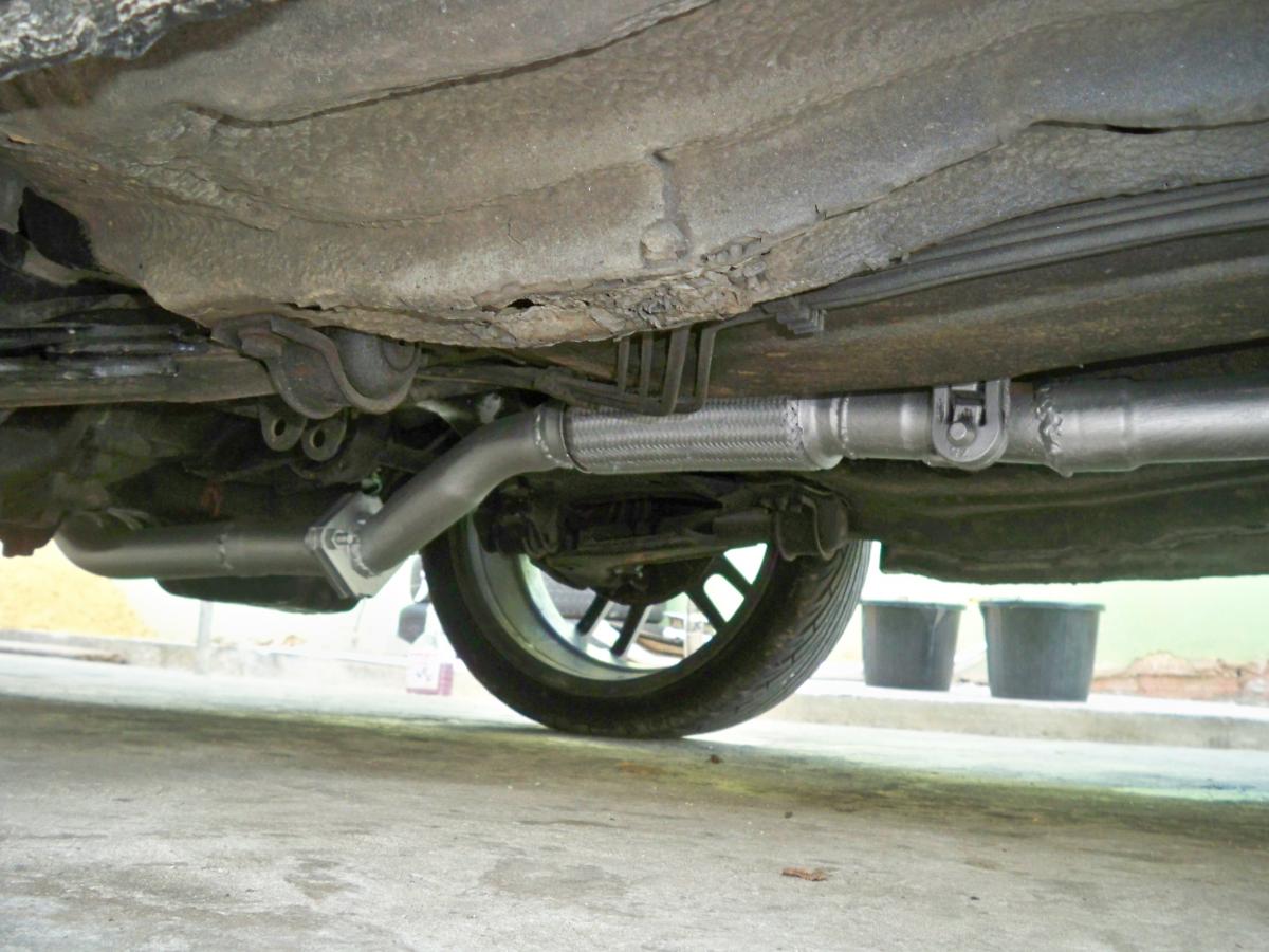

Yes it is much faster with engine. Well I haven't hooked up the speedometer cable yet so I can't tell you exactly how much faster it is but there is a difference. The diesel engine was alot heavier than the gas engine. When the diesel engine was in, I found myself changing the front shock absorbers very often. I also had the piping for the exhaust system re-done last week. The previous owner had used about 3 different sizes of exhaust piping on the entire system. I didn't like that so from where the piping of the engine manifold stopped.......all the way to the new muffler barrel.......I had it replaced with one size (2") piping.

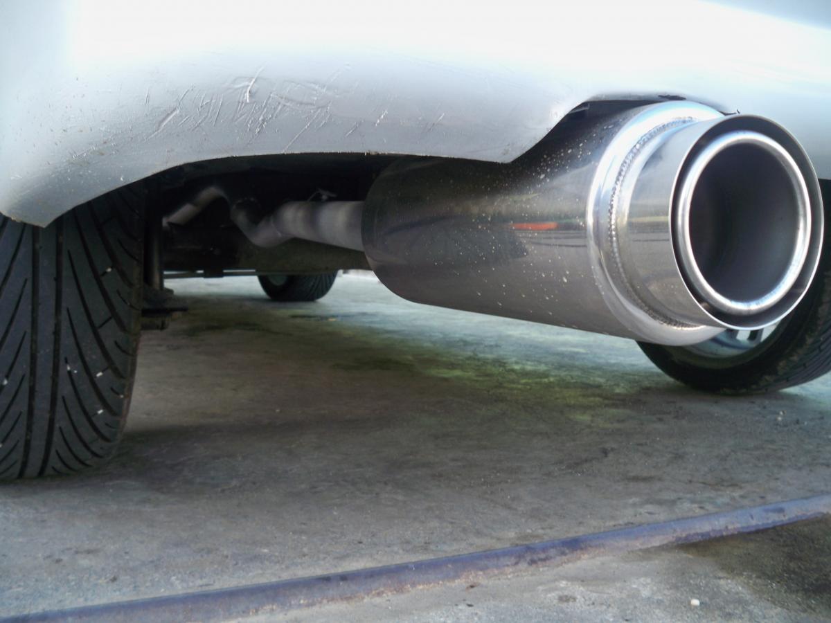

Haven't updated for a while. The pics below are of the work I had done on the exhaust. Not the best work I know.......but hey...its functional.

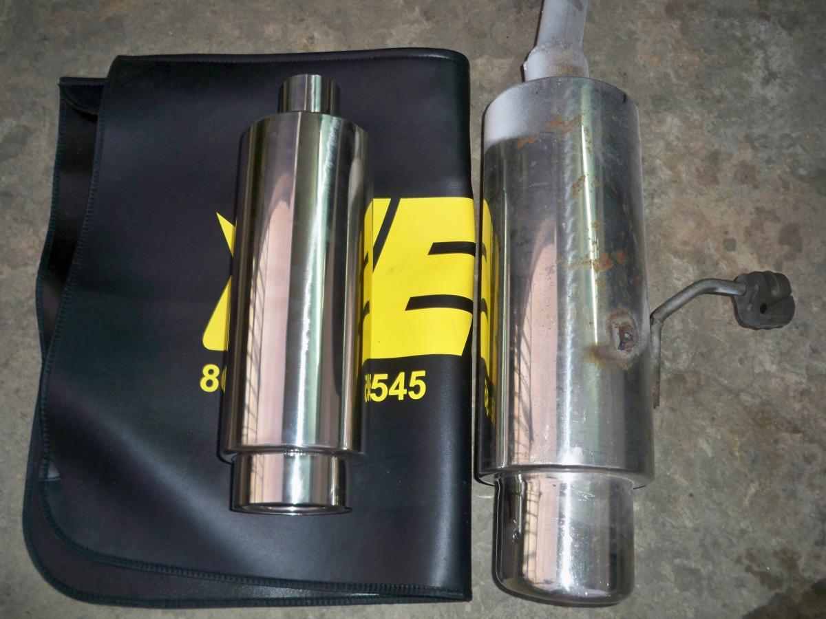

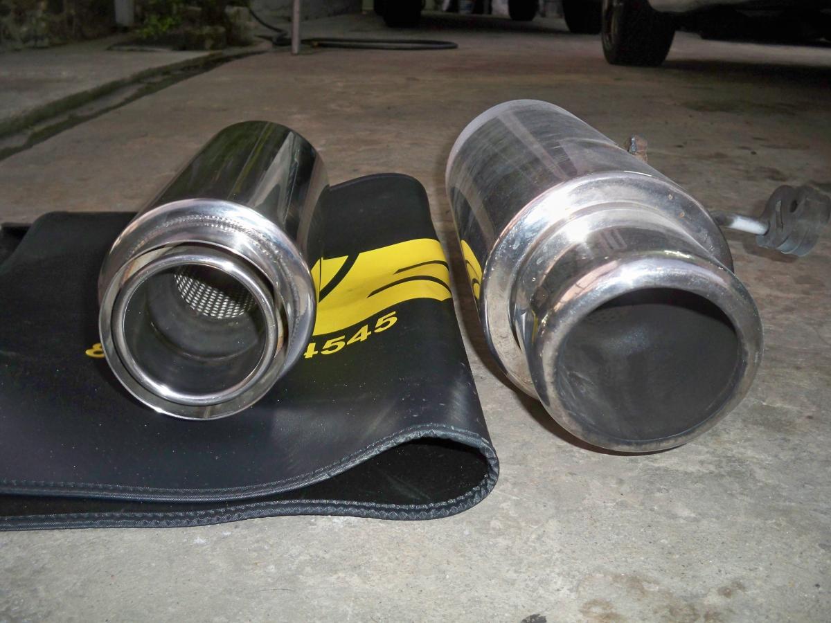

The barrel on the left is the new barrel I had installed about 2 months ago and the one on the right was the old one I had removed. It was completely shelled out on the inside and had bits n pieces of rust knocking about inside the barrel. The old barrel as you can see was bigger and did not have a silencer. Needed changing so I decided to go with something smaller and less noisy.
Also had a resonator put in to aid with the noise level.
Just a little pic of how my custom aluminium radiator holds.

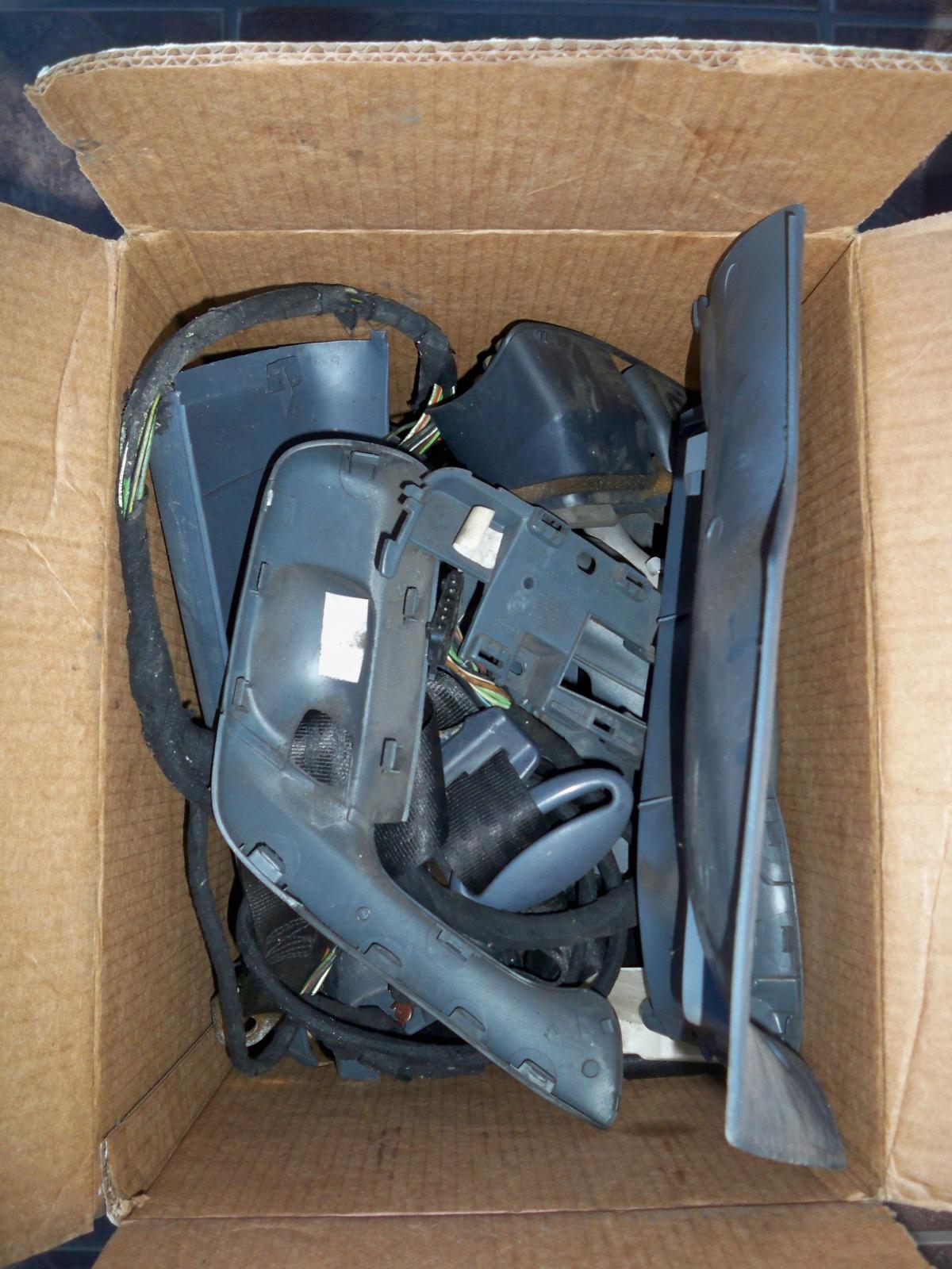

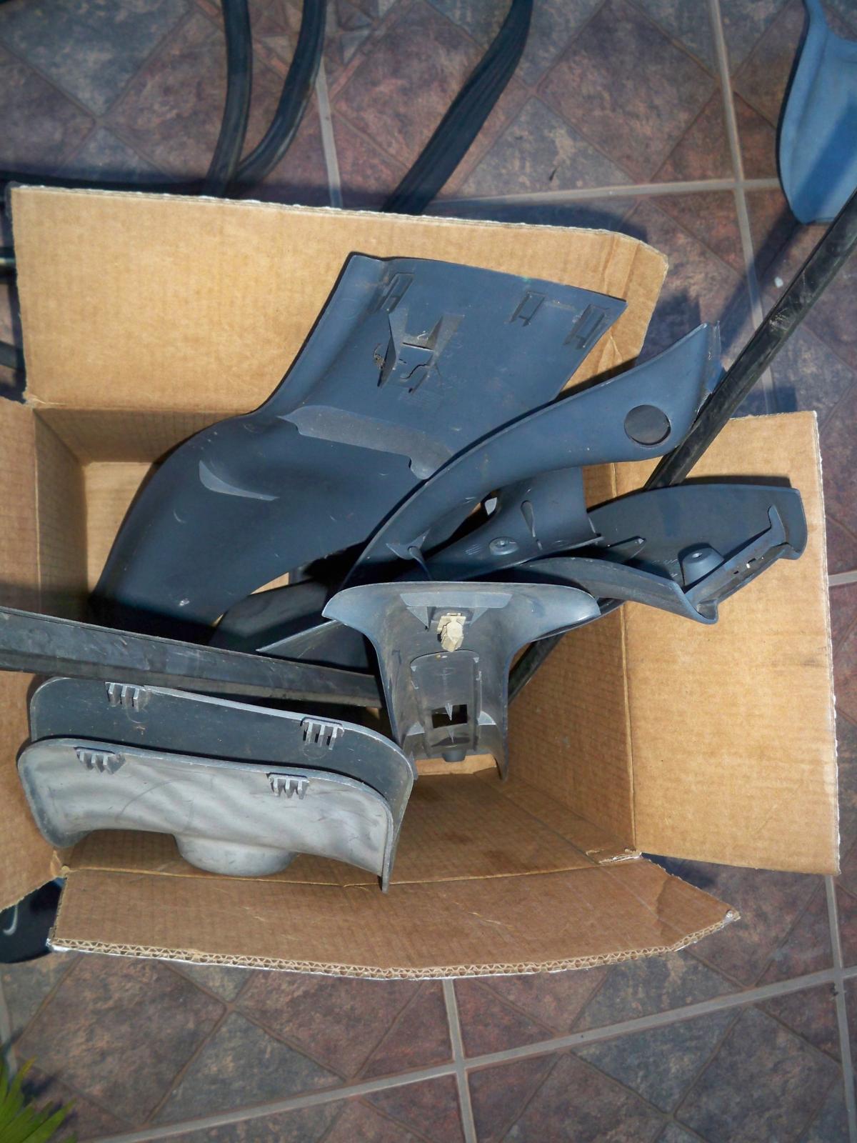

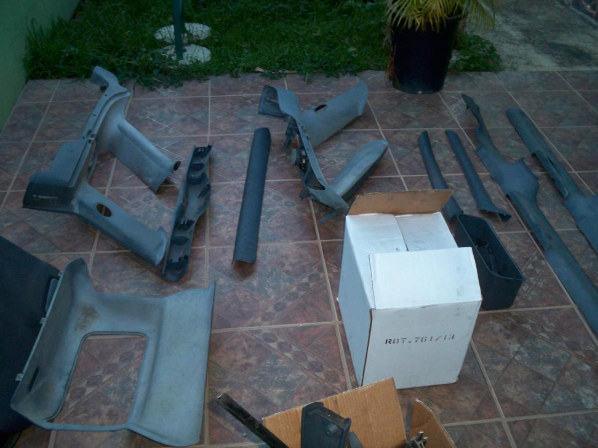

Plus I hit the jackpot with interior parts nearly two months ago too. Found a felicia and a felicia estate of the same year they were parting out in a Junk Yard. So I took the best of the lot between the two...for my car. After all the both carry the same parts from the front all the way up to the backseat.
