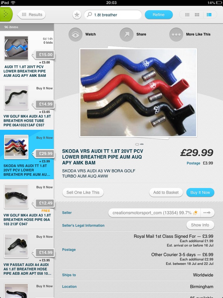

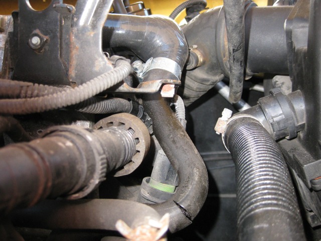

Hey guys can anyone tell me if this is the correct hose to replace this burst pipe? Changed one above a few month ago and now this one has gone :-(
Certainly is matey
Thank a lot pal. Just at £30 better make sure ;-)

Is this a nightmare to fit? Looks pretty tight at the bottom :(

Best changing all 3 and the plastic 90 degree bend aswell if one goes others arnt far behind
Should receive my hose today but after having a look this morning it looks really tight to get into :-( is there any tips to changing this without freaking out and launching it over next doors garden? ;-0
Do I need to remove battery?
If u take the plastic cover off around the dipstick its alot easier
Got that off but still looks tight. Might take battery out and give myself more room. Thank you
Colin
The 90 degree plastic elbow by the filter housing is held by a horseshoe shape clip, pull it out, take out the elbow with the pipes and work on it away from the car, much easier when you can see what you are doing.
It is also easier if you swing the plate that holds the dipstick tube and boost valves out of the way, don't panic if dipstick tube breaks, they are quite cheap to buy new from dealer/ebay.
