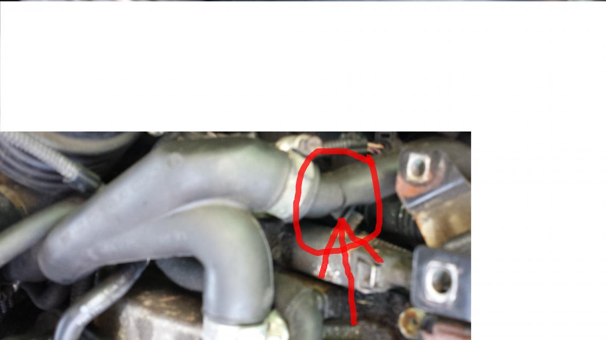

anyone know what this pipe is called as i think its my surging reason ive currently taped it up for now
its the pcv pipe (goes to the y pipe) thats part of the breather system, either buy new original, or a silicone replacement (look on ebay they are better imo as last longer than the original items) and you can get the upper y pipe as part of a set to match as those are worth changing too as the rubber breaks down with time.
