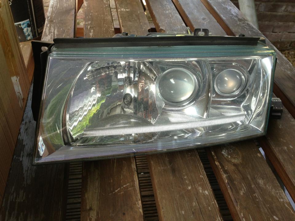

ive just brought myself some oem xenons  they look mint cant wait to have them fitted :)
however it appears i need the plug for them to convert to my standard vrs headlight loom  either via soilder and heatshrink or change the loom

You can use kufatec looms mate. They are about £60 iirc. Its a big job to do the full conversion. To be legal/pass mot you need self leveling system and headlight washers. Hope this helps mate
Nice one buddy I will be doing the full conversion in stages I have a good mot bloke :)

I did this conversion on mine. The plugs on the headlamps can be unclipped and swapped over, so rather than modify the wiring on the car, or buying the Kufatec looms, I modified the wiring harness from inside the halogen lamp to suit the xenons.
You need to be aware that the halogen leveling motor is different to the xenon version in both fitting and wiring too. The halogen has three wires and the xenon four.
