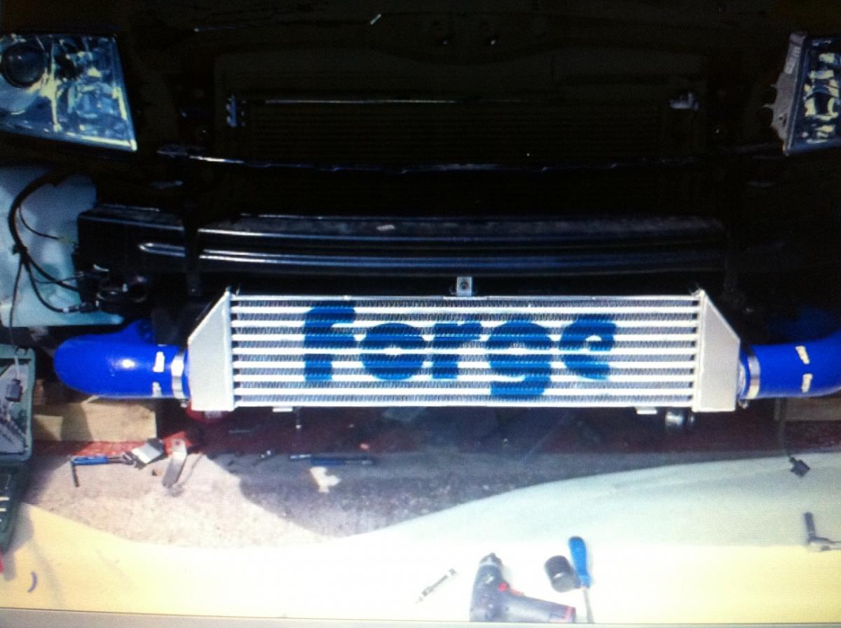

I ran a forge twincooler on my vrs 2.0tfsi running stage 2+ because I was having big heat soak issues, after it was fitted we took some intake temp readings and it was like night and day, the difference was very good it ran cooler intake temps all the time, I know fitting a different cooler (forge or THS) doesn't increase power but it does stop you loosing power through heat soak, The THS is a good product but its very heavy compared with the standard one or S3
If I had to do it again I would not hesitate to go down the forge route again just because I know it works well, I think the reason behind this is because it sits right at the front low down with nothing in front of it. Phil

Well I've ordered a Twintercooler from awesome. Will fit it as soon as it arrives!
