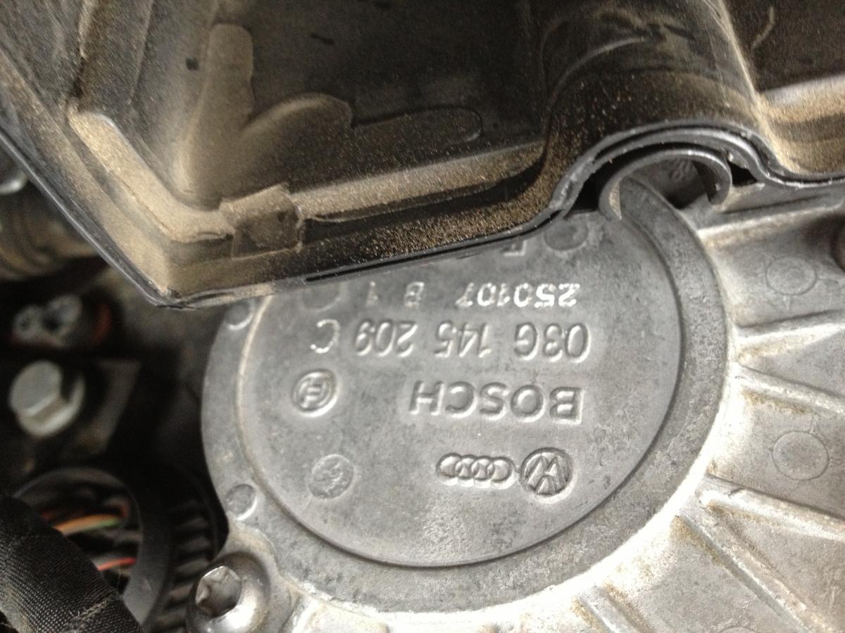

It seems to be coming from the right hand side of the engine near the battery, possibly from Bosch part 036 145 209 C.

That is the vacuum pump by the looks of it. Could be that yours is on the way out if it is noisy.
Easy to confirm as there will be a vacuum line from that to the controlling block up by the scuttle cover (can't miss it as it has, from memory of my BKD A3 about six vacuum line connected to it).
You need to get a stethoscope or the old trick of using a long screwdriver to see if that is definitely where it is coming from.
Might be time to change it.
That's the tandem pump, a combined vacuum pump and fuel pump in one. Only PD engines have them.
It may be that which is making a knocking noise, but I would have expected you would have some quite severe starting and running problems if the tandem pump was failing to that extent.

Once the engine is running its sounds like something it catching on something and causing an unnatural noise from the right hand side of the engine near the battery. It's either in the part photographed above or something connected / associated with it but inside the engine.
