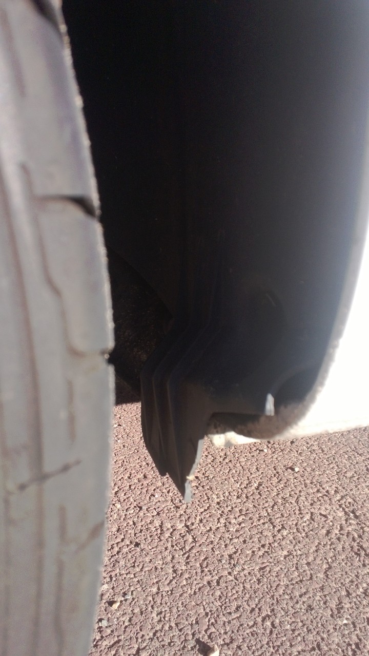

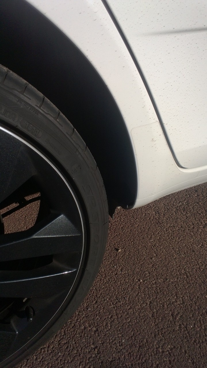

Can much be done to repair this?
I have no idea what you call them, but its located near the back passenger door drivers side. Not even sure how/when it happened. Anybody have any ideas? Cheers muchly!  :blush:
Do you mean the broken liner?
You would be needing a new/replacement wheel arch liner.
Or you would need to do some patch up job.
Is it recent or just that you recently noticed it?
Maybe someone was hashy going into do some work. Trolley jack broke it off.
Maybe something hit it from the road, or Winter time someone was kicking off a build of of frozen slush.
Lots of maybes.
george
Hi wazzag this is what it should look like so yoIMG_3509_zps9925a45b.jpgur going to need a new one mate .. good luck.
Thanks you both for the reply's. Only noticed it the other day but to be honest it could of been like that for months and i probably wouldn't have noticed it! So looks like the whole liner. How easy are they to replace?
wheel of, undo about 7 or 8 screws old liner of and new one on screws back on and wheel back on ........SIMPLES
Awesome, think i can manage that!!! thanks alot for your help!
Tip:- suggest pressure wash ( or at least hosepipe ) the wheelarch area before starting the job. Let it dry and you'll not get mud all down your neck. Not essential but much nicer working environment.
Check Skoda price 'cos part may not be too dear. Alternatively, 'Skospares' may have one secondhand.
