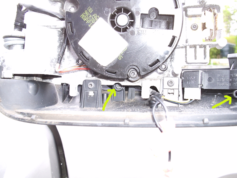

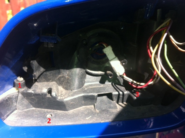

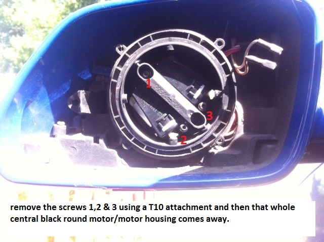

you can see how far i got to replacing the wing mirror indicater/puddle lamp form the pictures attached. i dont have a T10 alan key to remove those last 3 screws (if they are the last piece to the puzzle). do you have to remove them to get the lamp out?
Also after reconnecting everything together again i tested my wing mirror adjuster and now, if i adjust the off side mirror the nearside mirror moves at the same time but in the opposite direction. the near side mirror (the one i slightly dissasembled) still adjusts independantly. WTF!? i am pretty sure they both moved independently before. all i did was disconnect the heating. i left everything else plugged in as there was no need to unplug the cables going into the motor/motor housing.

If you have maxidot it can be done there rather than vcds. The three torx screws are the last piece of the puzzle, you can pick up the bits cheap in Poundland!!

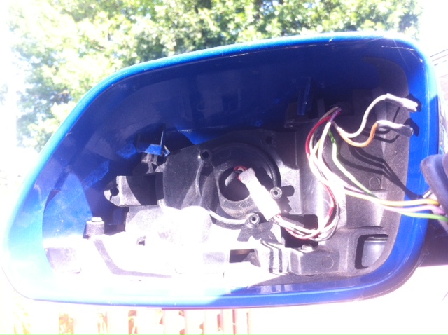

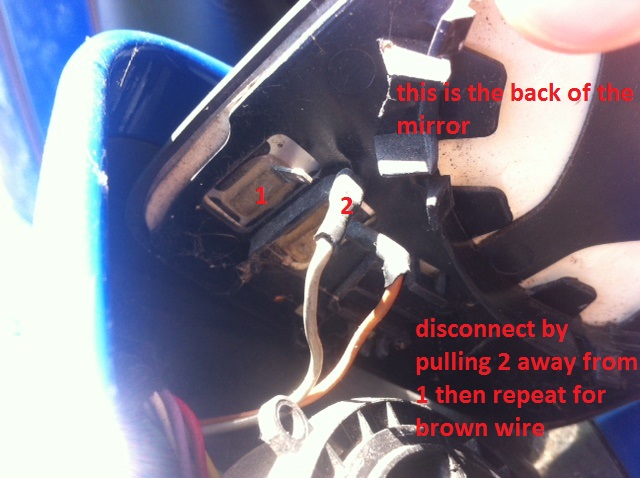

     Remove mirror glass (tilt mirror towards ground, use a hairdryer to warm the plastic [if the day is cold - I was working in about 8C], get as many fingers as you can behind the glass and gently prise the glass out - it will come out with a struggle. Be ready to catch it when it eventually grudges it's way out!). If your mirror is heated, remove the terminals from the mirror back.

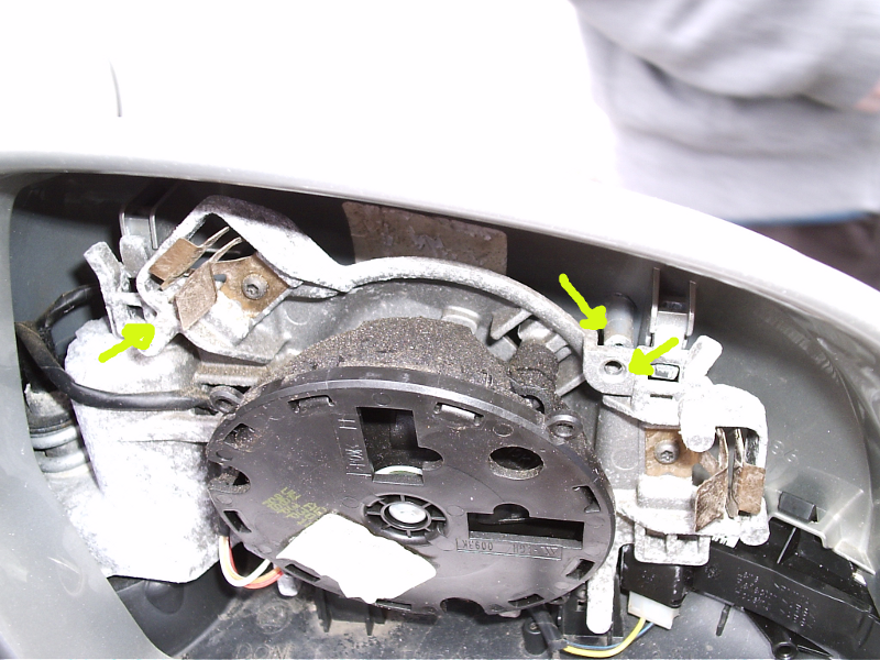

    Remove the two screws holding on the top of the mirror moulding (the body-colour bit)to the die-cast chassis - the pic shows the screws removed from the two arrowed locations. Torx 10 head screws. post-129428-0-95014300-1430859492_thumb.png

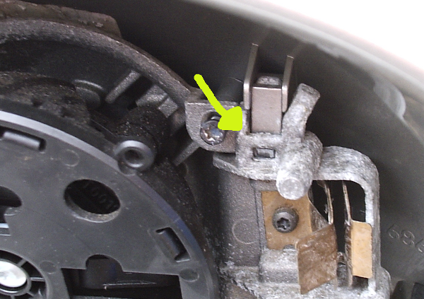

    Gently push in the two silver clips holding the top down on the chassis - arrowed in blue - whilst pulling up the body. Use your third hand if possible - very handy for this kind of work. post-129428-0-72485600-1430859515_thumb.png
    You may have to gently push in the black clips holding the LED assembly on to the bottom front edge of the moulding to get things moving - they fit onto the green arrowed holes on the moulding.

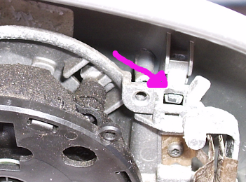

Take care to get the silver clips in front of the diecast seat, not behind (like I did at first...) – the purple arrows show how not to do it – the yellow ones show how it should look. post-129428-0-11517600-1430860086_thumb.pngpost-129428-0-50251000-1430860152_thumb.png
