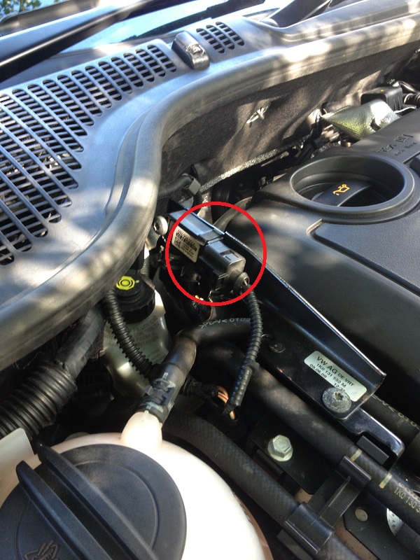

located near the coolant bottle, top left of the engine bay.. its behind a little silver shield thing, 1 torx bolt holding it in.. only slight pain is the rubber pipes on the bottom, quite stiff to get off with pliers.

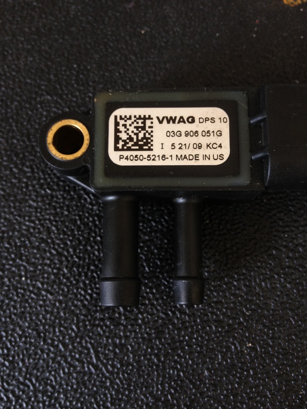

The only way to be sure would be scan with VCDS, but the sensor is a very common fault. Have a look under the bonnet. This is the bit you're looking for
If it's the same as this. Made in the USA, then you can almost be positive.
03G906051A is the old part number replaced by 076906051A
03G906051G is the old part number replaced by 076906051B
Dealers sell them on ebay for £45 to £50
It literally takes 5 mins to swap and 5 mins with the laptop. £200 for the job seems to be the norm but it's taking the p*ss tbh.
