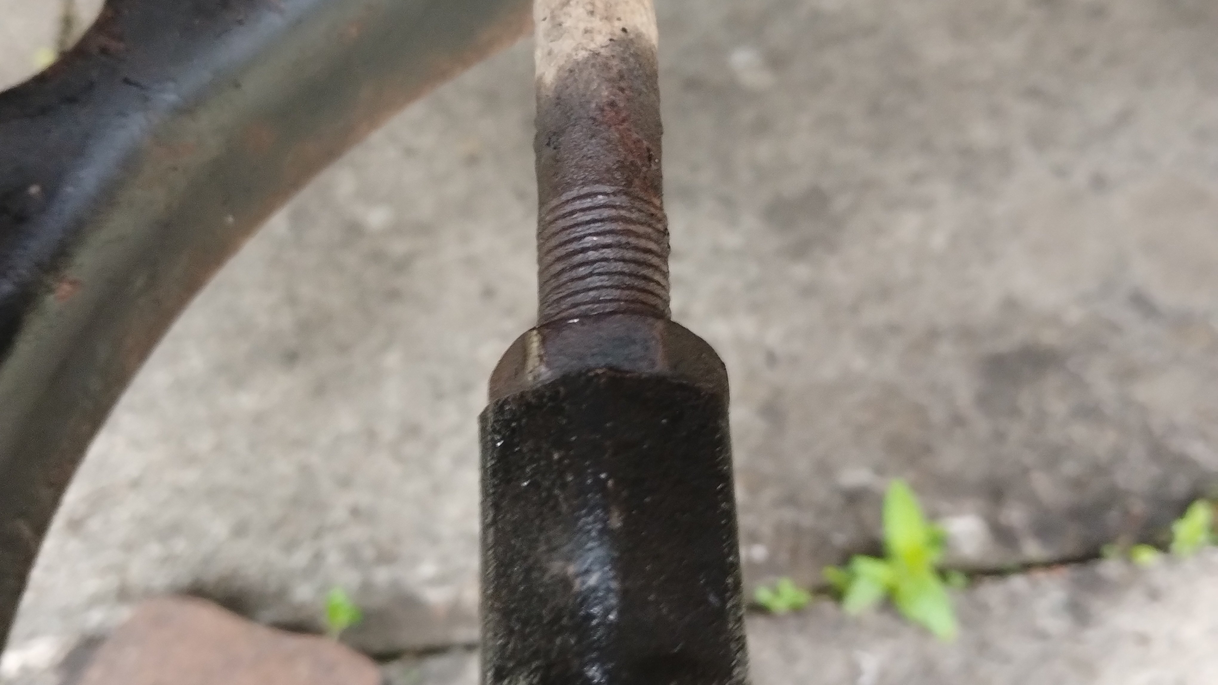

Hi guys, I'm at desperation stage here. Changed bearings on the car. Ball joints also changed. The threads on my TREs were goosed from getting the busy off, so I bought new ones to replace them. My issue is the jam nuts. I have watched/read pretty much everything that's out there, yet these things won't budge. Tried heat, spray etc. Is it definitely clockwise for both to loosen them off you are looking at the hub from the outside of the wheel arch? Lefty loosey when looking from the inside of the wheel. Drivers side loosen by turning towards the front of the car and passenger side turn toward the rear of the car. I can't really get much purchase on them as the wheel arch is in the way. Zero progress so far. Any ideas? I have considered replacing the inner rods too, although it will be a full car rebuild at this rate!

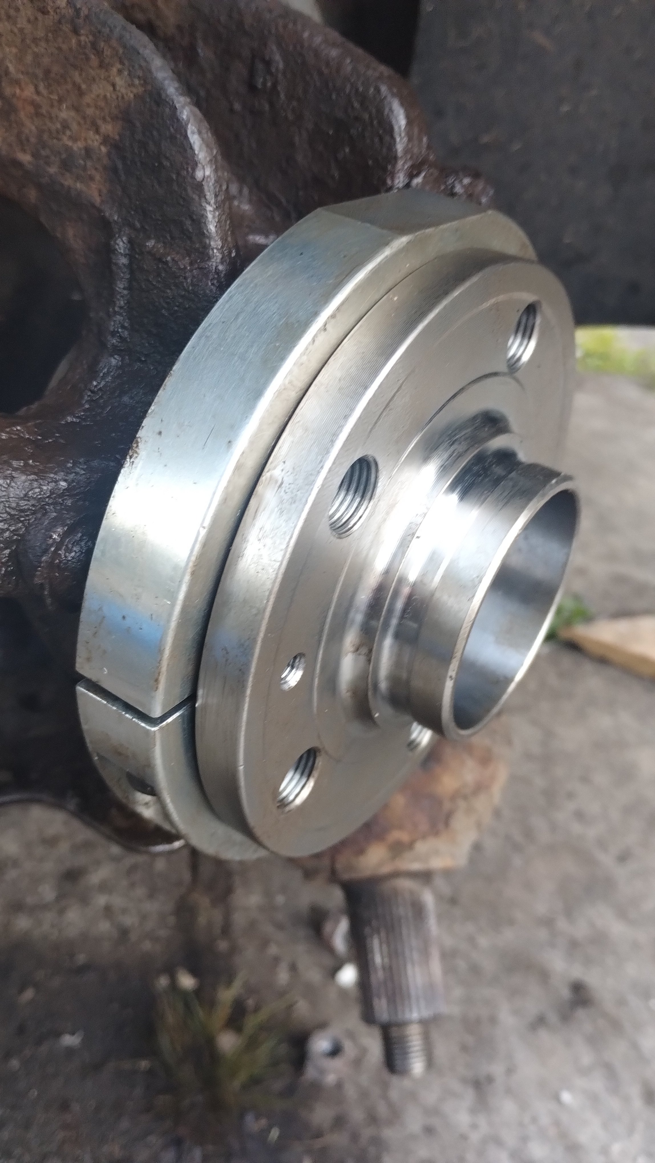

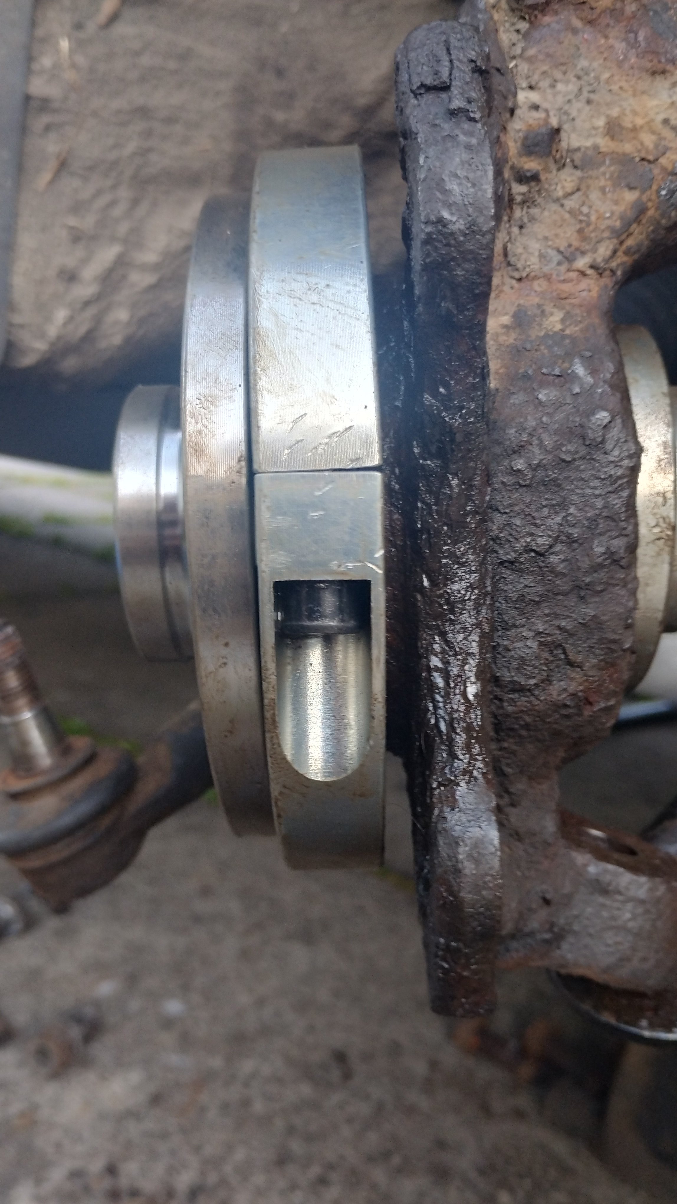

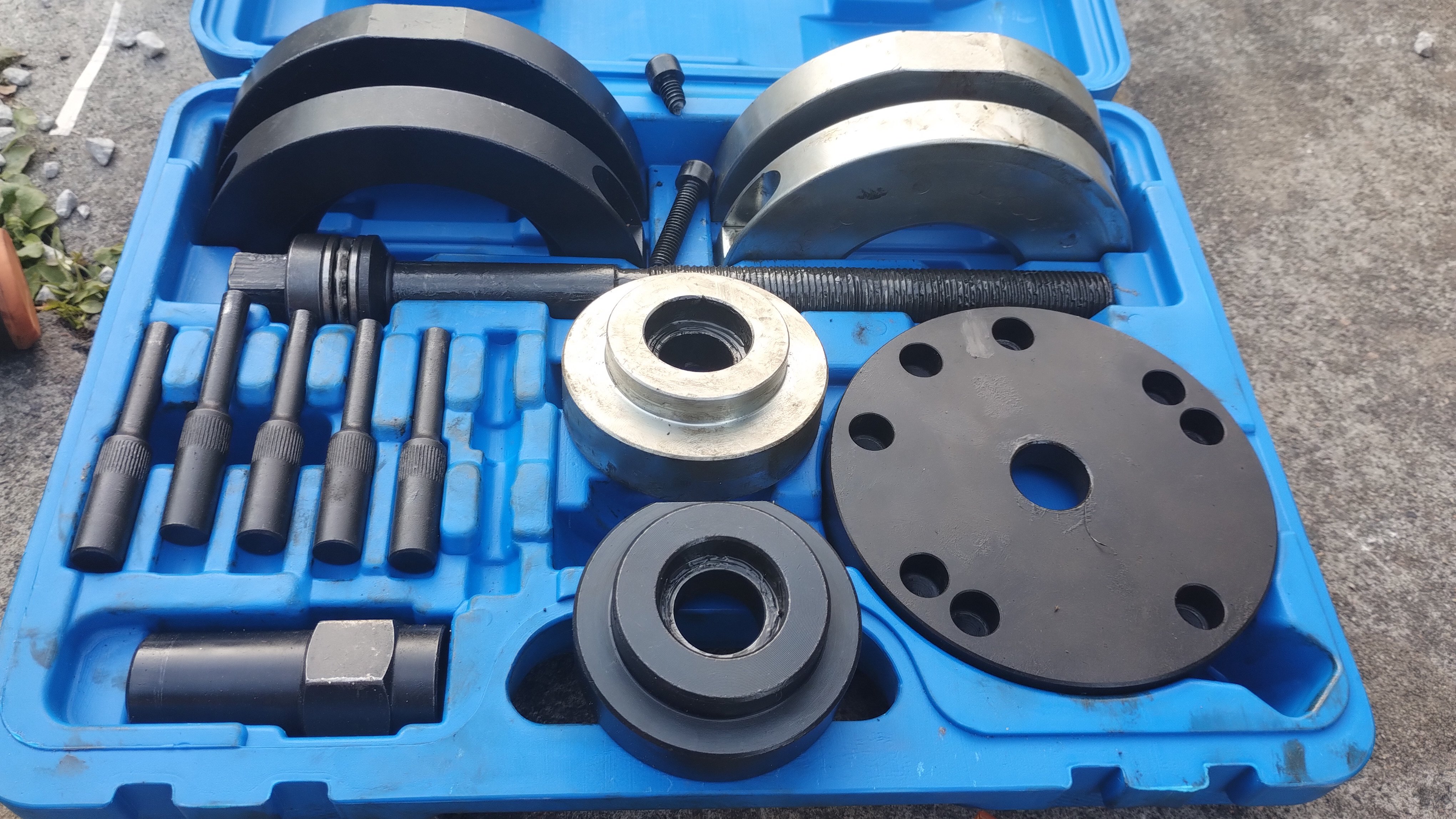

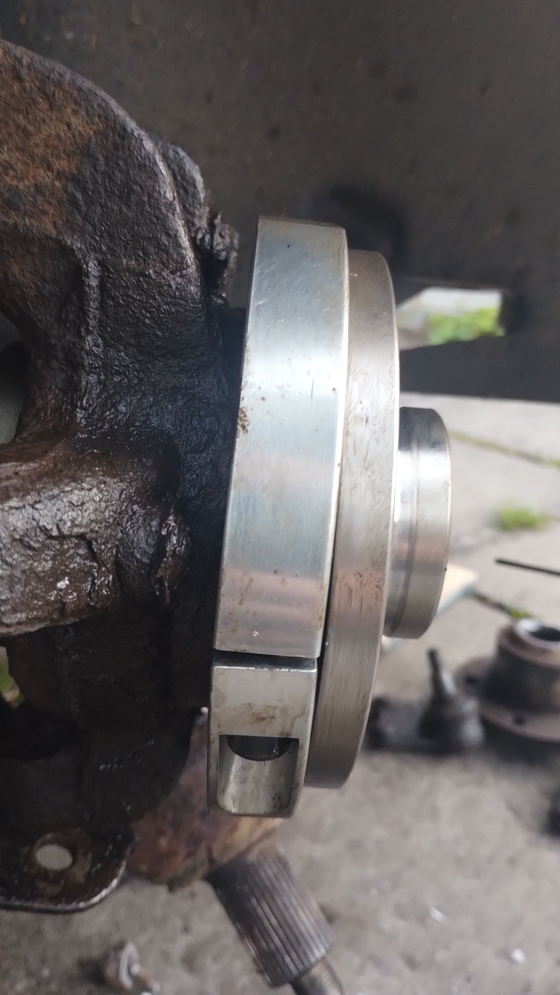

Totally agree that the split part clamp wedging between the new bearing and the housing is a concern, although perhaps operator error on my part by not cleaning up the hub housing more fastidiously before proceeding. The inner diameter of the silver clamps is perhaps a snug fit for a newish housing, whereas with some rust it may have wedged against it, although you would hope that the manufacturer would account for this. Also, when I snapped the allen bolt off, the silver clamps fell loose, which suggests it was wedged on to the hub carrier as opposed to being wedged between the new bearing and the carrier. For anyone taking on this job, I would also suggest that you go slowly with the press and regularly check that the allen bolts on the silver clamp are tight. They can work themselves loose a bit as you progress with the job. Is anyone able to change the title of the thread to something more fitting? It may make it easier to find in future. Maybe something as simple as 'Front wheel bearing change'
Bolt and Nut Sizes (2009 Roomster)
Once again, brute force wins the day. Snapped the press bolt in two using a heavy duty Allen key. Both bearings look well seated to me. Fairly certain that I have used the tool correctly, which is all black parts for removal and all silver parts for installation. Based on the instructions above, I am left wondering if the colours may vary depending on where you buy the tool.
I used the black ones to pull the old bearings out and the silver ones to put them in. This is what I saw on one of the videos I watched, although I have real reservations now!

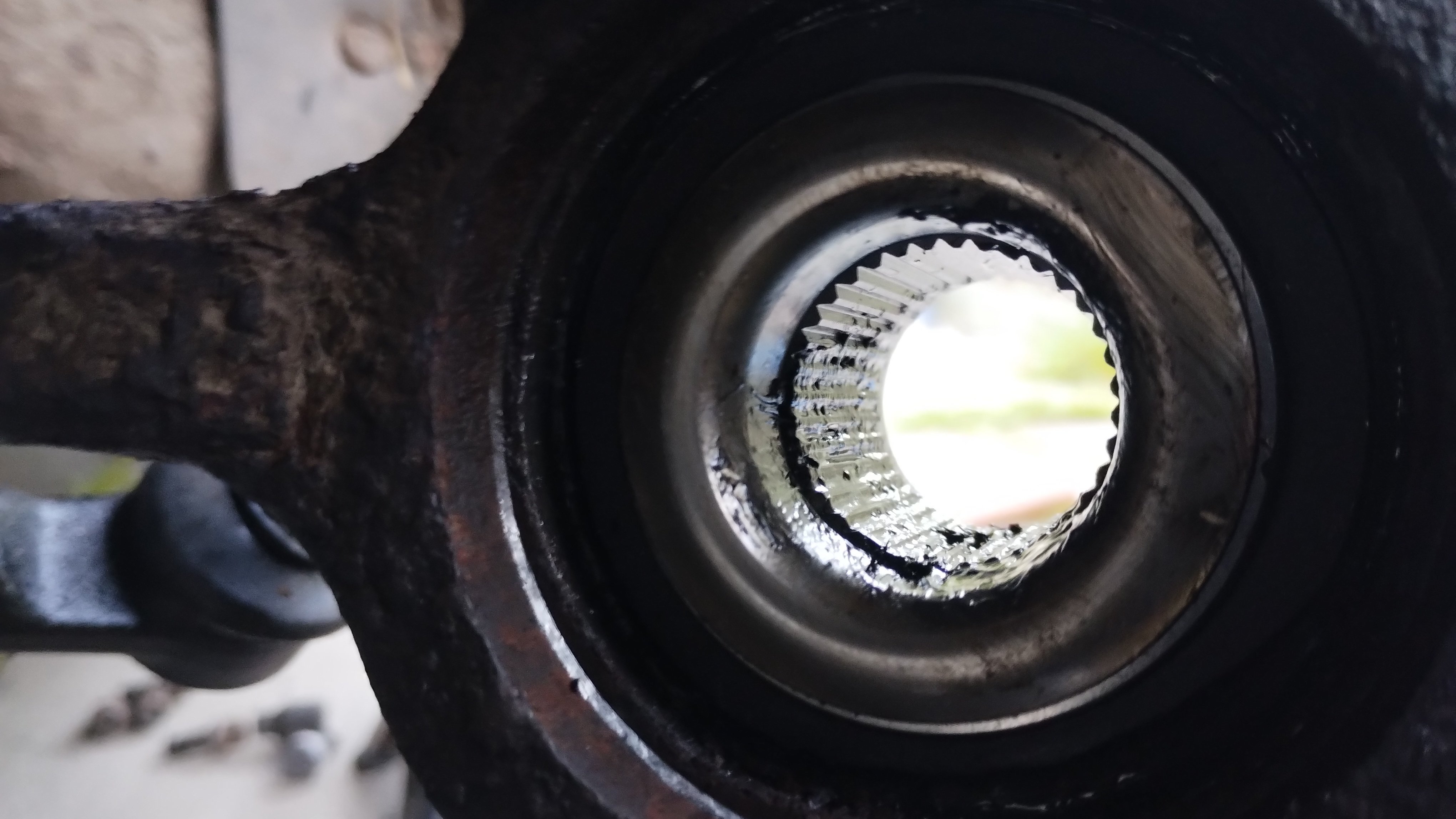

The wheel bearing gods have not been kind... Did the other bearing tonight. The two metal plates from the tool are wedged against the hub. Definitely can't remove with the allen key, which is now goosed. On a positive note, the allen bolts appear to be good quality. Any thoughts? Try and pry it apart with the little gap between the tool plates? Drill out the allen bolts.

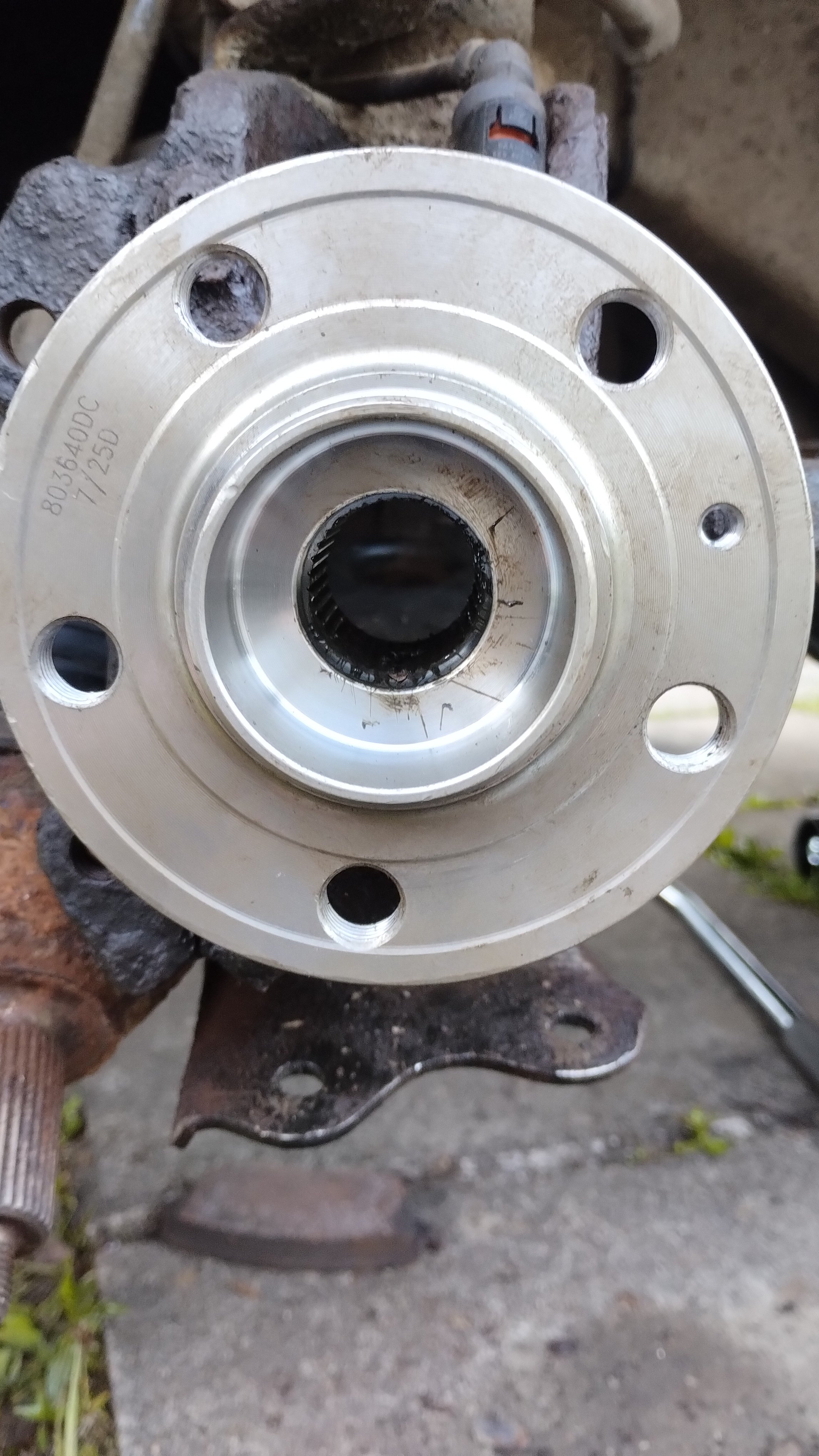

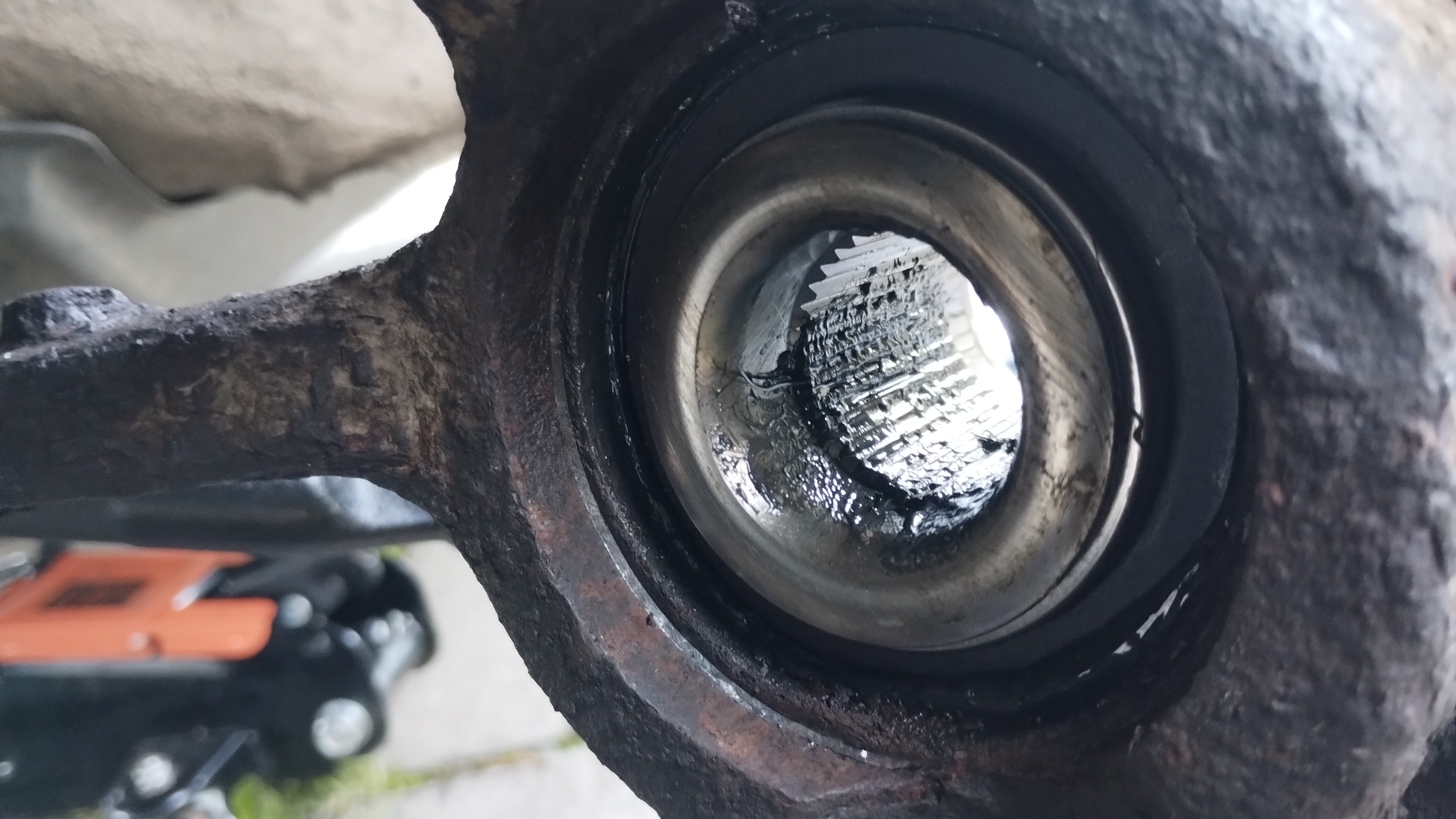

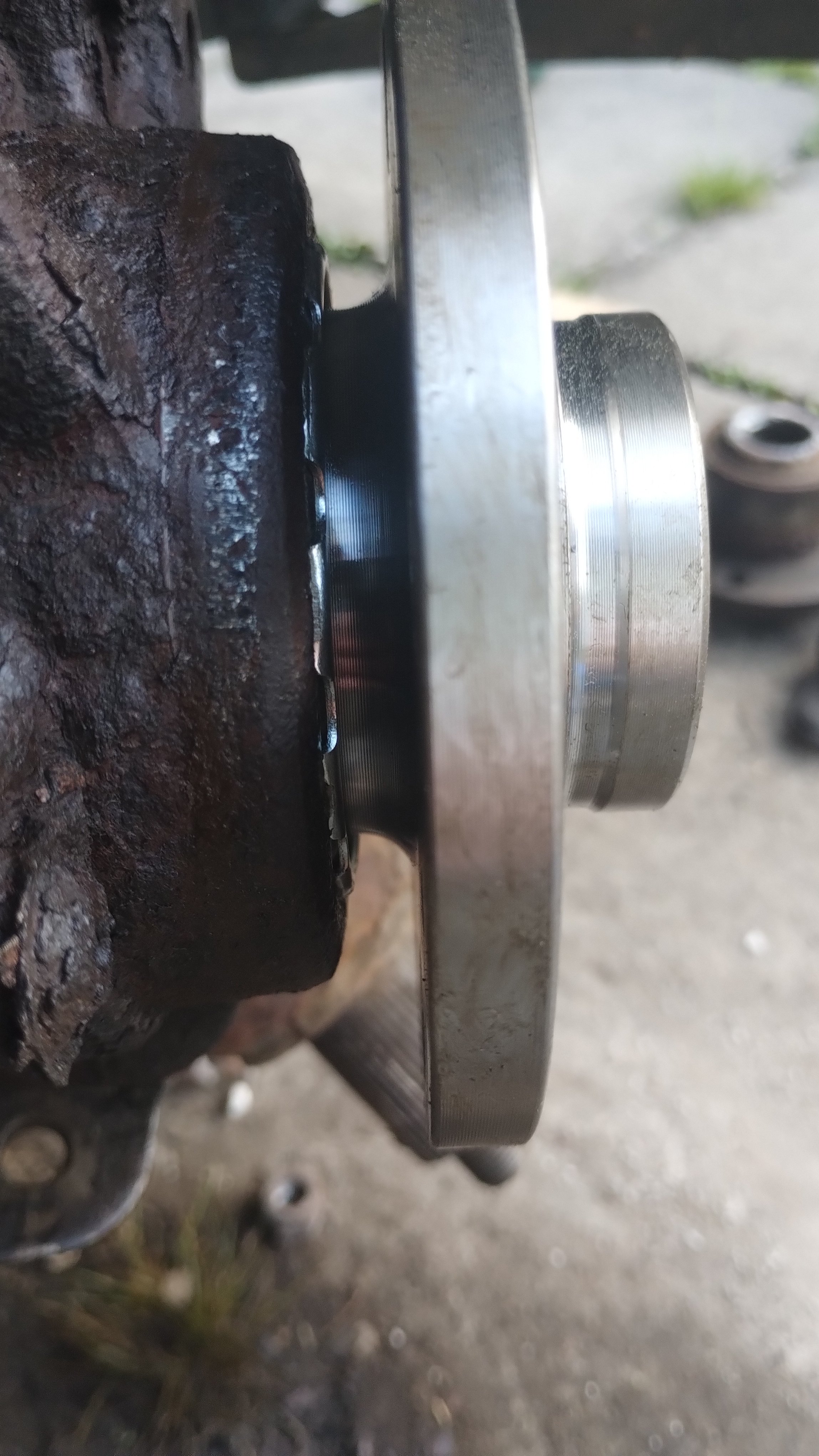

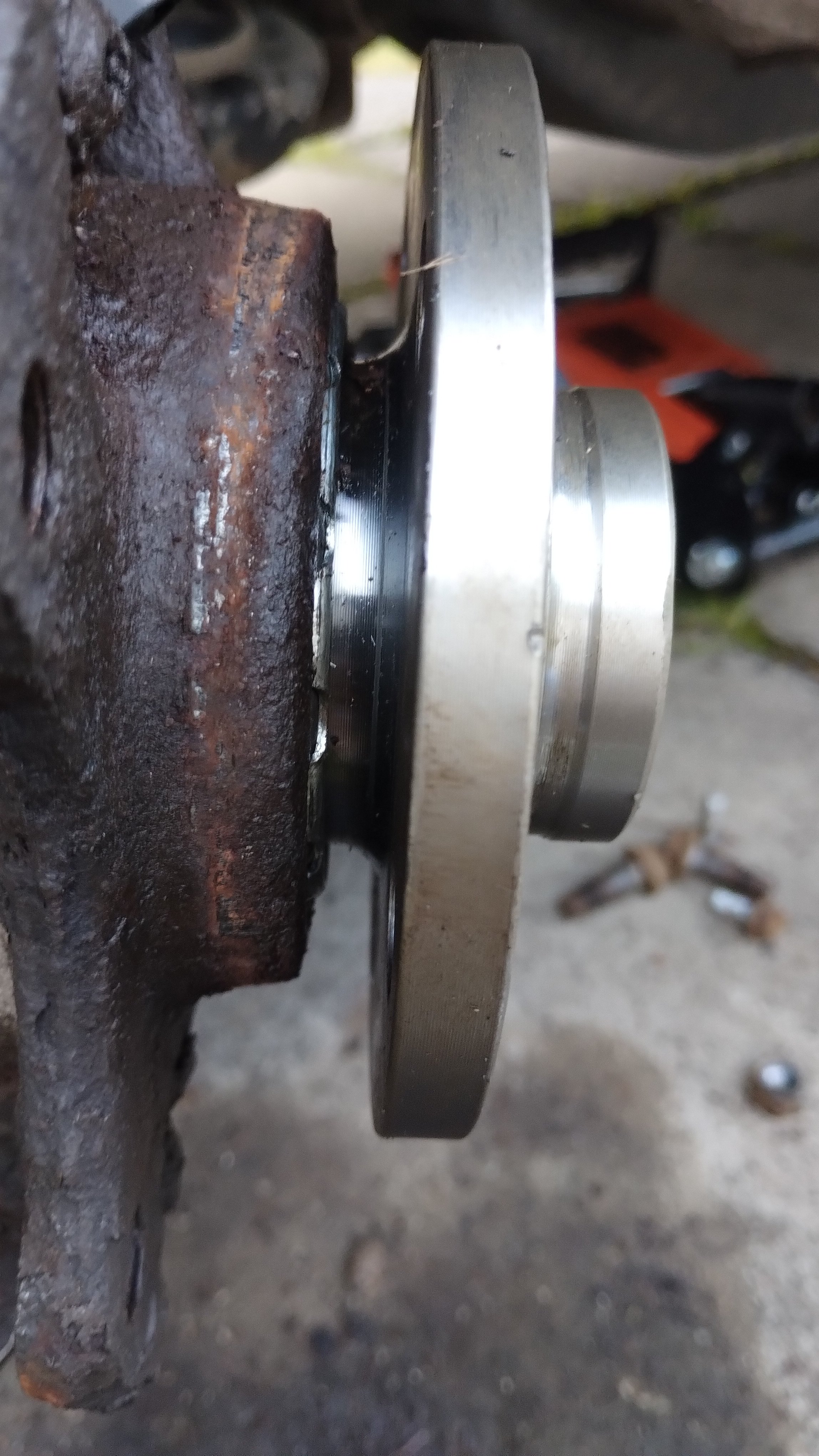

Right then, chaps. Does this bearing look like it's seated correctly? It was one hell of a job to get it in! Probably the hardest I've worked on a car mission. On the vids I watched, they say listen for the click of the circlip engaging. Didn't hear any click. Does that matter?
