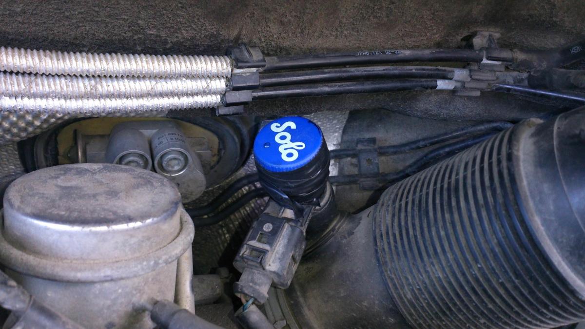

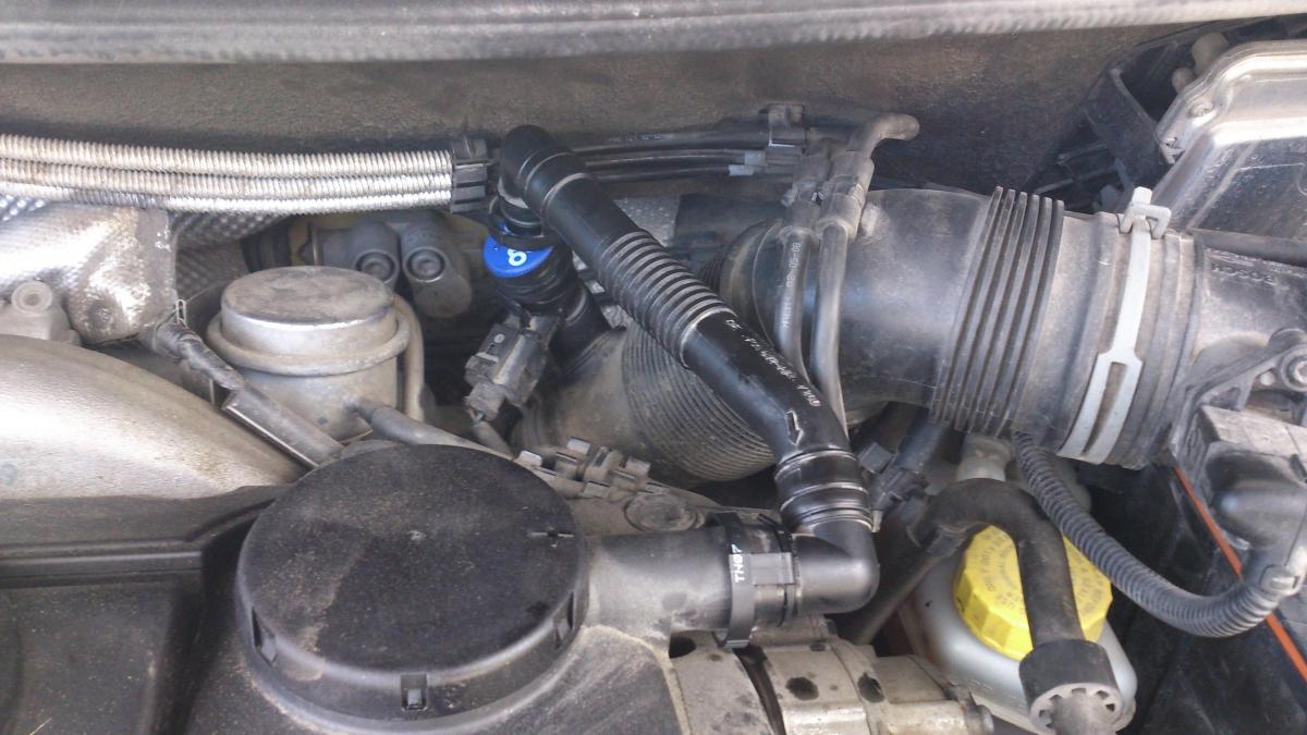

jankph, you gonna have a laugh at this mate=)
I just did a mod to the CCV system, as we already know it feeds the oil fumes into the intake just in front of the turbo. The hose vas filled with black oil when i disconected it from the engine.
Her are some pictures of the "mod" :p
The original placement of the CCV pipe.
And heres how i blinded the connector in the intake side:P
This is just temporary to see if the car would run with the mod, gonna redo it on Monday when the scrapyard opends up so i can get some hoses to work with.
