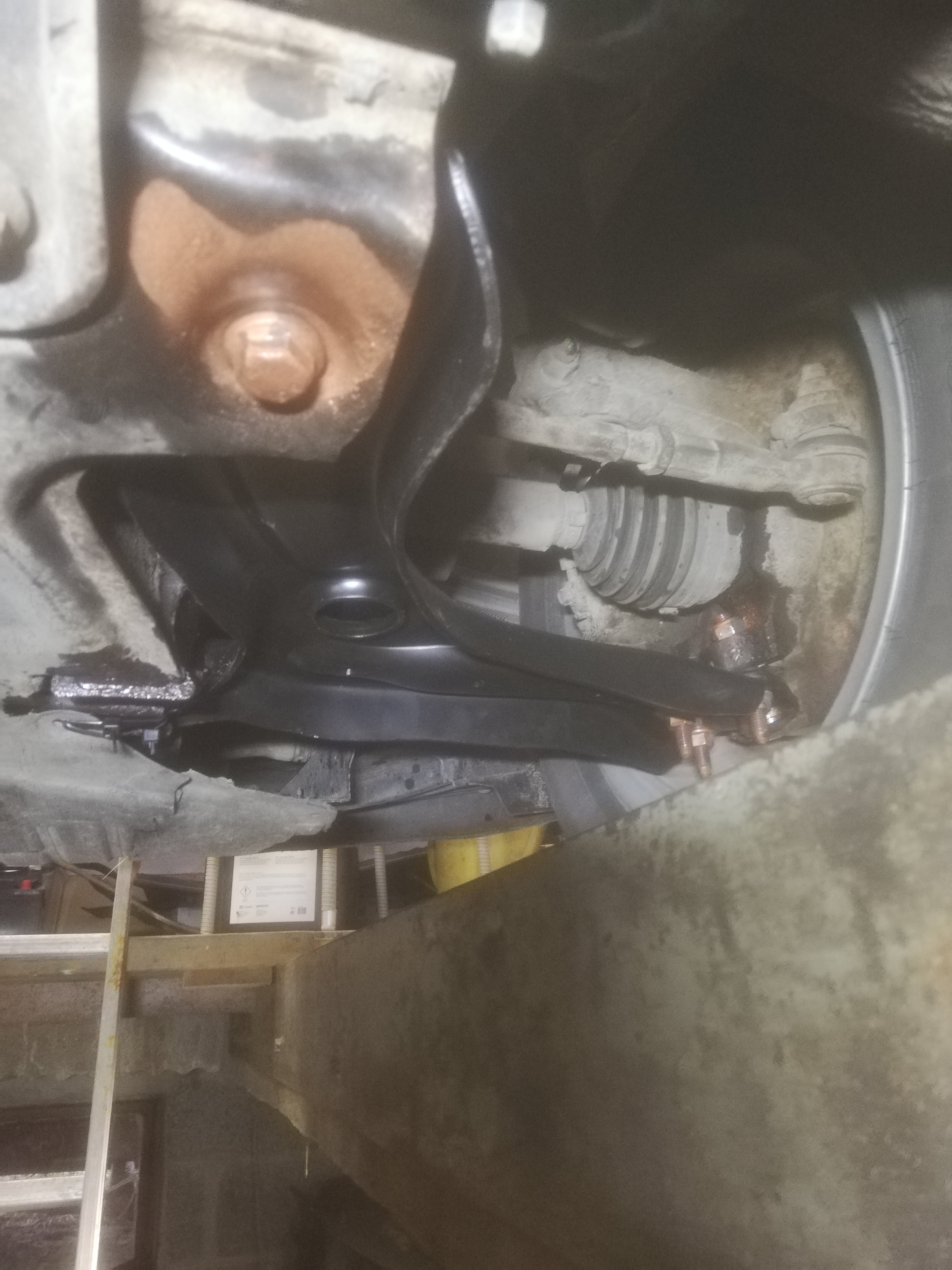

  7. Just posting incase someone else get the same problem. Changed to some new normal control arm bushings and the car is back to normal. Lesson for today, if you have a 3-cylinder do not change to cupra or poly bushes on the control arm or the engine mount unless you want a rough ride when the engine is under 2000rpm.
  8. I'm changing back to normal bushes and having an aligment done after that. If it wasn't for the NVH i would have kept them, i like some of the characteristics of them better. I just didn't imagine that the control arm bushes would transfer engine noise, i only seen warnings about harder engine mounts doing so.
  9. So i changed fromt ARB bushings and control arm's with cupra bushings, now my 3-pot has horrid NVH when i pul from idle to ~1300rmp. It shakes the entire car, over 1300rpm it goes smooth again and rides like a charm. It also shakes like that if i engine brake under 1300rpm. What could be the culprit? I have not done an alignment yet either. Also the ARB bushings where ordered as 20mm and my ARB is 20mm, but the old bushings had a bigger internal diameter when i took em of, tho they did have 190.000km on them so maybe just worn down some?
