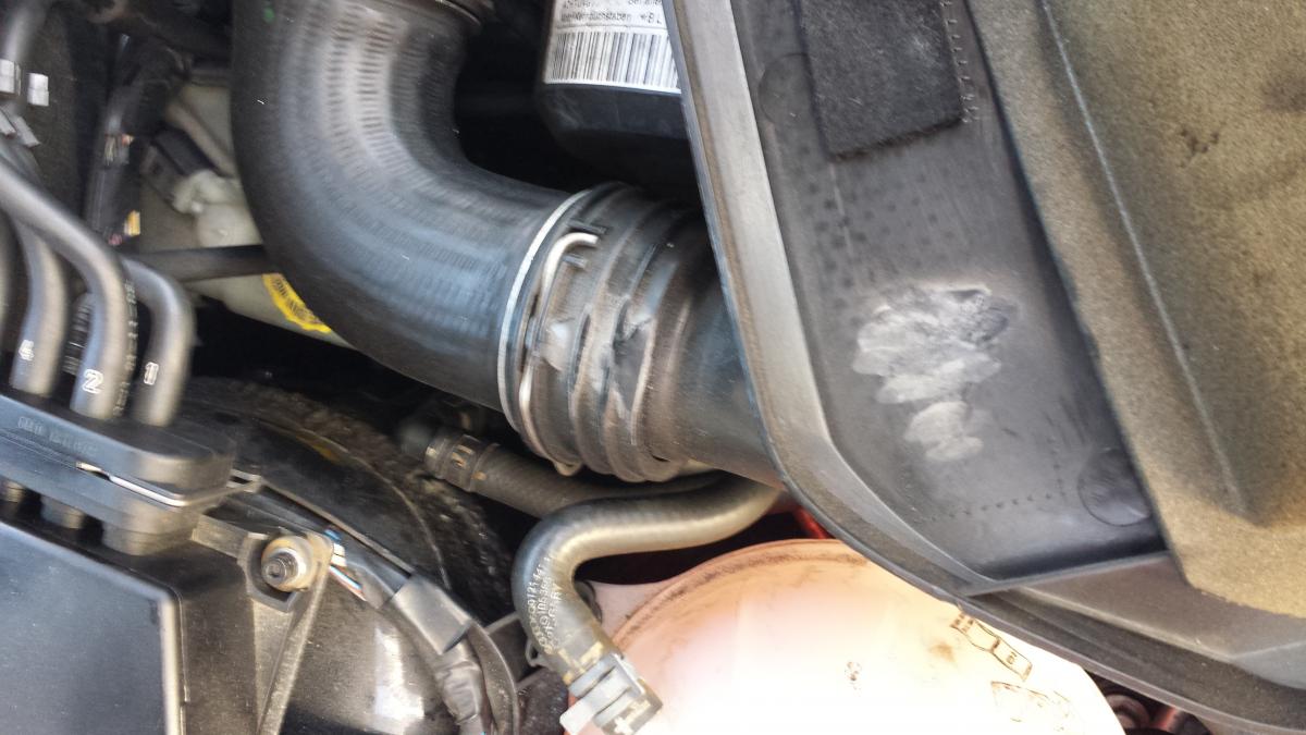

Has anyone seen this before? It is common?
My engine shakes alot at idle and I was wondering if that is what has caused the issue...
Thats the back of the engine cover right?. . .its just rubbin on the metal clip on the boost pipe,the engine cover will be fine,just make sure ya dont wear thru a boost pipe. .

Yea the foam is there but doesn't cover this part. If you remove yours you will see its just plastic at that bit. I am thinking about removing the cover? Your thoughts?
Had the same on mine, I stuck a piece of sticky Velcro to the underside of the cover when it rubbed (the loop side of Velcro, furry bit)
