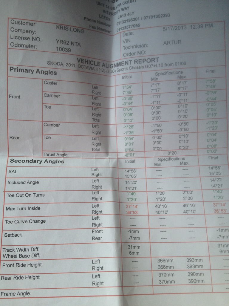

Mine from abc for the facelift model.

Abc use a hunters rig and the best in the area. They go for a test drive as well and alter to how you like it. £70

Do a search for one of my posts as I wrote my settings out for my 2010 FL VRs which was done at the Audi dealer on behalf of Skoda UK.

BEFORE                    AFTER
L/F                                                      L/F
Camber minus 0degrees 25seconds        Camber minus 0degrees 27seconds
Toe minus 0degrees 2seconds            Toe plus 0degrees 6seconds
L/R                                                     L/R
Camber minus 1degrees 42seconds        Camber minus 1degrees 43seconds
Toe minus 0degrees 6seconds            Toe plus 0degrees 5seconds
R/F                                                    R/F
Camber minus 0degrees 46seconds        Camber minus 0degrees 45seconds
Toe plus 0degrees 1seconds            Toe plus 0degrees 5seconds
R/R                                                  R/R
Camber minus 1degrees 27seconds        Camber minus 1degrees 26seconds
Toe minus 0degrees 1seconds            Toe plus 0degrees 6seconds
Total Toe                    Total Toe
Minus 0degrees 1second            Plus 0degrees 11second
Steer ahead                    Steer ahead
Minus 0degrees 2seconds            Plus 0degrees 1second
Total Toe                    Total Toe
Minus 0degrees 7 seconds            Plus 0degrees 11second
Thrust angle                    Thrust angle
Minus 0degrees 3seconds            0degrees 0seconds
