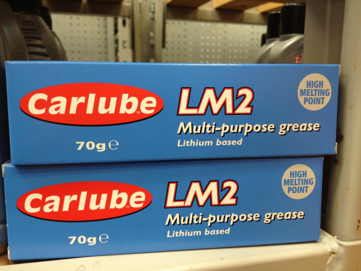

What are people's opinions on this stuff for lubing calipers instead of copper grease?
