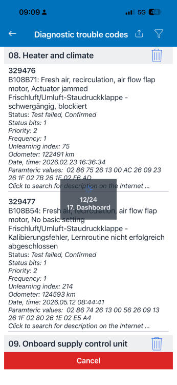

Yes. Mine was stuck. The flap is above the pollen filter above the glove box. You can try moving the flap with your fingers.
But first try a recalibration. You can do it with carscanner or by holding AC and front vent button for a few seconds until the lights start flashing.
If not then it will be the actuator. I had to change the one for the main diverter. £10 from Amazon for a non genuine. And about 20 Mins to change.

The calibration thing sorted my stick recirc flap. This is just above the pollen filter so sometimes detritus on the filter can get stuck in it. I think mine might have been the extra wiring from the reversing camera fouling it too.
But could be a failed actuator. Not expensive and pretty easy to change.

Some are on a worm gear so you won’t be able to move them if the actuator isn’t trying to move them too.
If you carefully remove pollen filter you can see the flap at the back of it. It’s recommended to slip a bit of cardboard beneath filter to catch any crud that is sitting on top of filter otherwise it goes into the fan.

It was the motor for the flap which is stuck
