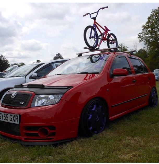

Yes mate :)
Just read mate I had 20mm rear adapters and they caught change them for 15mm
And 15mm on the front aswel because they will catch aswel mate I also ran 195 45 16
Cheers mate, didnt realise someone had done it though aha...
Looks niceee :)
To be fair mate there was quite a few people did it I have swapped two of my 8j for 7.5j so can get the staggered look
Also 8j 8holes are 12mm thread bolts but some people drill them out to 14mm like I did so just check before you buy adapters
