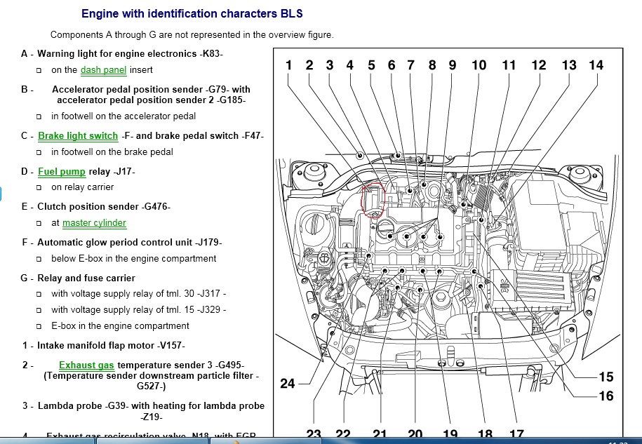

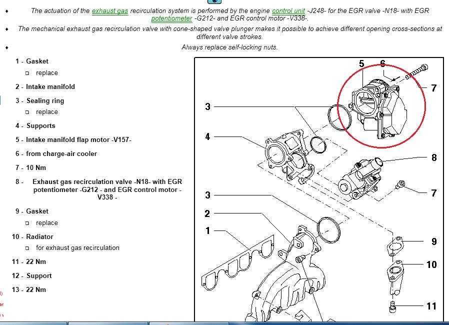

Ok. understood. so what is the purpose of this flap?? The inlet mainfold flap motor. What it controles?
That is the anti shudder valve.
When you turn off the ignition, it closes off the supply of air to the engine to prevent it shaking when shutting down.
ok ;) thanks for info. I didnt know that a diesel needs a cutt of supply of air for the engine to shut down normaly.
Should it be cleaned periodically? It affects the performance or the health of the engine somehow if its cludged?
