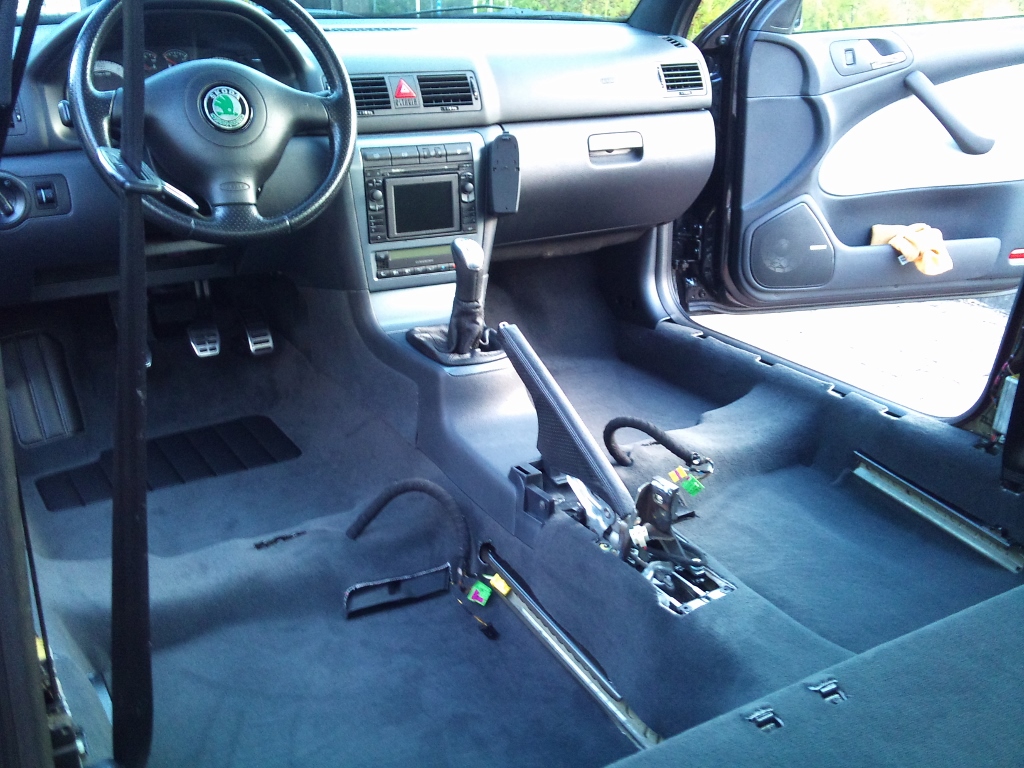

this is basicly what you'll end up with, this was before i got my vrs steering wheel
Thanks for that.  The black carpet definitely looks better!  The white edges of the vRS mats stand out nicely against the black carpet too.

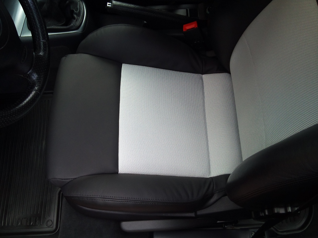

Well worth doing! I changed the foam and seatcover for the driversseat at the same time.

With regards to the fitting and removal for ease I cut the old one out around the rear of the centre consol and cut the new one and slid it around the back!
All the cut marks are hidden and it just saves removing the entire centre consol
