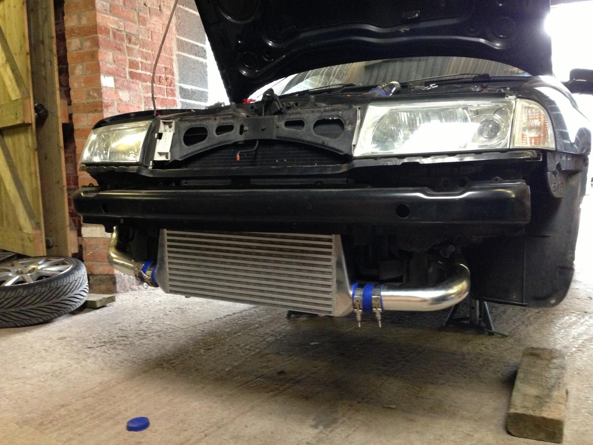

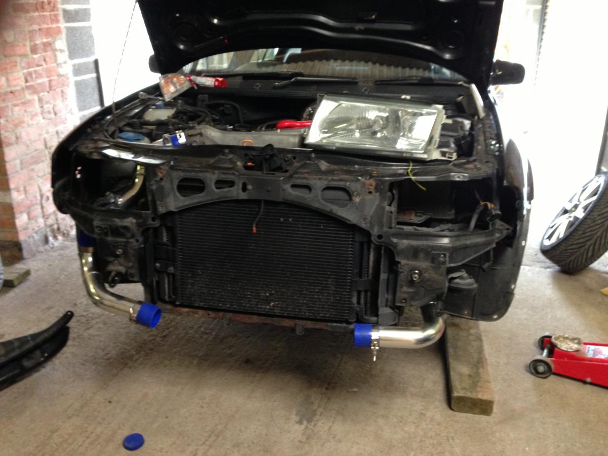

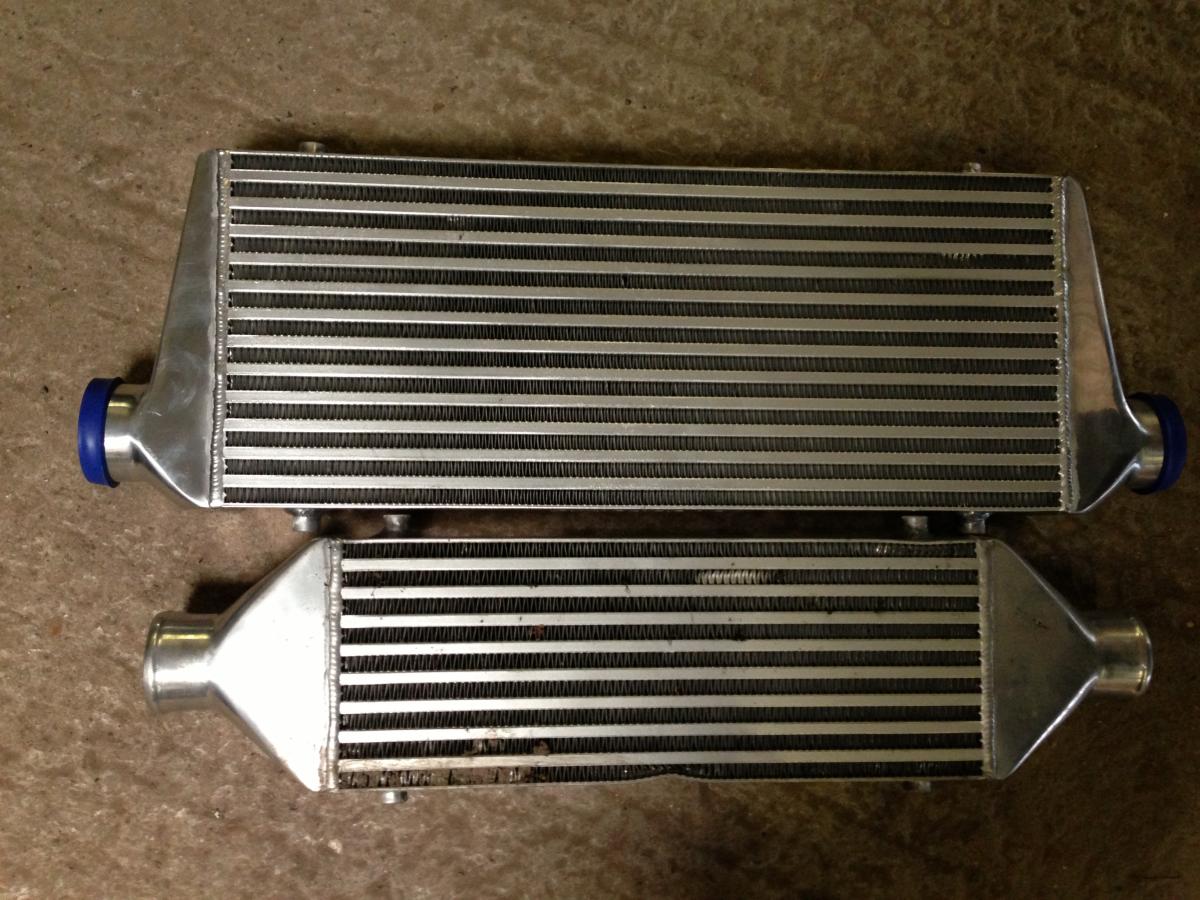

Fitted my new I/c setup today! After ordering a toyosports kit I found that the tiny core that came with it caused all sorts of problems when fitted. It hung far to low and would catch n absolutely everything I went over! so ordered a bigger core size from toyosports (possibly the wellycooler?) and set about fitting. Took my time and all went well. The I/c pipe that goes into my inlet is now unbelievably cold :D

What piping kit is that?
Its the kit from toyosports mate. Around £230 for the piping and the smaller cooler! Hoping to get the top pipe that comes off the turbo re-made at about 2.5 inch instead of 2 inch.
