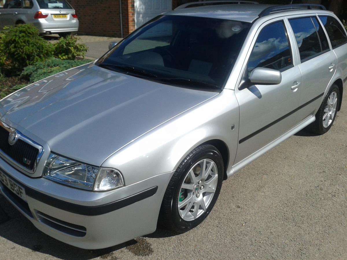

First of all hello to everyone. I have just bought a 53 plate vrs estate with 96000 on the clock. It is totally standard and cost me £2000. I have just had the cambelt and waterpump done along with a service and tyres+tracking. The only issue is that the temp gauge is reluctant to get up half way. It does get there in the end but if you put the heat up a bit it drops slightly. Thermostat issue?
