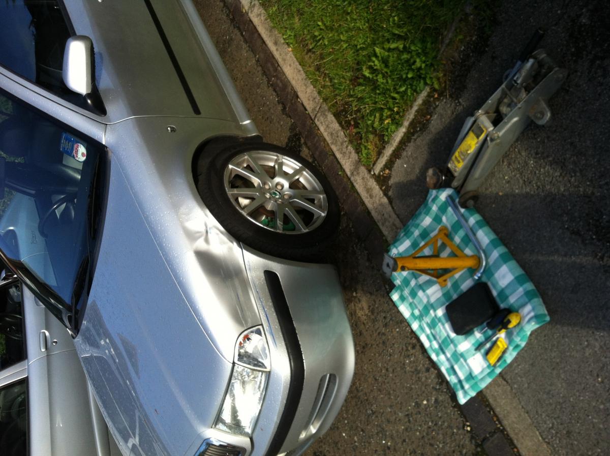

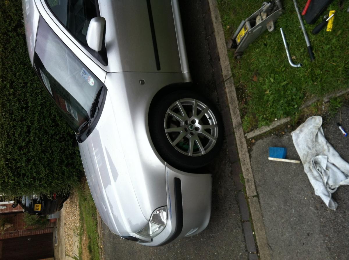

Cheers Bowders, just this sec finished, it was a really easy job to be honest, i would put before and after pics on but dont know how to? The difficult part is now to find out who did it so i can put the old wing through they'r windscreen lol
Pics figured out.....

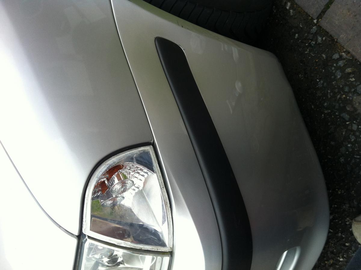

You could probably get that blue mark out your bumper with some t cut or rubbing compound.
Now go look for a blue car with silver paint on it :devil:
Yeah did it just after posting the other pics yesterday, used some of mu cutting comp
From my polishing gear then waxed it after and it came up a treat.
