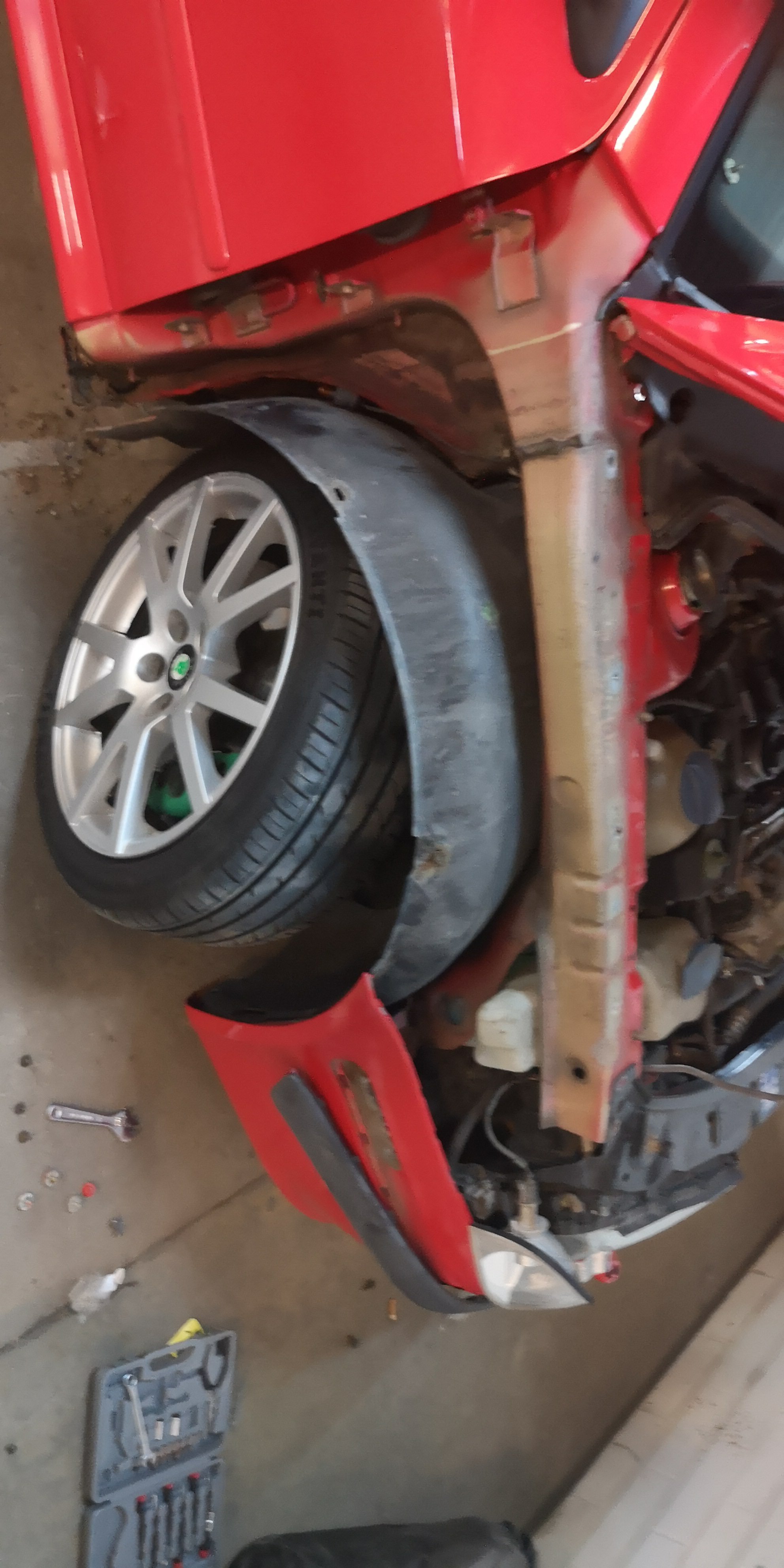

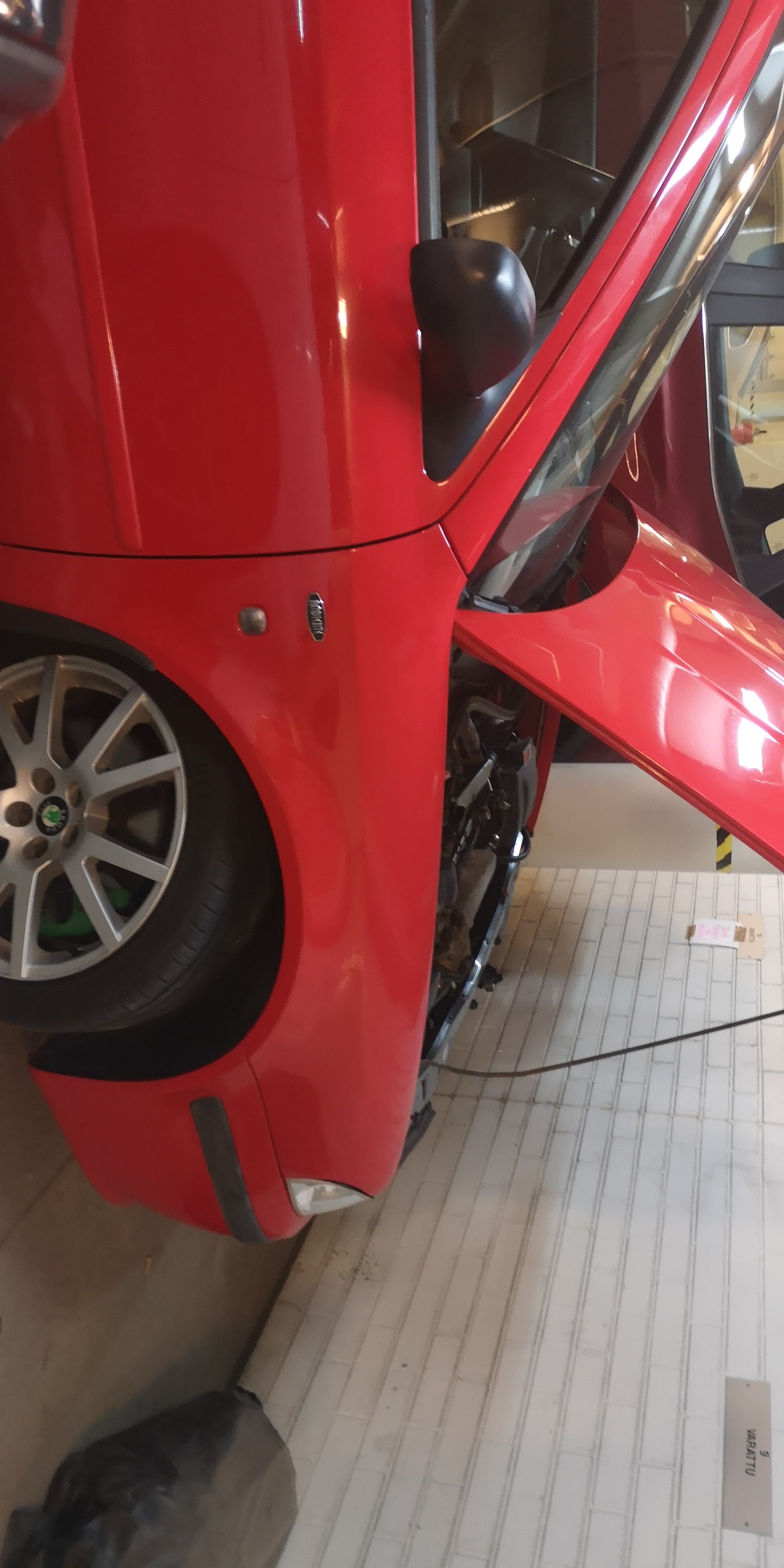

should end up with somthing light this

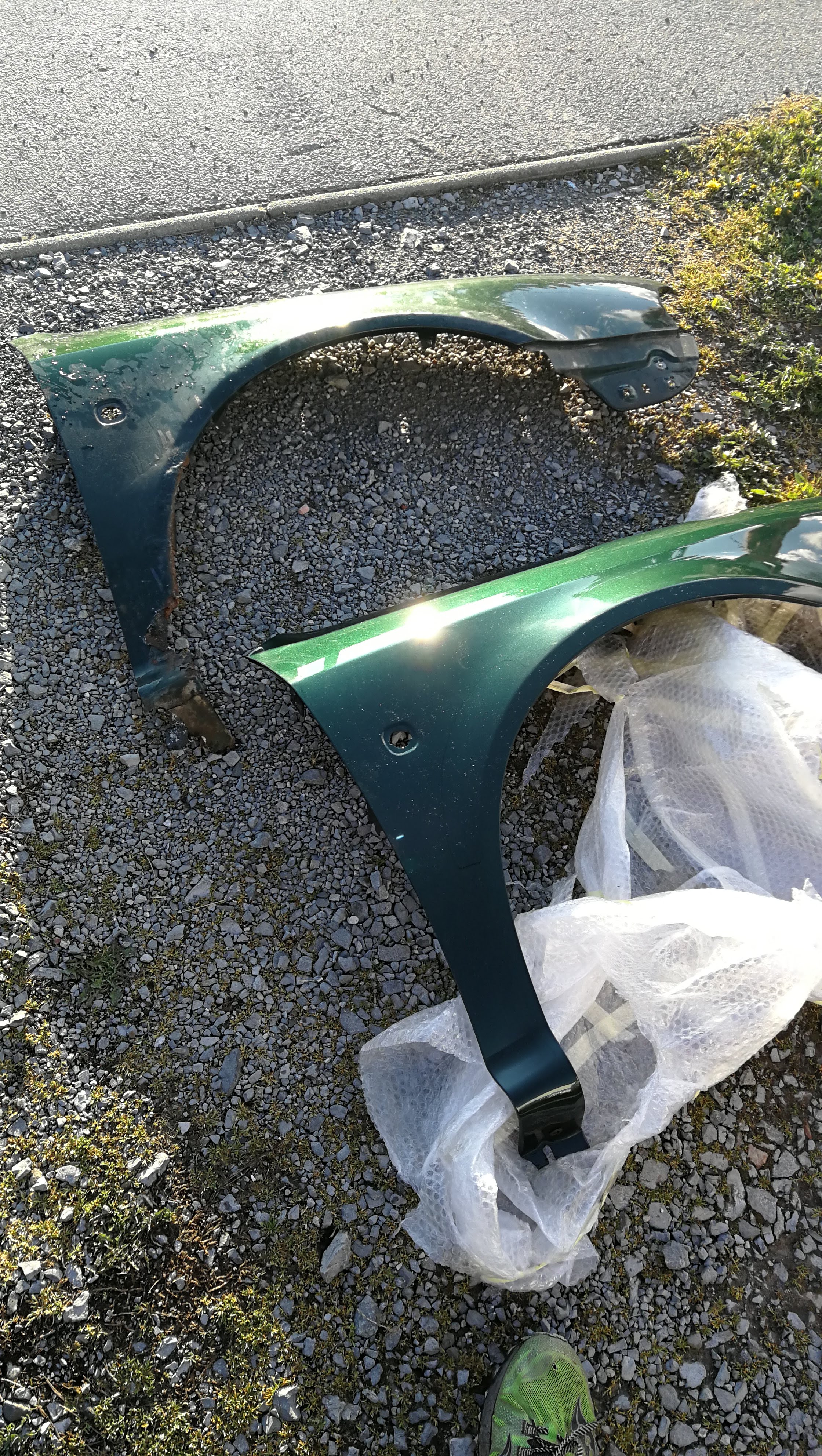

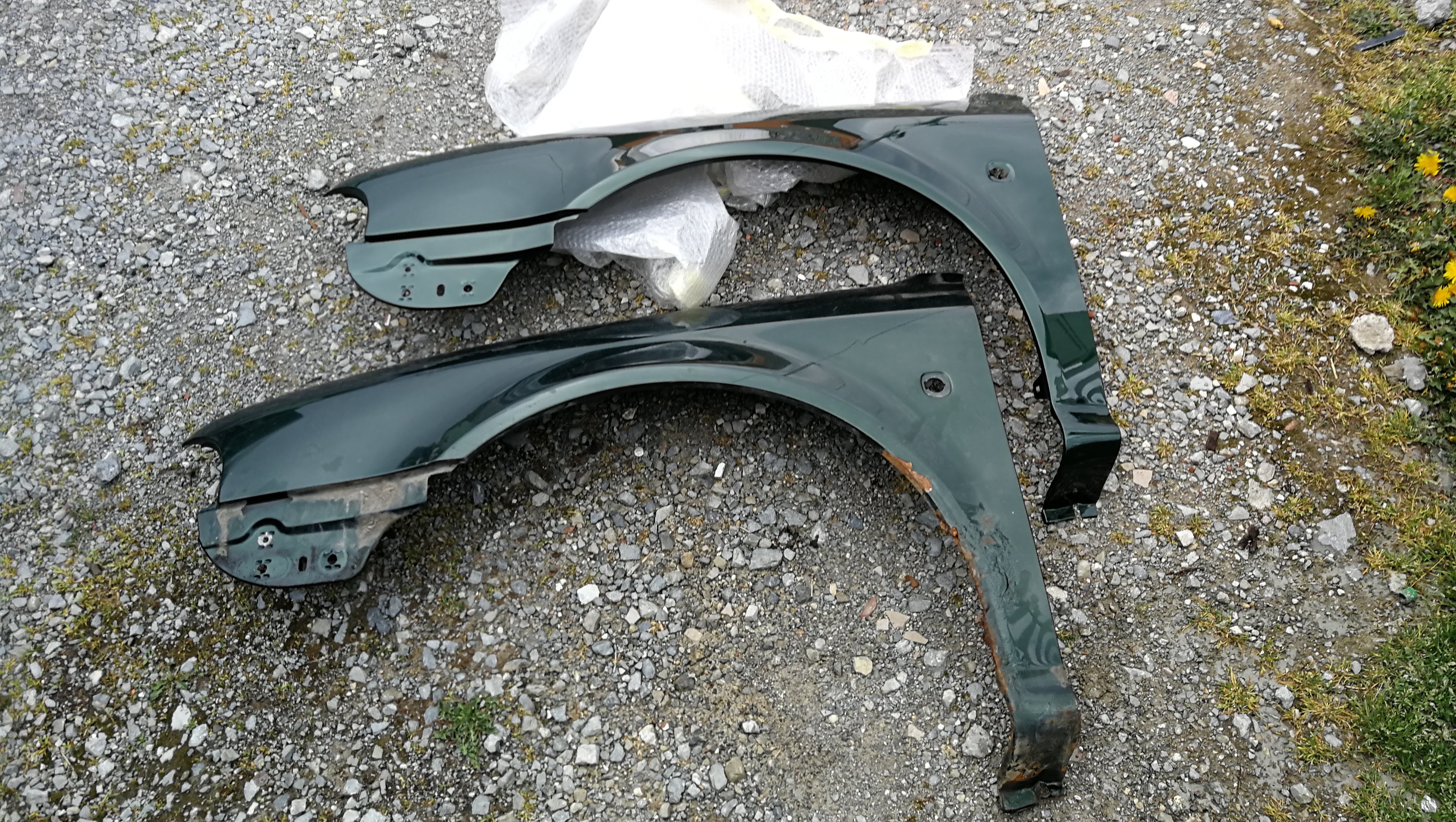

Thanks for the writeup, it's really simple and straightforward, you only really need the torx 25 and bit no 10.

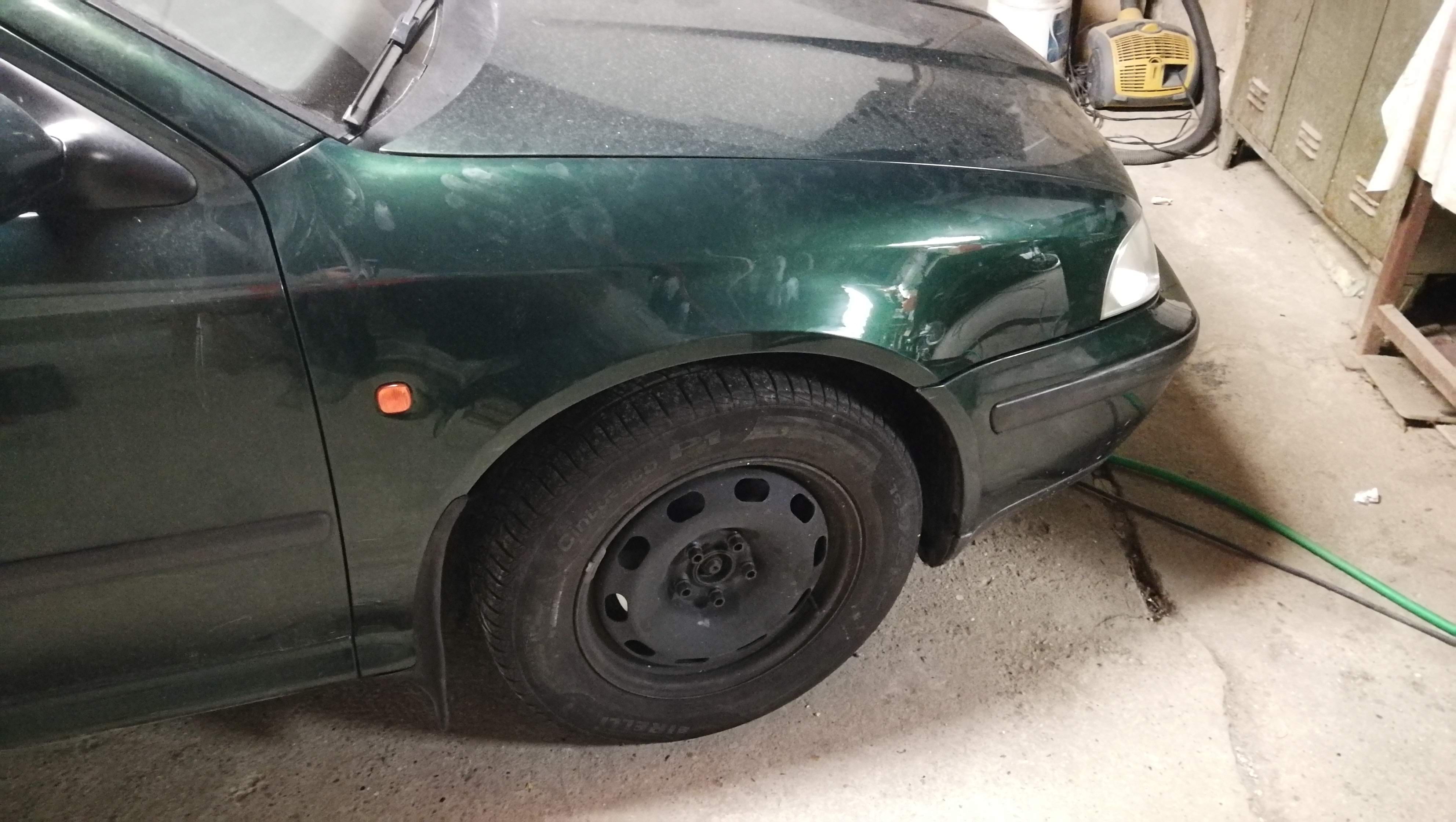

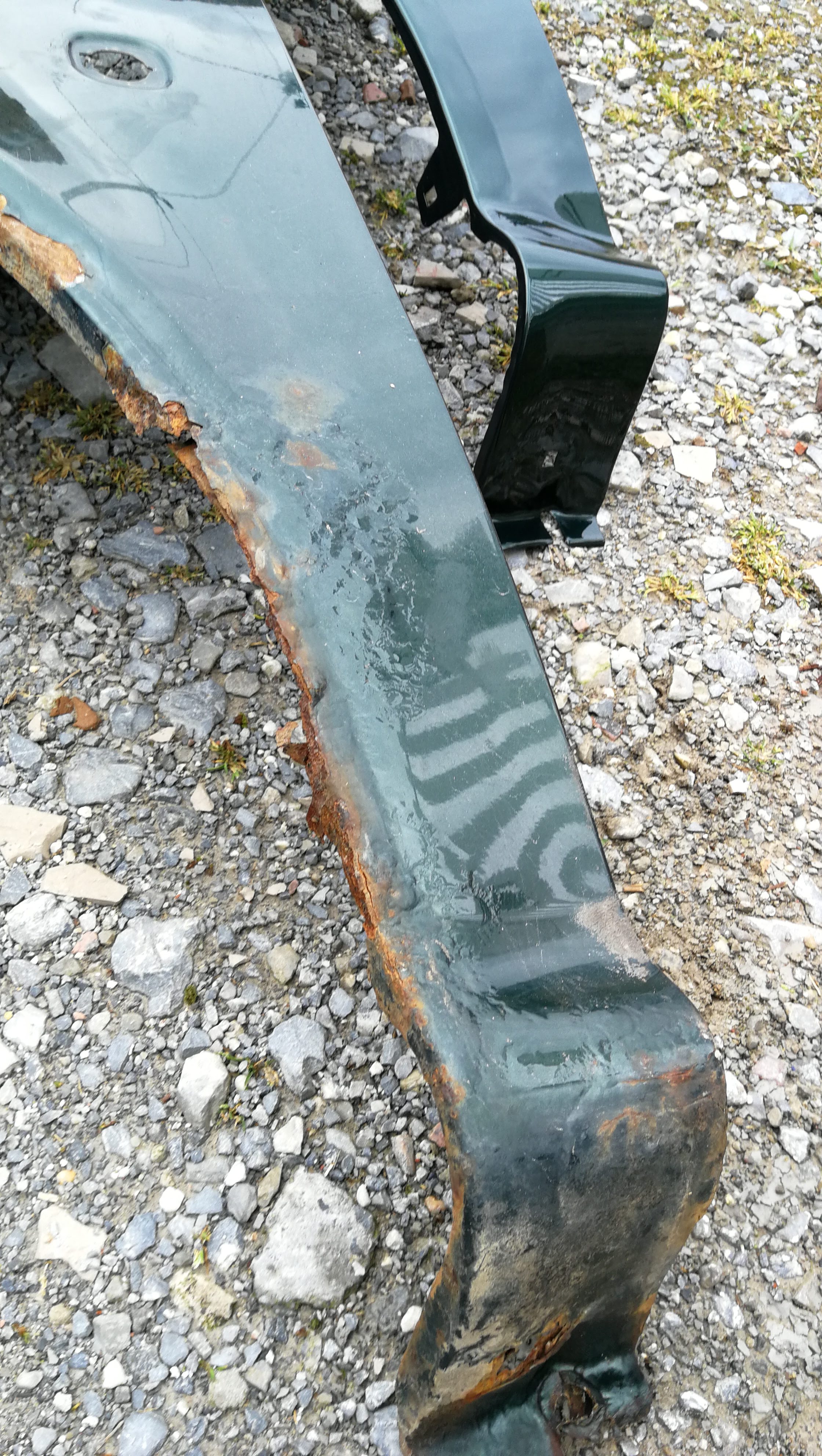

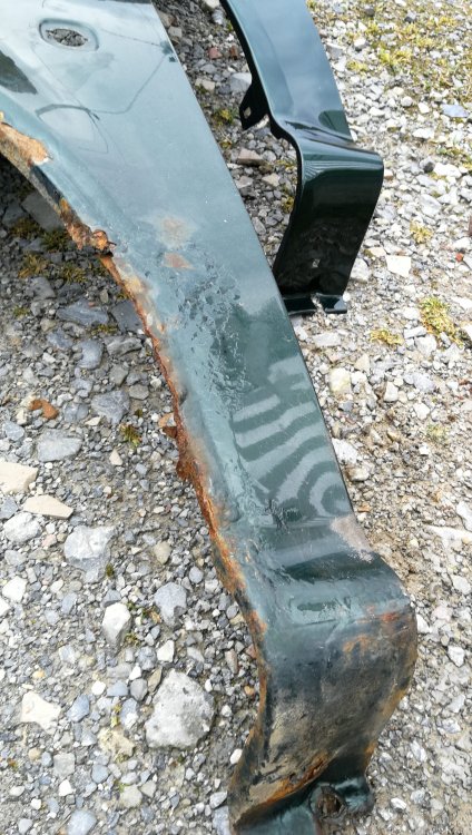

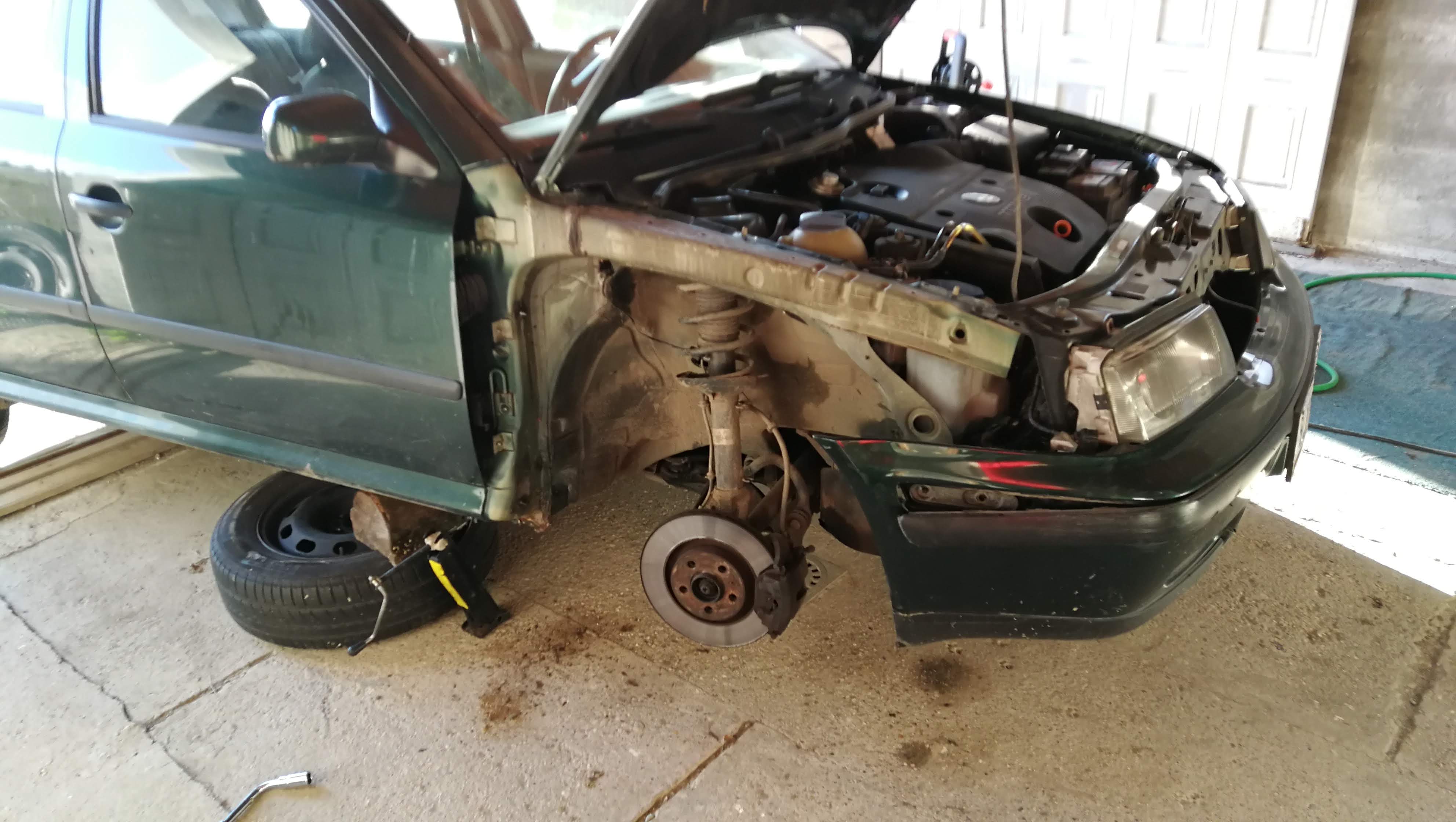

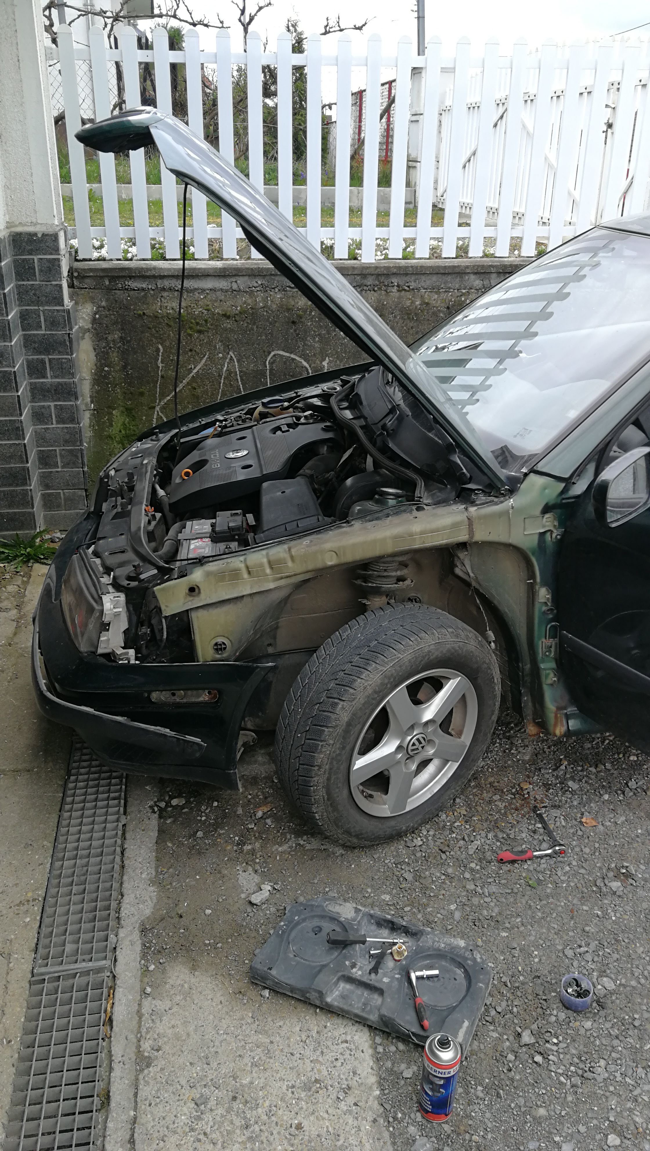

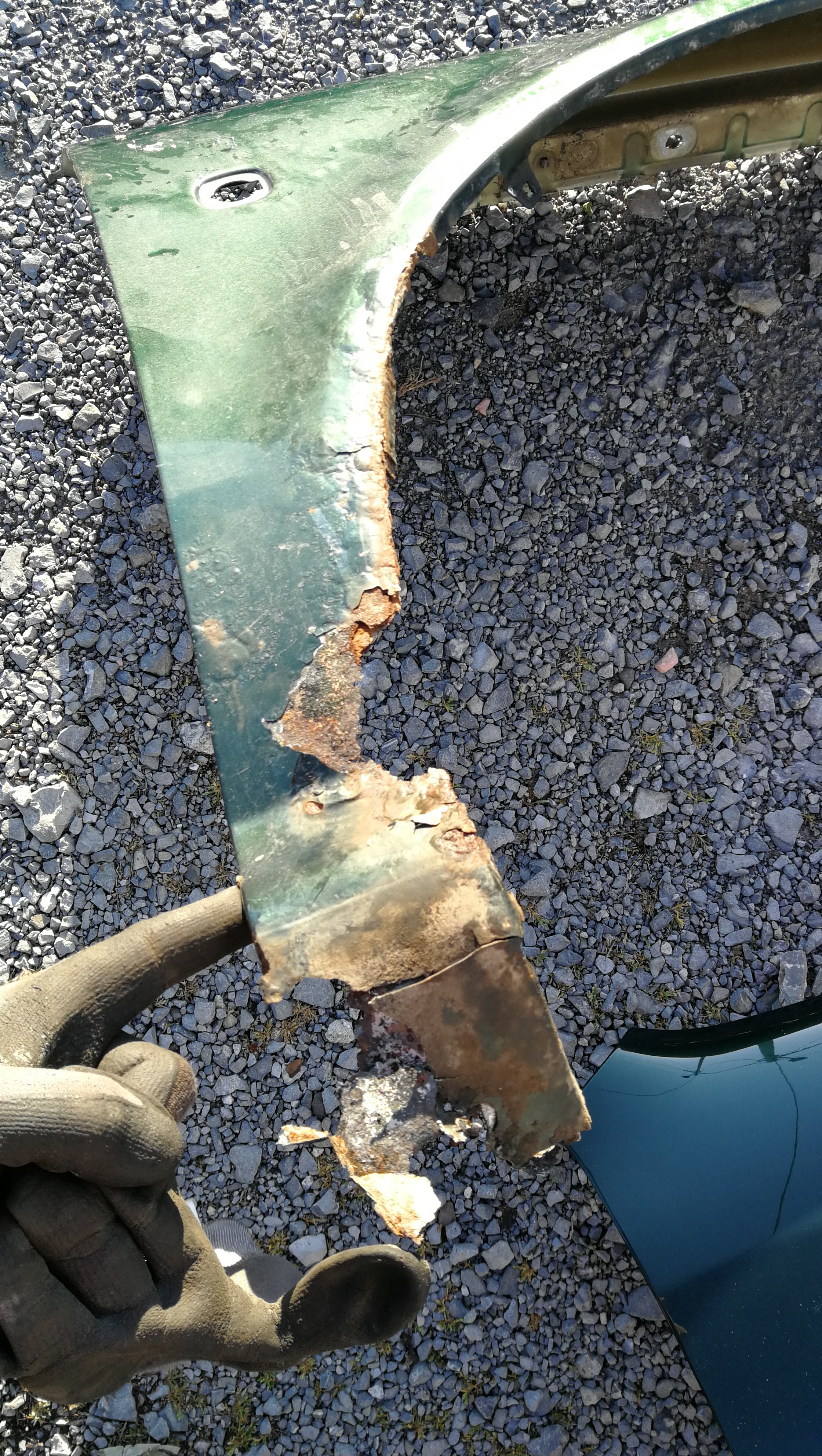

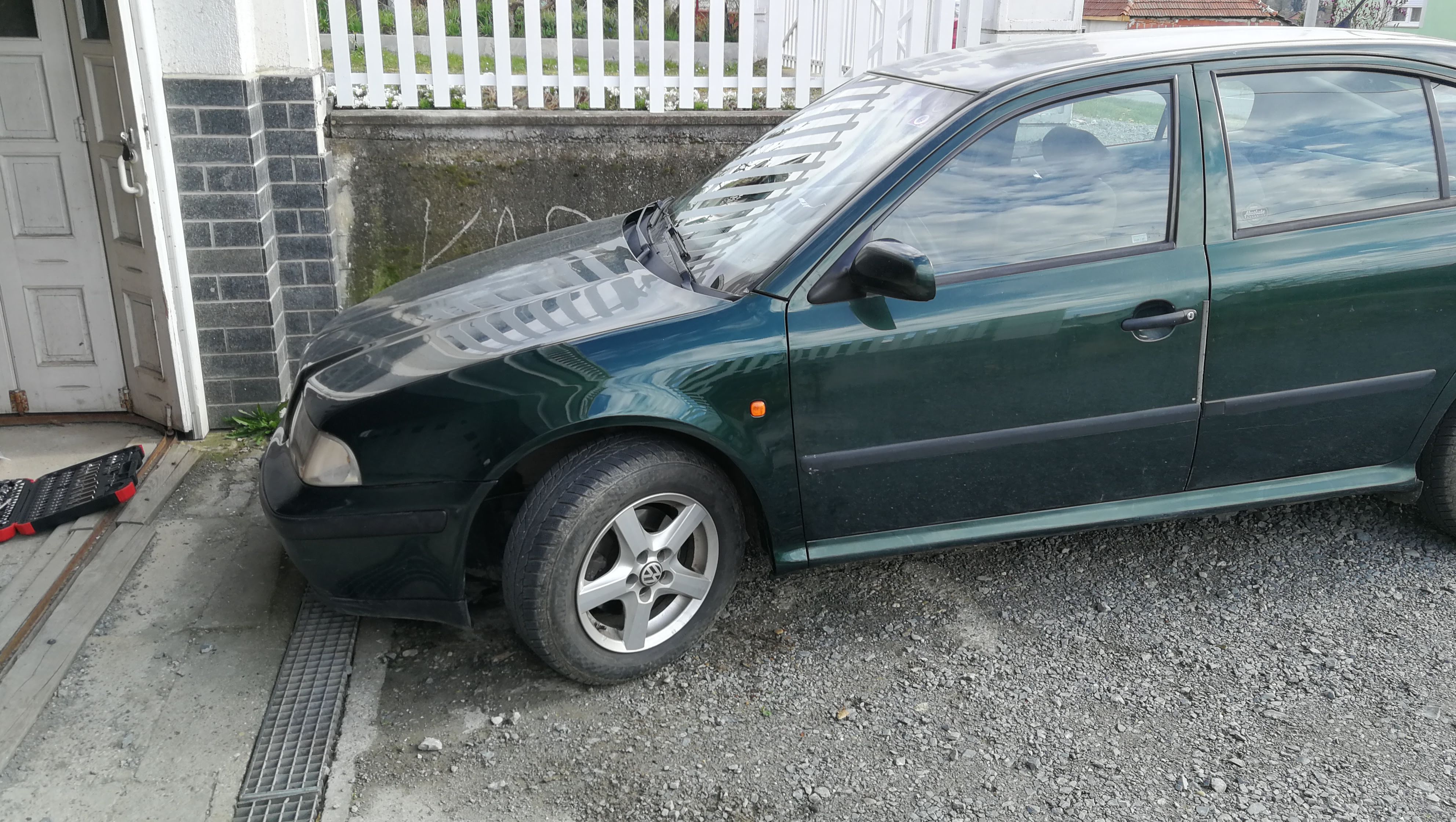

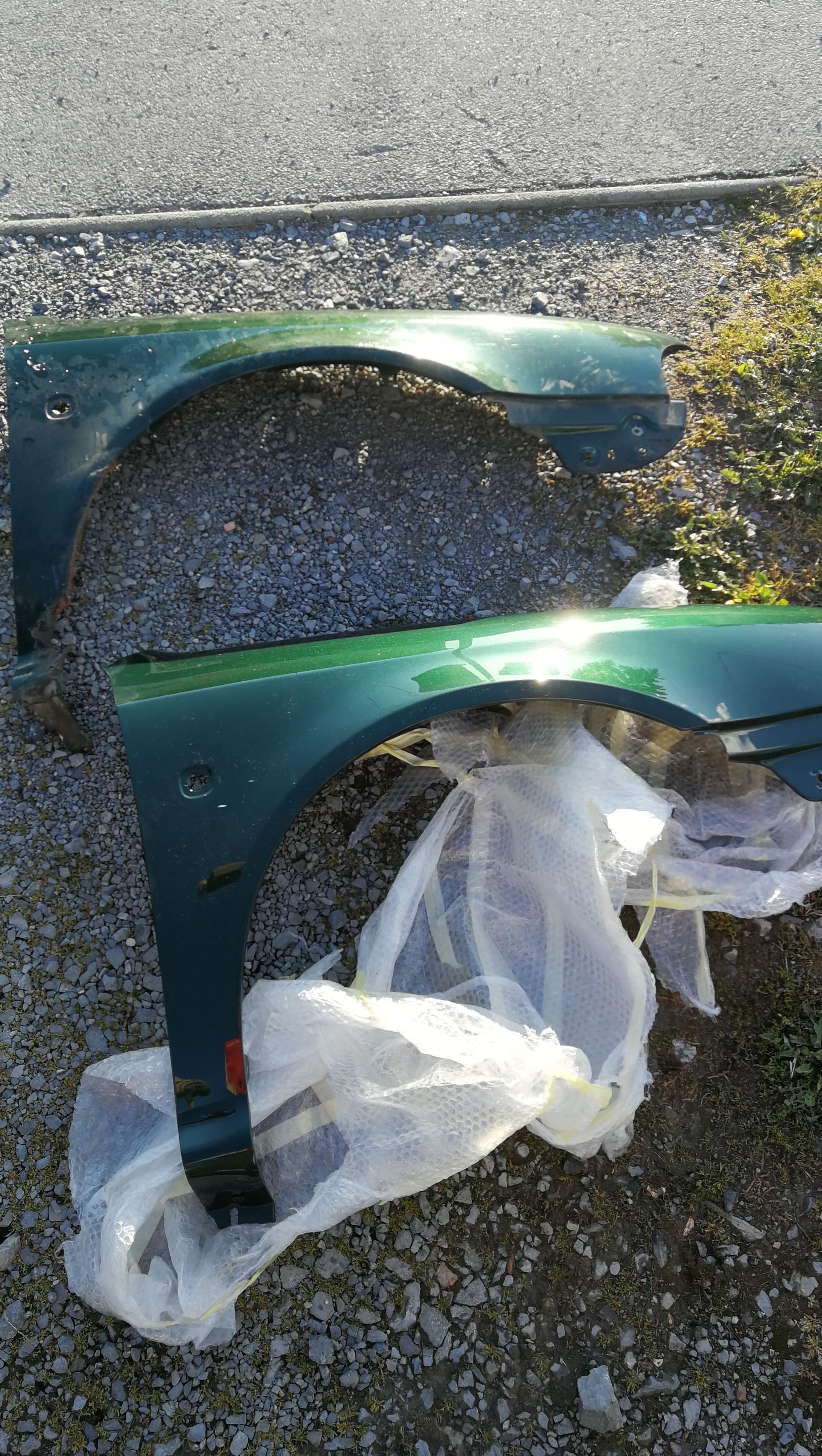

I had zero problems changing both wings/fenders on my father in laws "Jaguar", 2000. pre-facelift, 1.9 TDI remapped to 122 hp going 360kkm strong, was fearing rust and broken bolts.

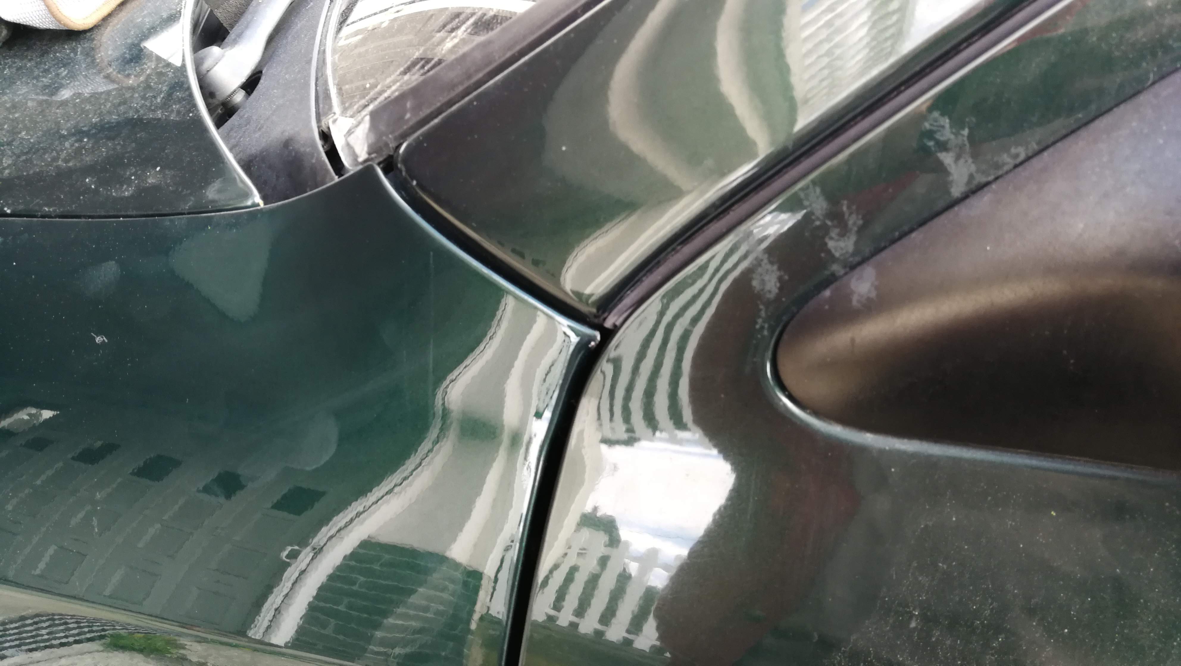

Had color mixed to base code 9570 - turned out perfect, exactly the same as original.
Here is the left hand side.
Here is the right hand side.
