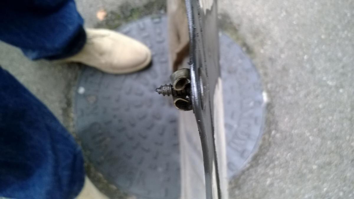

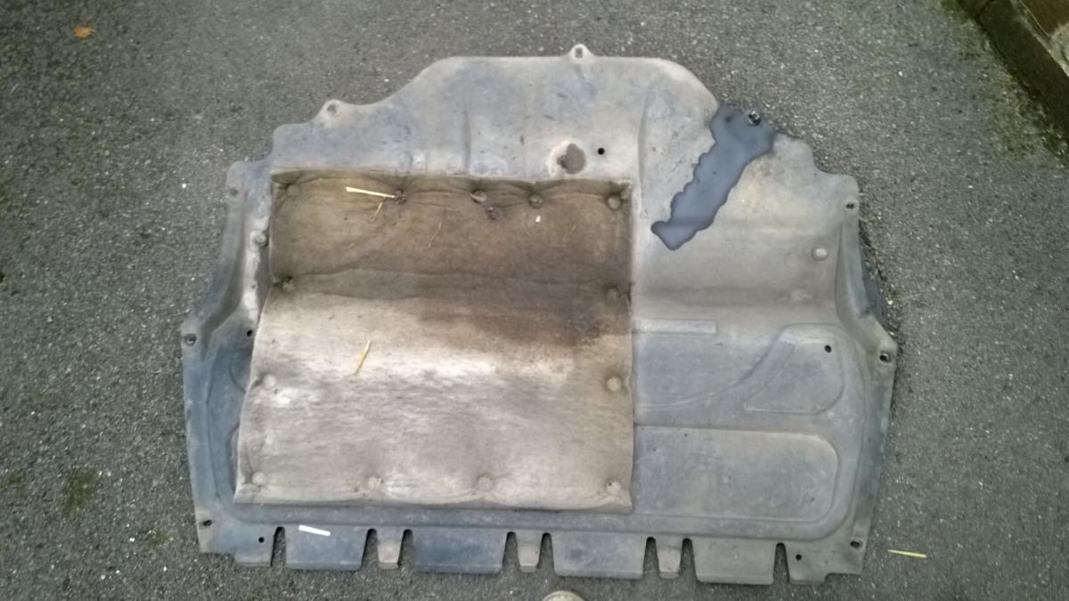

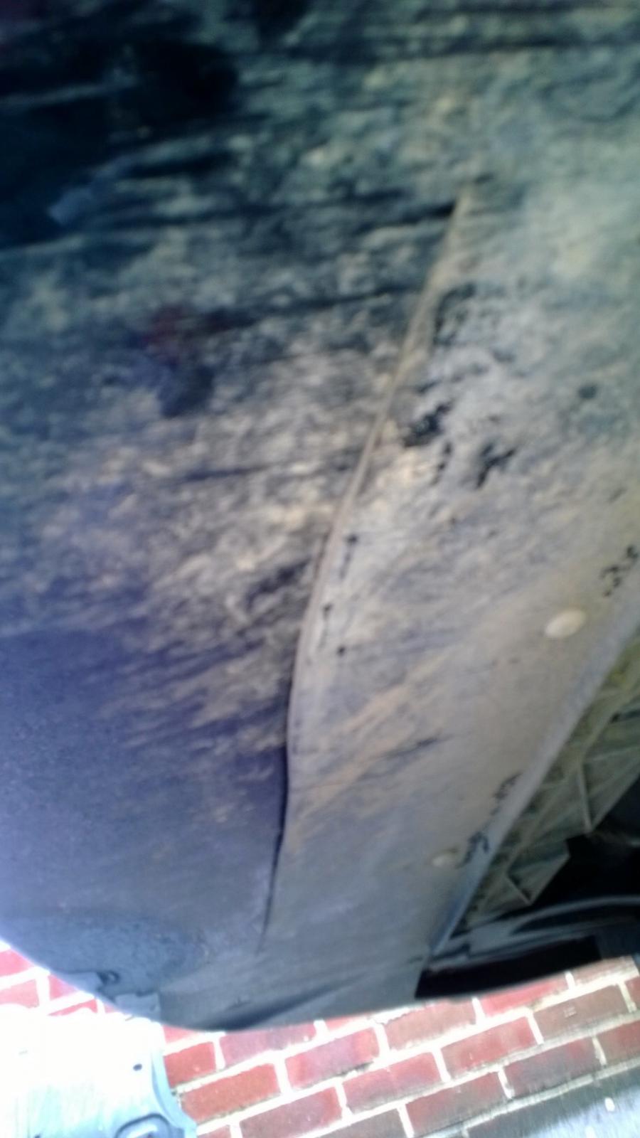

Ok, so this follows on from my post of six months ago, where a cat decided to try and end the Monte.

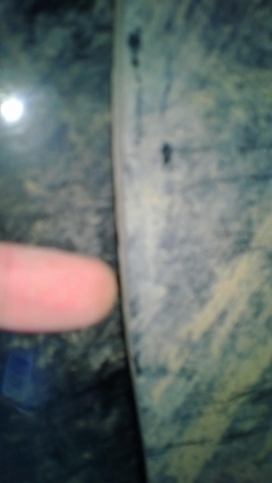

The pics below show the under tray, detached. It runs from the chin spoiler (seen in the two pics of a split piece of plastic and my fuzzy finger showing the crack - 18 inches across side to side) and is attached with hex head screws through clips inserted in the holes in the hard points.
The tray is shown off the car, nice piece of cladding, also 16 months of dust and grime (that's the inside).

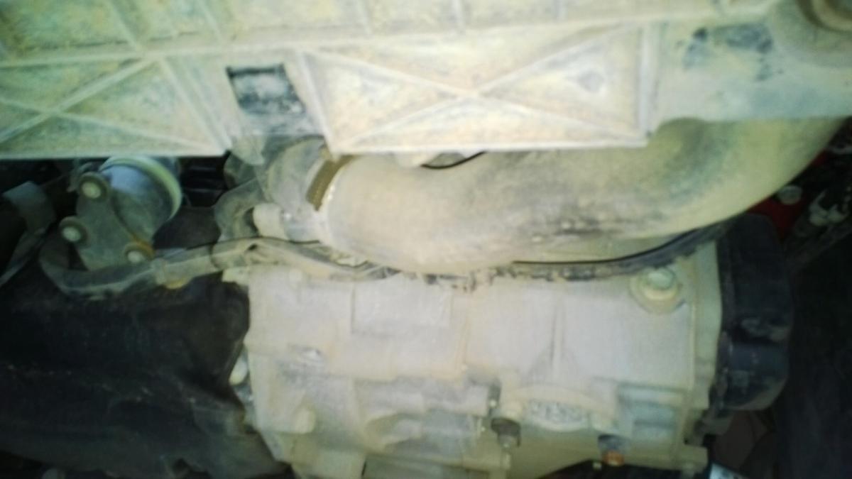

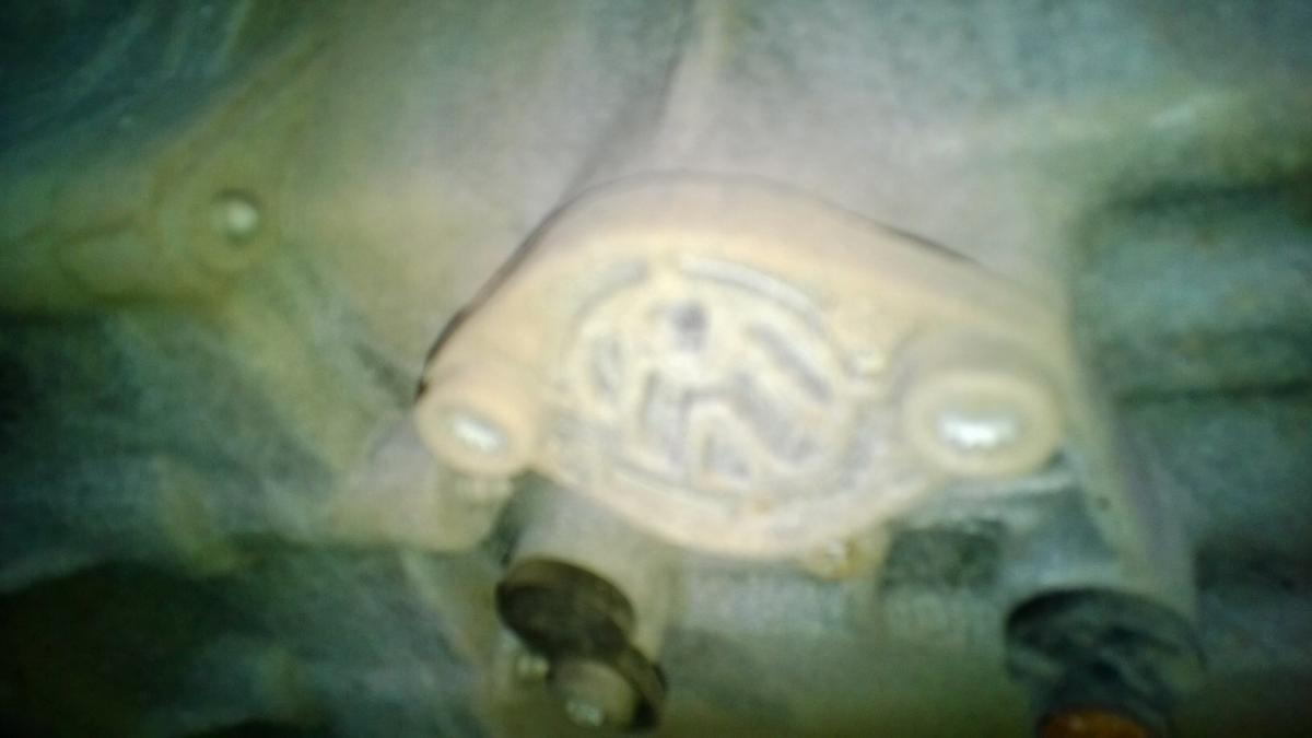

I've shown two pics of the underside of the engine, as you don't see this otherwise - proof of VW genes is clear!
The clip had twisted out if the body and the screw was seized. I suspect this is as a result of the undertray and mounts flexing, thanks to the cat impacted, split plastic Chin spoiler and splitter.
I applied a shed load of WD40 (other sprays are probably available...), brute force and some pliers. I then hammered (literally) the clip back into it's mounting hole and reattached the tray.

PDIBK - thats the engine undertray as fitted to all diesels. This thread is about the two full length under body panels which go from just behind the engine bulkhead line to just in front of the rear suspension.
