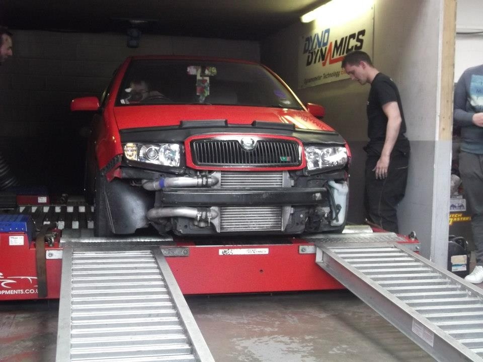

A few pics
You can just see where the towing eye should screw in here. The pipe is in the way.
Top pipe
Top pipe now clearing headlight backing cover nicely
The kit Forge supply with their Seat Sport style FMIC - Don't forget you need to run the OEM plastic top boost pipe (or aftertermarket stainless steel pipe) ASWELL! A bit of a jigsaw isn't it!
Fitted to a Seat
