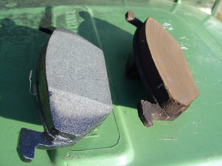

Decided to fit new Pagid discs and pads. Did it a couple of days ago and no more brake grab! I do appreciate that they won't be properly bedded in yet though.
One thing I did immediately notice is that the new pads have chamfered edges whereas the old ones (not fitted by me) don't. I reckon that should probably help reduce grab.
