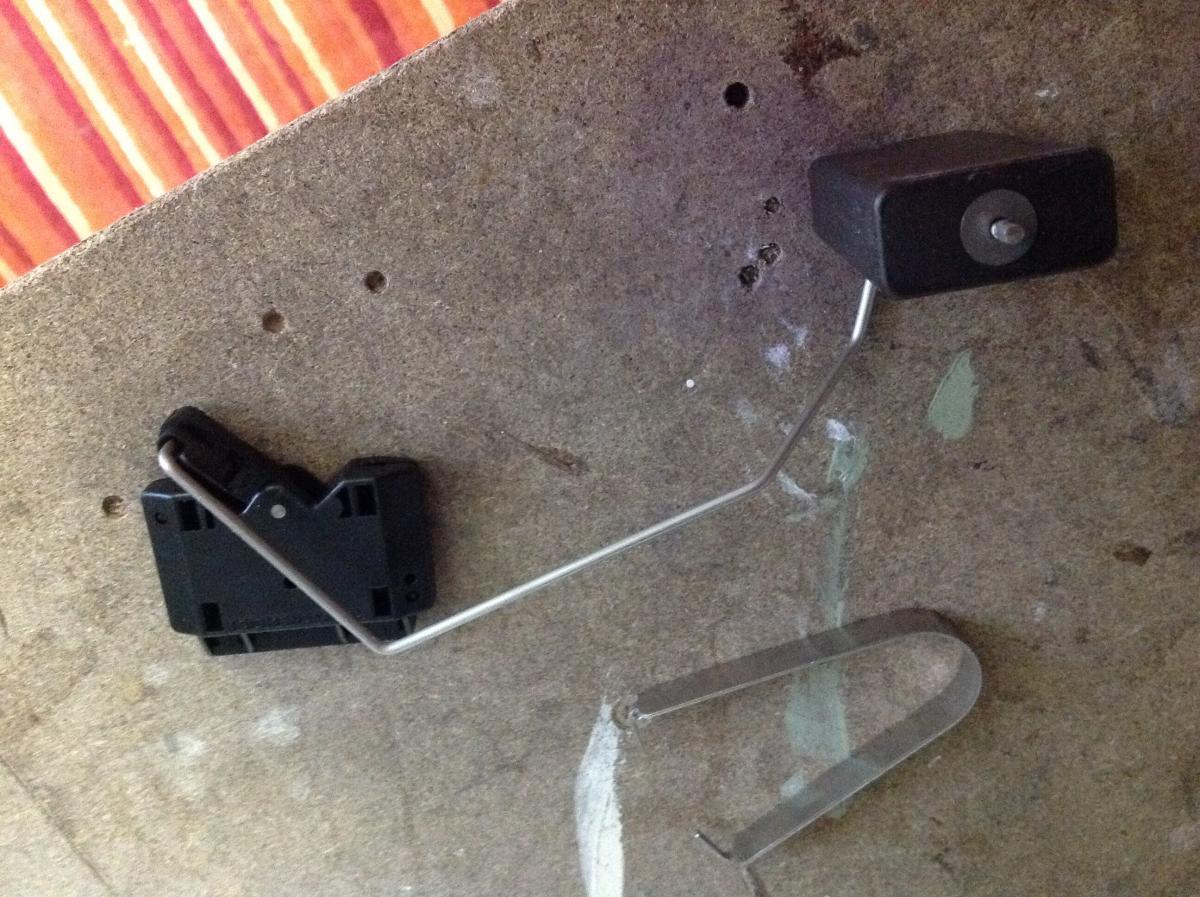

do you have a photo of the tank sender ?

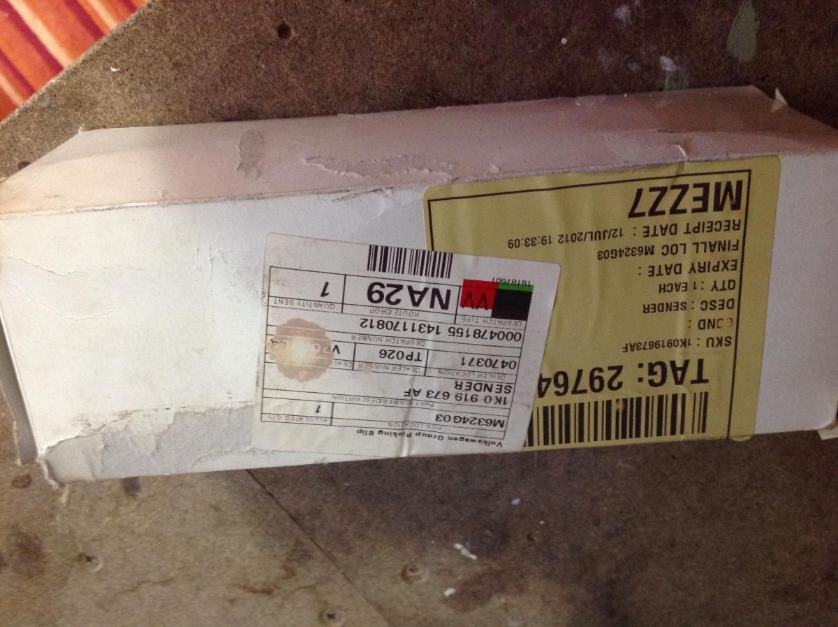

I think the sender unit was originally faulty but in all their efforts on removing/refitting the plug tg small connections became lose and resulting in faulty readings. I have enclosed picture of sender unit. I would check the plug on top of the pump first. Be careful removing, small tab has to be released to remove plug. Worth a fiddle before entering any deeper. Hope this helps.post-75867-0-83999100-1379867565_thumb.jpgpost-75867-0-58383800-1379867633_thumb.jpgpost-75867-0-83999100-1379867565_thumb.jpg
I think the sender unit was originally faulty but in all their efforts on removing/refitting the plug tg small connections became lose and resulting in faulty readings. I have enclosed picture of sender unit. I would check the plug on top of the pump first. Be careful removing, small tab has to be released to remove plug. Worth a fiddle before entering any deeper. Hope this helps.attachicon.gifimage.jpgattachicon.gifimage.jpgattachicon.gifimage.jpg
I could only open the box photo but not the other one. Do you know how to access the fuel tank and the send unit ?. How much does it cost in the UK, am in Egypt :)
