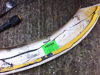

Removing plastic wheel trims on a Fun

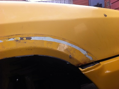

I love a challenge, so i thought that i would give it a go,
That is to remove a Fun plastic wheel trim WITHOUT breaking it.
Got out a set of guitar strings,
Levered away the plastic, enough for the guitar string to slide in
Started Sawing away as per info on this forum
Useless, Ya cant do it............end of story, ..........The adhesive holding the trim on is too hard and the sting wont cut through, I tried for over half an hour and broke two, and only got in an inch

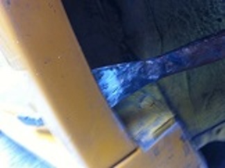

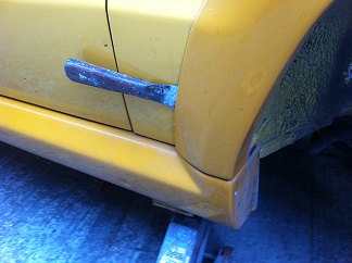

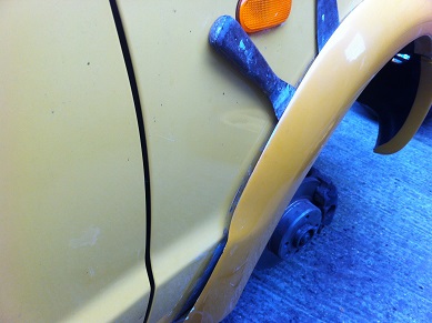

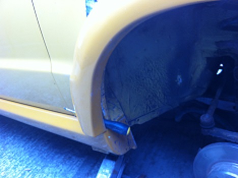

Plan B,

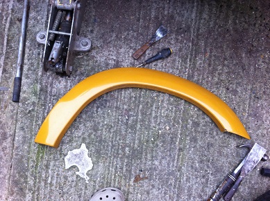

Using two old thin 2" paint scrapers, and a small hammer, i started on the inner rim, Knocking the scraper in to break through the glue, Took my time,....... then started on the outside, worked from both sides , and off she popped' took about an hour, but i did smoke ten fags and have two cups of tea, I did this so you dont have to............
summary, guitar strings?
I recon that the member who recommended using these had a guitar shoppost-103514-0-60513300-1379976933_thumb.jpgpost-103514-0-30165800-1379976939_thumb.jpgpost-103514-0-14158200-1379976947_thumb.jpgpost-103514-0-14953000-1379976953_thumb.jpgpost-103514-0-58122500-1379976959_thumb.jpgpost-103514-0-60156800-1379976971_thumb.jpgpost-103514-0-03281600-1379976977_thumb.jpgpost-103514-0-39501000-1379976985_thumb.jpgpost-103514-0-10185100-1379977000_thumb.jpg
Which string did you use? I seem to recall it had to be a roundwound (a bassier) string as the winding acted like a saw.
