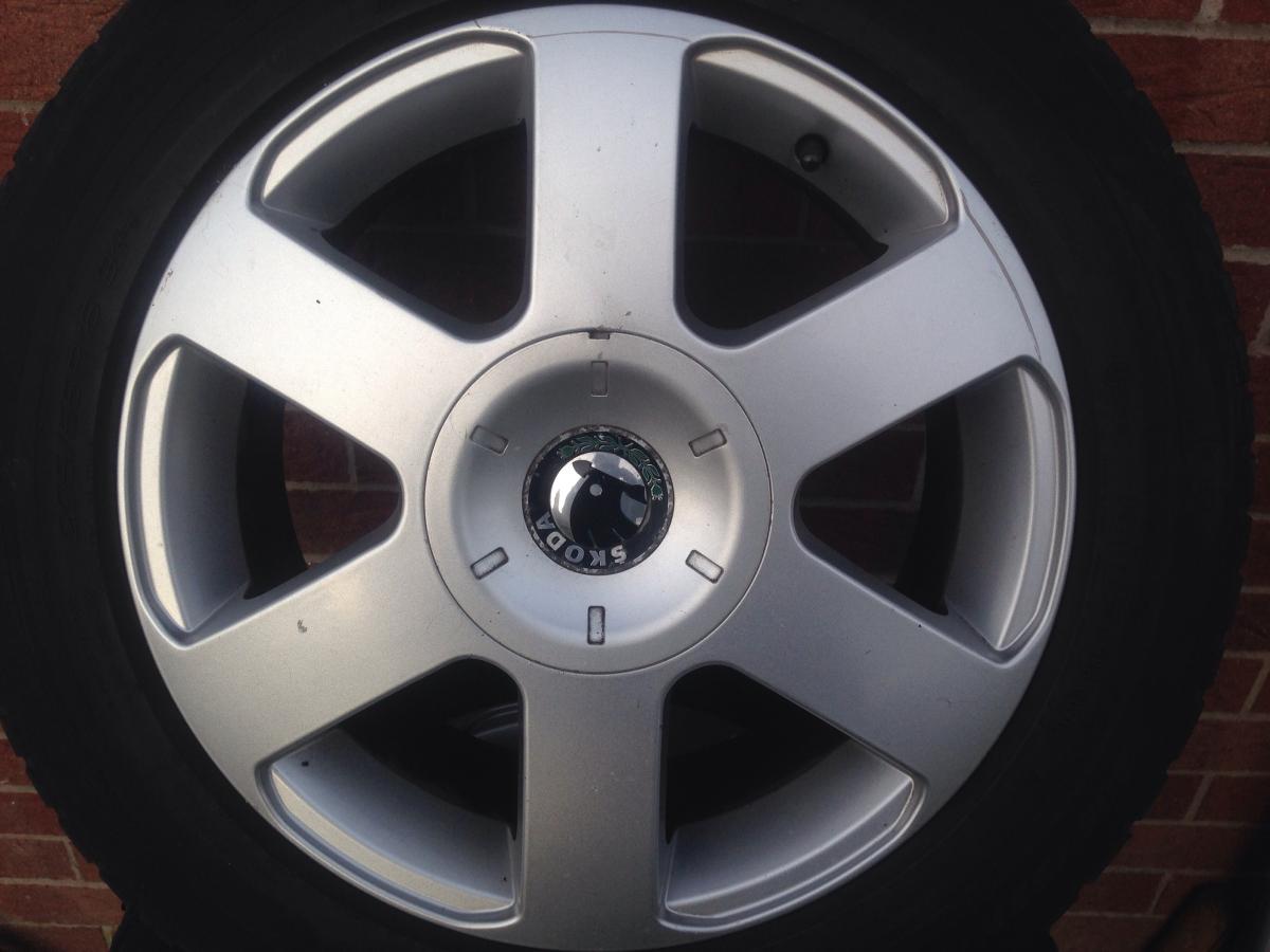

Hi all. Im looking to buy a set of winter alloys for my yeti. These wheels have came up for sale locally but the seller doesnt know the offset for them. To save me a wasted journey i was just wondering if anyone knew the specs of them. Ive been told they are off a 2005 Octy. They are 16 inch fitted with 205 55 16 michelin snow tyres, standard skoda winter tyre sizes.
Yes
Those are Vega alloys, off an elegance spec.

That have Octavia at the of my last post. Also the offset should be stamped into the back of the wheel.
Sent from my Nexus 4 using Tapatalk 4
Thanks for that. I told the seller the offset would be stamped ET on the back of the alloys but they maintain they can't find an ET number.
Just wondering if anyone knew the exact offset as I'm looking an ET close to the standard yeti 45. I don't want to make the trip to look at the wheels if the difference in offsets is ridiculous.
