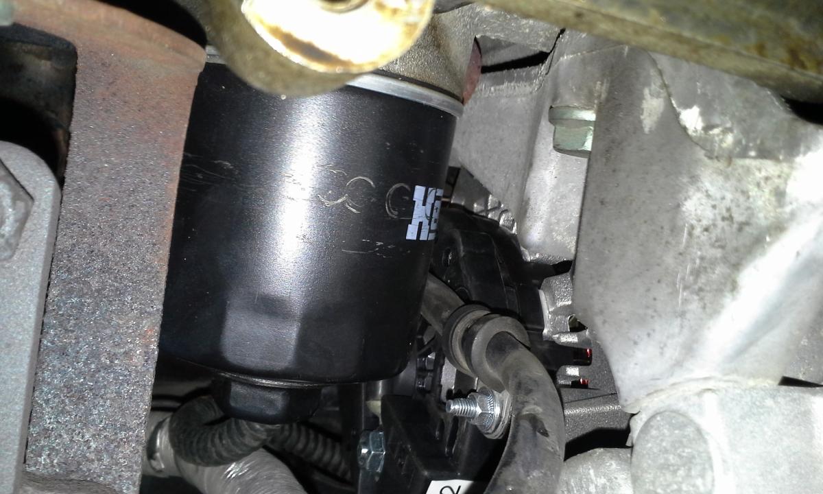

Now, today I went to our nearest DIY station, where I pumped up the car to take a look down under.
After a while, I found the filter. It's a sort of narrow place. Also, since engine is supposed to be hot when draining oil for the oil to slip out easy, it will supposedly be a nightmare getting the filter out without burning myself real bad in the surrounding area of the filter.
Does anyone here have actual experience on changing oil filter on a 16v Fabia Mk1? Ideas? Any special tools to have in handy? I guess those oil filter grippers that are sold won't be necessary, since Fabias store have their oil filter stored in a little black plastic container. Am I wrong?

no experience of them but it looks like you can get a socket on the end of the filter and use a ratchet and socket to undo it. The filter can be left to cool down further as the oil is contained within it. Don't forget to grease/ oil the new rubber seal. There's also a thing like a 'gatorgrip', an oil filter wrench you can buy/borrow/steal/use ;)
Loosen the filter housing using the appropriate wrench and lightly re-tighten by hand while cold then you can remove it easily and safely when warmed up, sounds obvious because it is.
