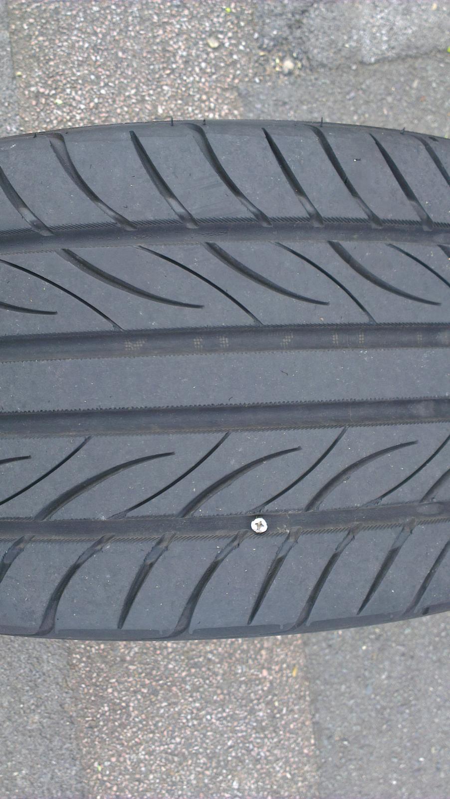

Can this be repaired?
I'd say yes, providing the screw hasn't damaged the side wall on the inside
Just take along to tyre repairers, they'll tell you on the spot if they can repair, and how much repair will be.
I'd say yes, too.  My local tyre place repaired a similar puncture I had in my old Schitroen.
Looks like it can be but I'm not an expert. Had a similar one repaired a year or so back.
yes that will repair.. what they do is take the tyre off the wheel, and cement in a rubber plug which pulls through from the inside, it's only when they are too close to the edge of the tread when they cant be repaired..
certain types of repair plugs can be inserted without even removing the wheel from the car, you just do them in situ, ive done it a few times at the road side when ive been desperate
All repaired! £15 is certainly a lot cheaper than the cost of a new 245/35/18 runflat!
Cheers all!
