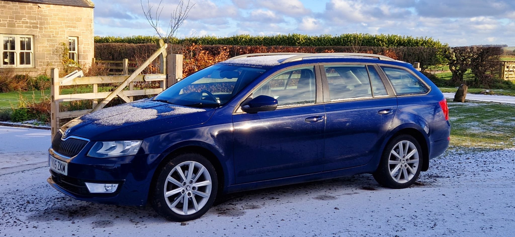

Life has been a bit up/down recently and our circumstances changed, so a replacement car was purchased for our previous 2020 Golf MK7.5. My husband Chris decided that he wanted another MK3 Octavia, so we hit the classifieds and eventually found what looked like a clean MK3 2015 Elegance TDI 2.0 4x4.
It's in Blue Pacific (quite a rare colour) and has covered 118000 miles (that's the TDI just worn in by my books). It's been given the name Blu.

Update on Project Blu.  My husband has been using it as his daily and loves it to bits.  Properly smitten.  Car has done just under 120,000 miles.
Things that needed attention:
1) The battery needed replacing.  A CCA test showed it had 50% capacity on its battery.  Got a new Varta 700Ah battery installed.  Car is now very happy again.  Curiously, it had a failing reversing sensor.  Since we replaced the battery, the reversing sensors have played nicely.  Win-Win.
2) Tyres.  The tyres on that car were trash.  Terrible things.  Replaced them with a set of Goodyear All Seasons Vector 3.  Brilliant.  Recent Snow/Cold has paid those off instantly.  Happy times.
3) The car had a full service.  Oil/Filter/cabin air filter/fuel filter.  Running Quantum VAG 507 spec 5W/30 oil.  Got a full service kit for £108. Fantastic.  Run some cleaner through the engine prior to oil change that has got rid of the gunk.
4) The humitity sensor had failed.  Common fault.  Got a replacement sensor from AutoDoc for £82.  Both heated screen and air con now working correctly.
5) Its just been to Autohaus in Edinburgh for replacement front springs, droplinks and new polybush top mounts.  Big chunk of spring fell away when we were doing a pre-MOT inspection in December (gulp).
Other than that, husband has been busily polishing the bonnet.  Previous owner did a poor respray to touch up stonechips, resulting in terrible orange peel.  Its a work in progress, but bonnet is looking fantastic.
Car will never be perfect (its done 120,000 miles previously in rural yorkshire), but its a very good car.
Bonus: Its just past its MOT with flying colours.
