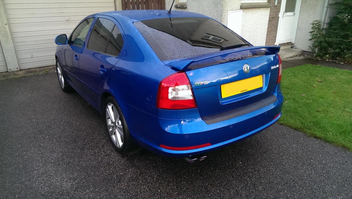

Well I followed Sparkly's advice and added the QD after the wax. I have to admit, it has bought a bit more zing to the finish. My AG QD is nearly out so I will try the Sonax next time.
Paul
Did it rain afterwards?
How come the car is wet?
No, luckily it didnt rain at the time or after. That was taken yesterday evening after it had rained having done the job Sunday.
