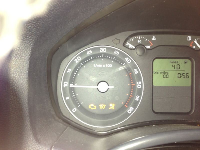

Car showing glowplug and engine management light on dashboard :(
Anyone had this problem or any help greatly appreciated.
