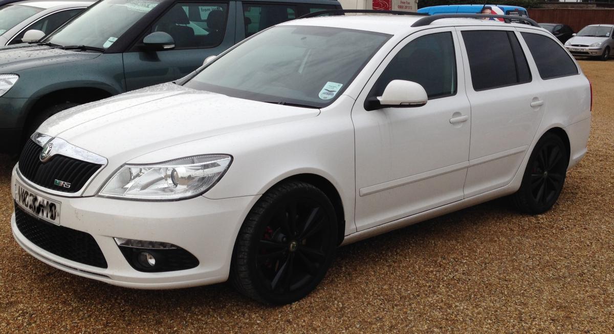

Just picked up my Octavia Blackline Est in white with DSG and now its time to ask a question.

Identical to mine, cracking car. Had the bluetooth done on mine too, well worth it for the audio streaming alone.
Quick observation, no Blackline came with sunset glass so whoever had it before has had that done 3rd party.
Edited by pipsyp
Gave me the heeby jeebies there pipyp .
Had to check the log book for confirmation it says Blackline  :happy:
Wife is out and about in it at the moment , but i didnt give the rear windows a second thought.
When shes back will check closer and hopefully there dark glass and not cheap arse tinting.

Just to confirm Blacklines were all factory built to a set spec, some with a spare wheel and some without but nothing you could choose from the options list.
Sunset glass was therefore not an option on these cars so it'll almost certainly have non OEM tints, to be fair a number of people werent chuffed that they did not come with Sunset so had theirs tinted.

Pipsysp - what's wrong with aftermarket tints? Done properly you'd have a job telling them apart.
nought if theyve been done well; was just making a point to the OP that his Blackline doesnt have sunset glass as none of them came with that.
Also on close inspection you can tell, even the best 3rd party tints are still film, glass from factory is smoked. Tinting film doesnt take that well to heater elements as they are often teflon coated (in the rear glass) so thats usually a sign.
