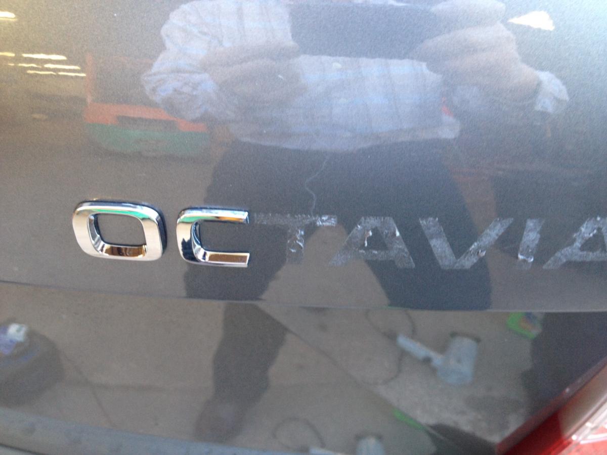

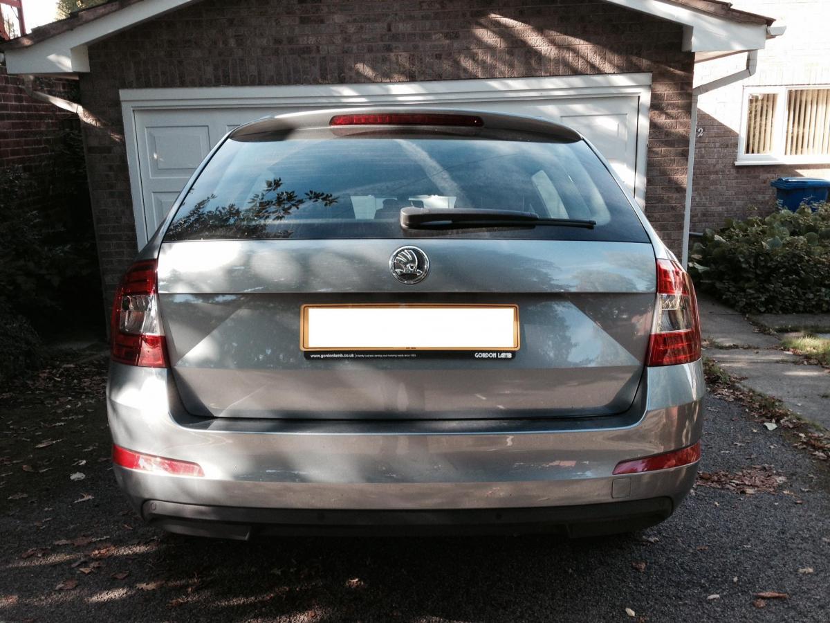

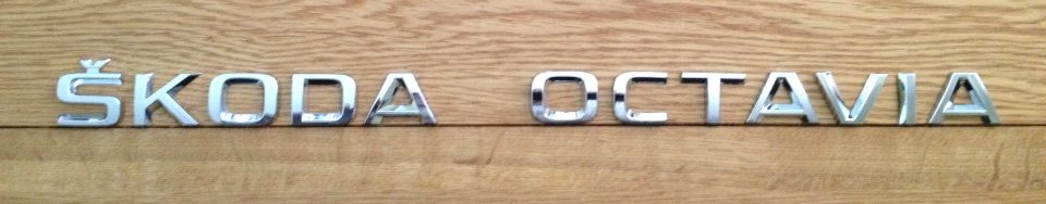

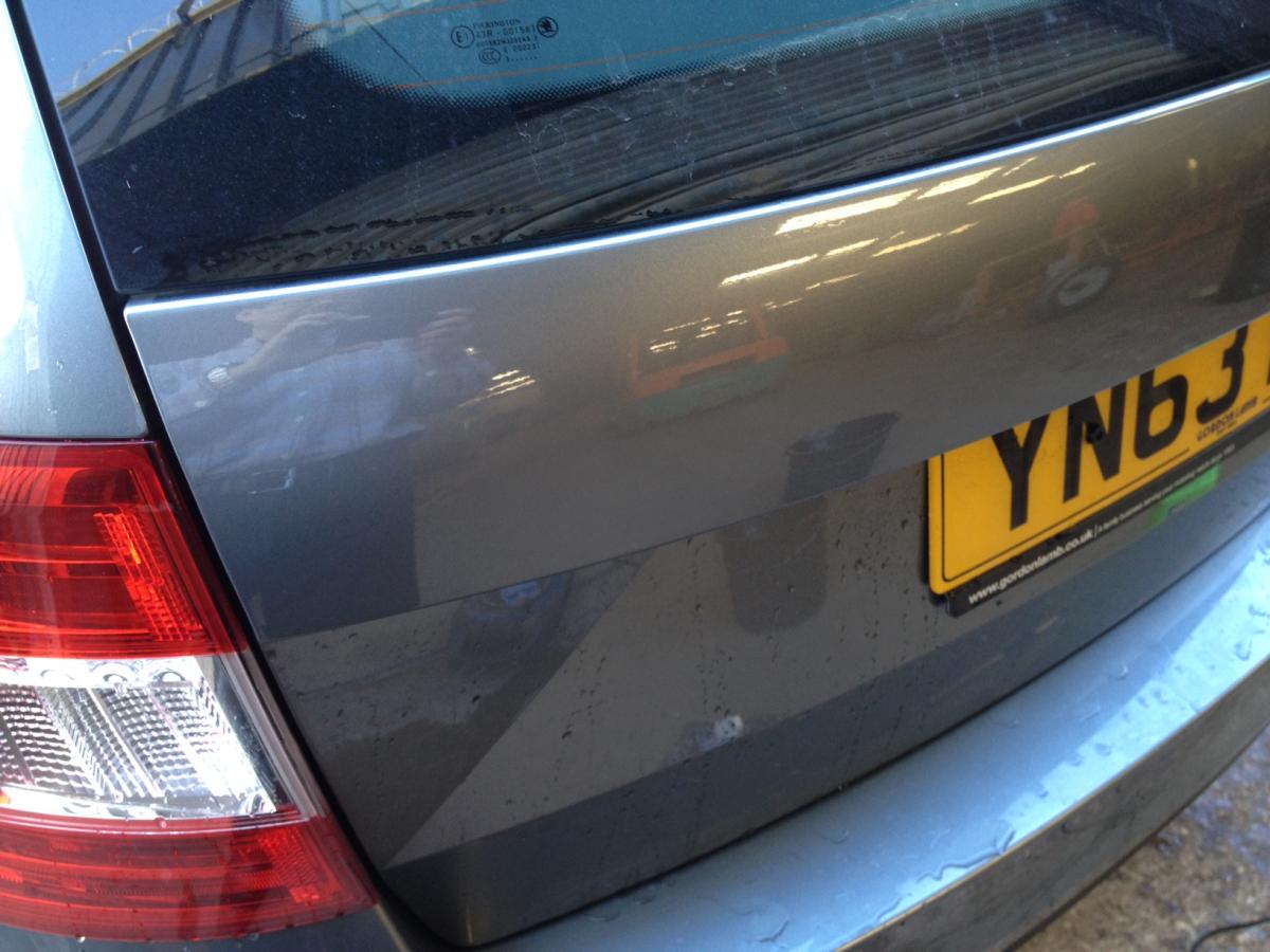

A couple of photos as promised.
Edited by ssfan
By the way, I used a normal hair dryer and did one letter at a time (about 10 seconds each). No damage to paint. I would be a lot more careful with a proper heat gun!As you saw away at the backing, try to keep the dental floss away from the paint to stop the softened glue smudging on the paintwork. Not that it really matters that much because it is easily wiped off by white spirit anyway.
Oh, it looks so much nice de-badged
Indeed it does, so off they go.
