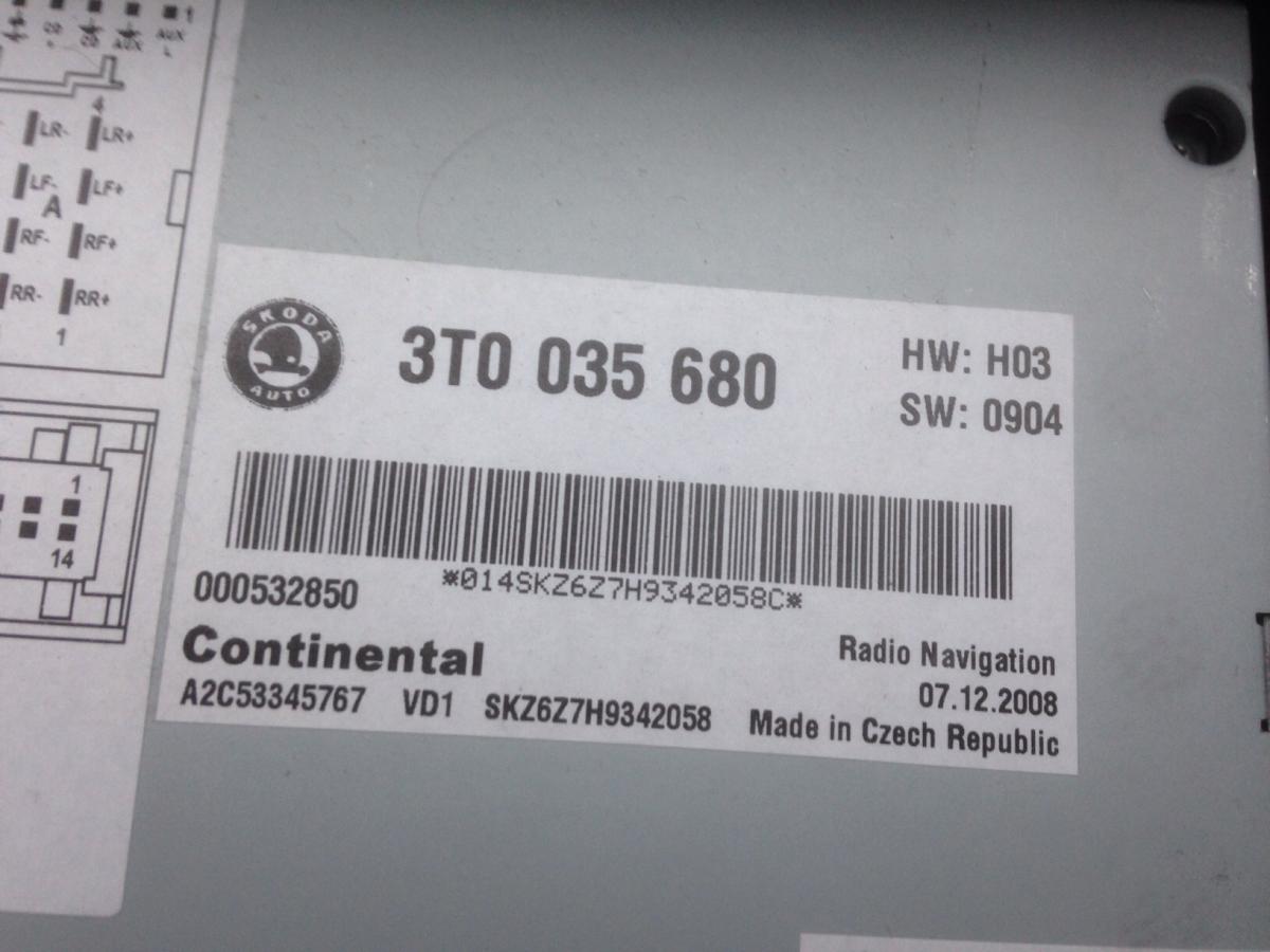

The big number is 3TO 035 680
With HW:H03 and SW:0904
Date 07.12.2008
Please see the attached
Yes I reckon you could go to 4020 but you will lose maps and music on install, as the HDD is re-partitioned. These will then need to be reloaded. Do you have a recent map disc?

If the Columbus was factory fitted to a 2010 Superb then it will probably be 3T0...A.
You should be able to confirm this from the menu by looking for a hardware code.
In which case, an unmodified 4020 firmware from 'My GTI' will work but will wipe your maps. As you have a map disk that's not a problem.
You can confirm the version with a 4-digit code after 'SW version'.
What version is the map disk? If it's a genuine Skoda / VW disk it will say on it.

OK we have:
Part Number: 3TO 035 680 A
HW: H55
SW: 2844

Figment: you should be able to go to unmodified 4024 from the mygti site, subject to finding updated maps
Adam
HW: H55
SW: 2844
As adamal says; unmodified 4020 from My GTi.
