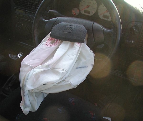

The cover isn't a seperate component.
Think about how the airbag works, the cover splits apart as the airbag deploys. If it was a seperate part it would just come off and inbed itself in your face.
looking at how thick the plastic is, i recon it does just that... if it split, it would be two sharp lumps of hard plastic giving you a scotch kiss! i think the airbag blows up and shunts the cover off. the passenger side just rips and flips the dash to one side,
