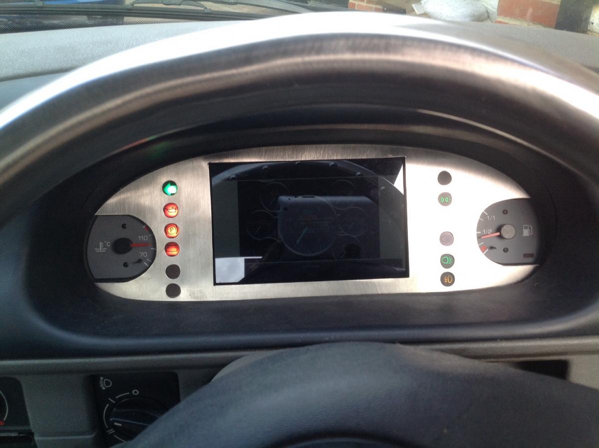

I have been to the breakers and got a downer set of clocks to play with
So after grafting the tablet in to the clocks I now have the lights on the dash lights to move around and a cover plate to tie it all back in

Well so far so good I have a load of cables to get,
Obd2
Female usb cables
Some way of jacking a power source, posably the cigarette lighter, but behind the dash
I'm hopping in get a mouse working with it all to help with the interfacing, thus allowing me to replace the clear plastic of the clocks
And somehow I need to work out how to change the wake up settings on the nexus

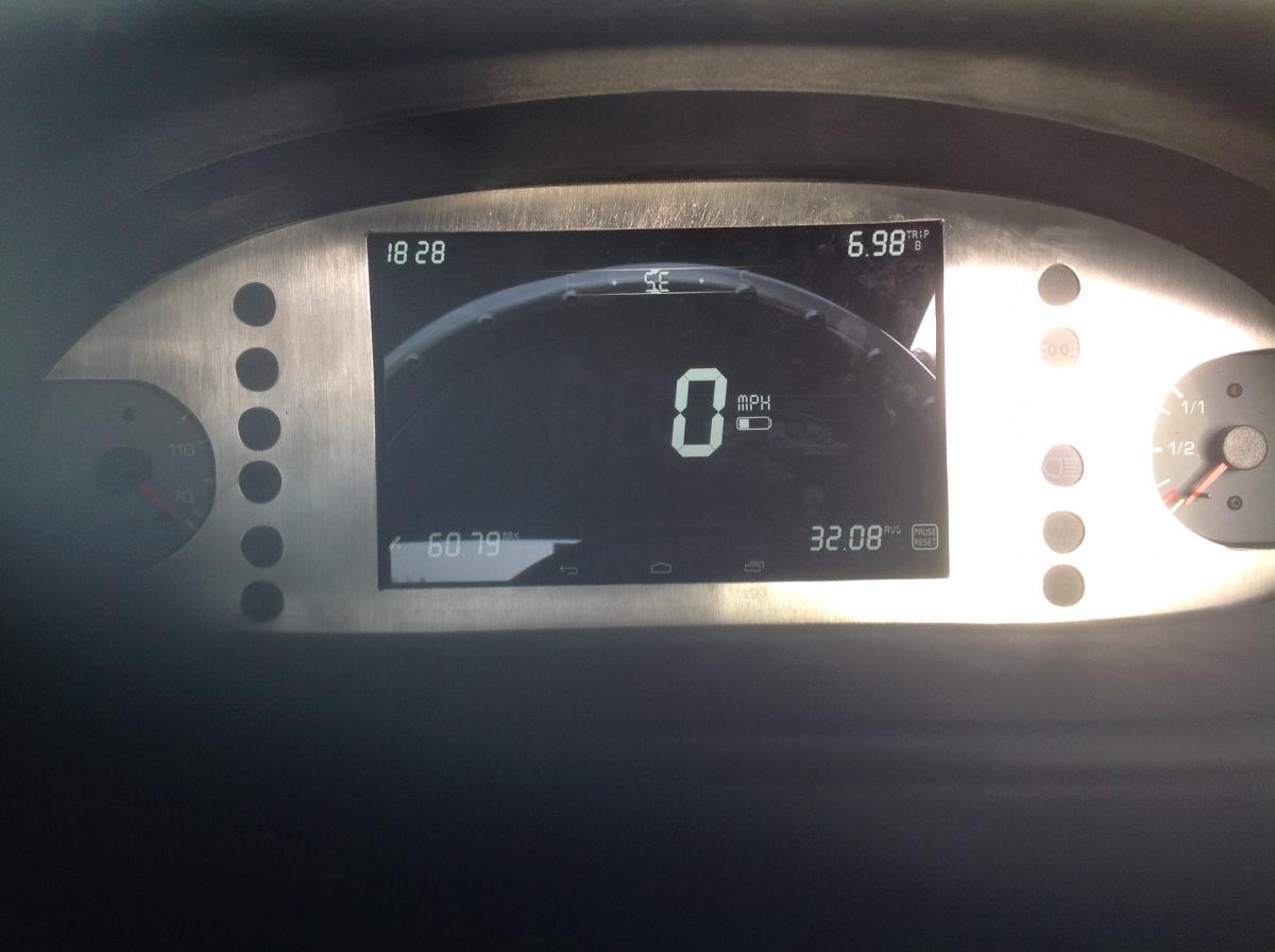

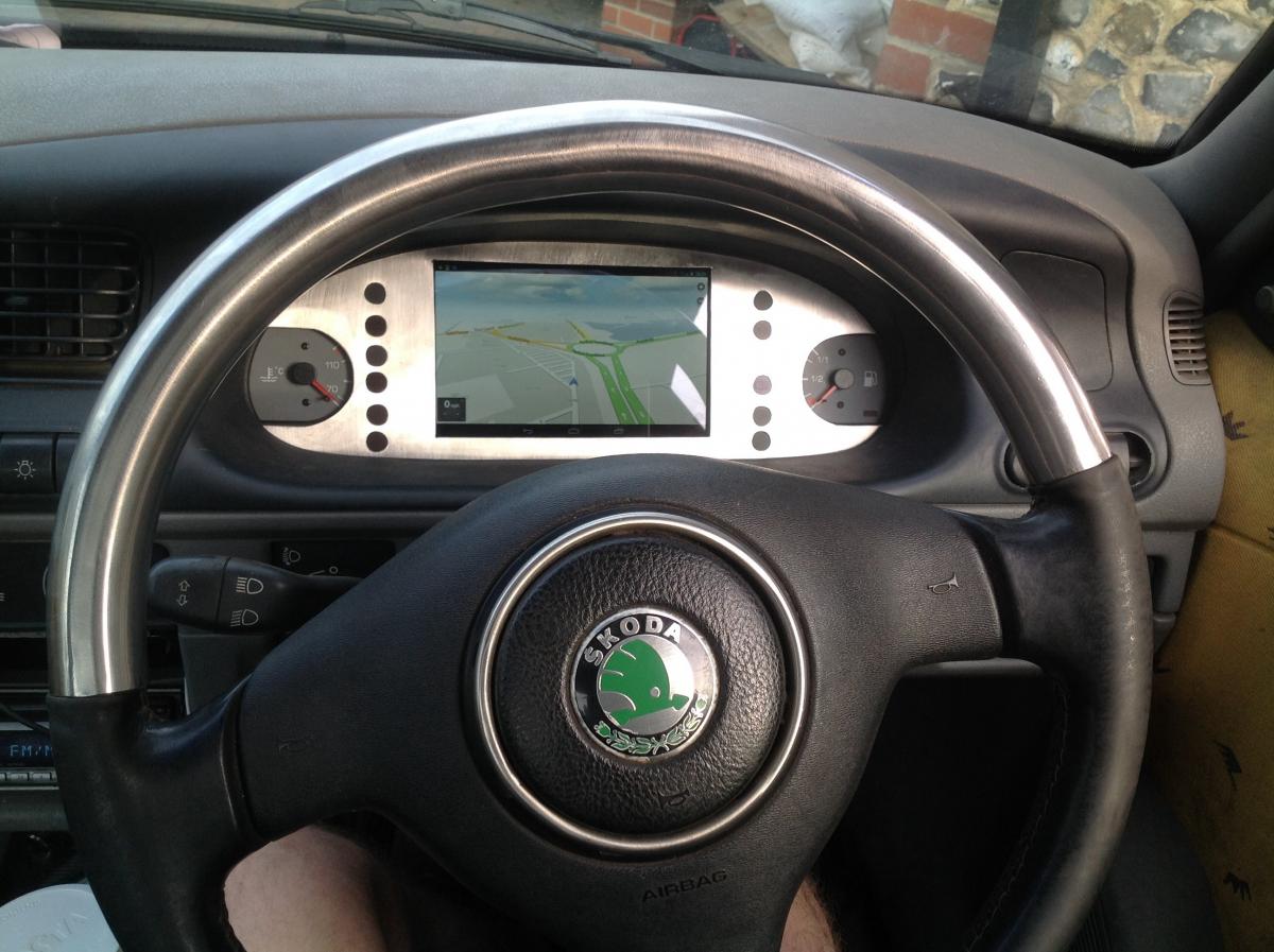

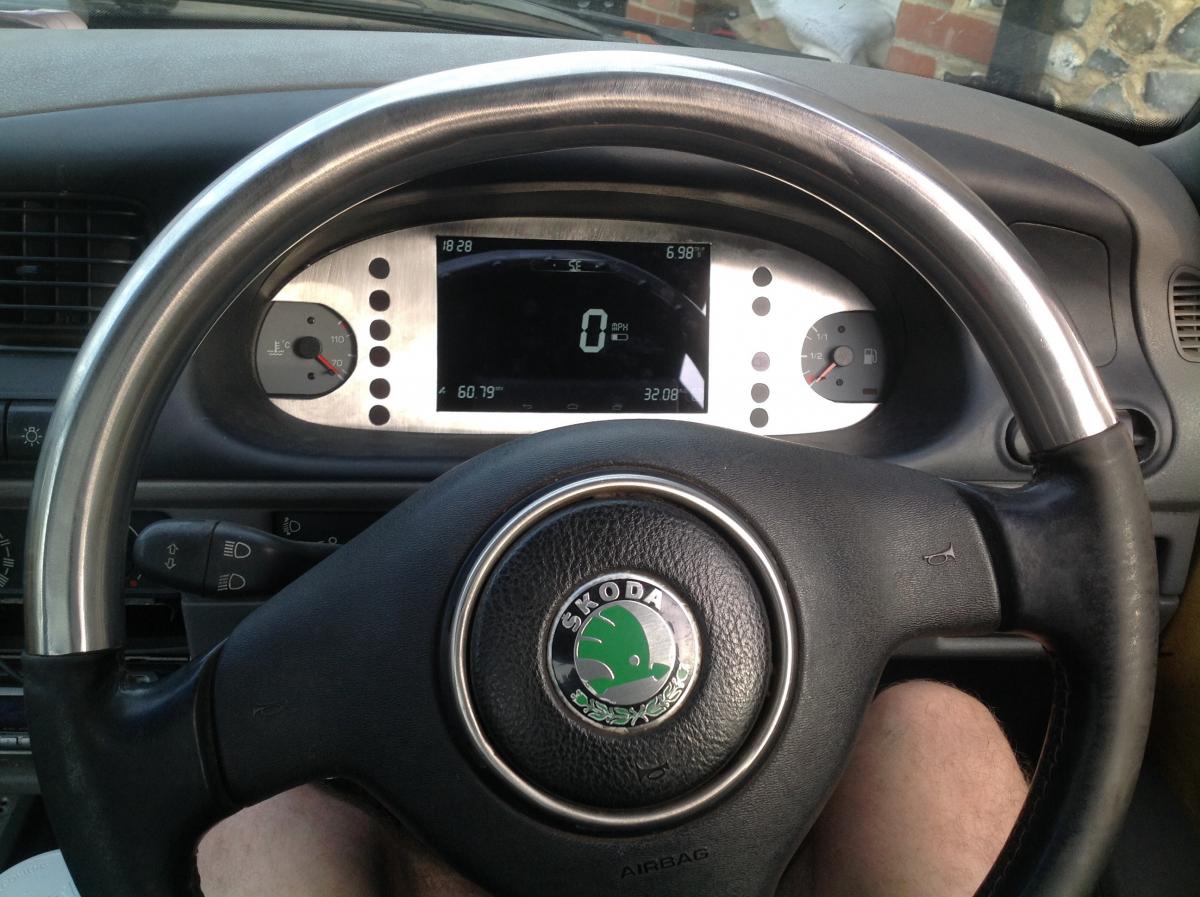

Ok after a lot of nuisance this is now all working a treat
More pics of some of the apps
Awesome...that is all!!
Thank you. Had been fun and games to get it all to work but so far so good

So do you have to reach through/around the steering wheel to operate sat nav or change screen function?
At the moment yes but as soon as it's posable the answer to that one will be no.
U don't need to touch it at all for the speedometer to fire up, it's set to do that on receiving power regardless of any app that may be running. It's also set to kill apps apon losing power so that it will go to sleep. Again no need for any input other than the power it receives to be removed.
So the moment u start the car the system overrides what u are doing and starts the speedometer, and vice versa for when u turn the ignition off.
I'm waiting for a friend to cut some plastic so no u won't be able to interface through the steering wheel. Rendering no touch screen within the drivers reach
At the moment it has a speed lock that activates over 2mph so no playing while on the move is posable.
I am going fit a usb port (mayby in the door shut) and the only way will be with a mouse, or touch pad/ or maybe a roll up key board, that will require plugging in but is not easy to perform while on the move, Or something along those lines,
And I need to sort a secure folder for the critical apps so that these setting can't be changed easily.
